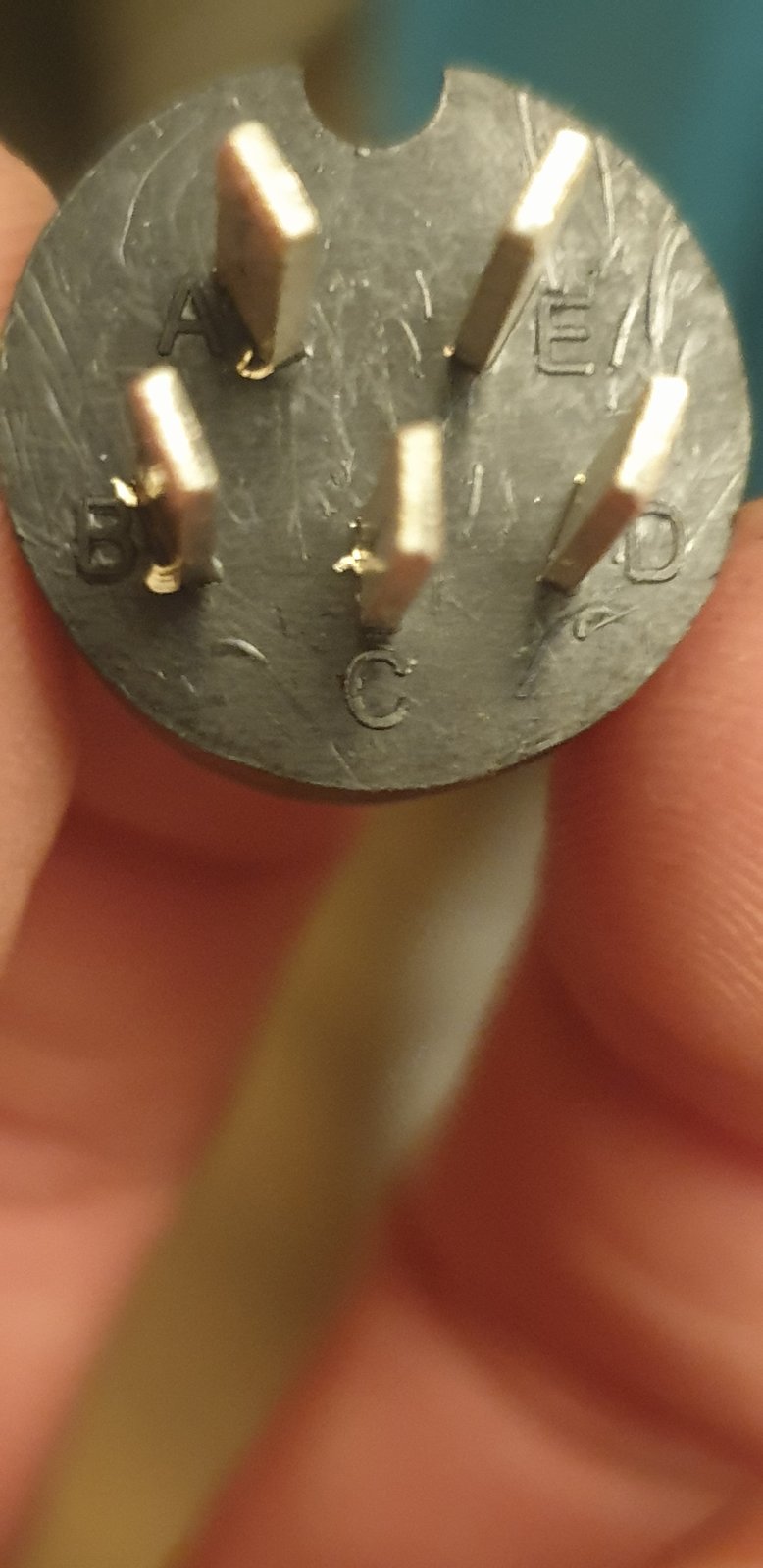

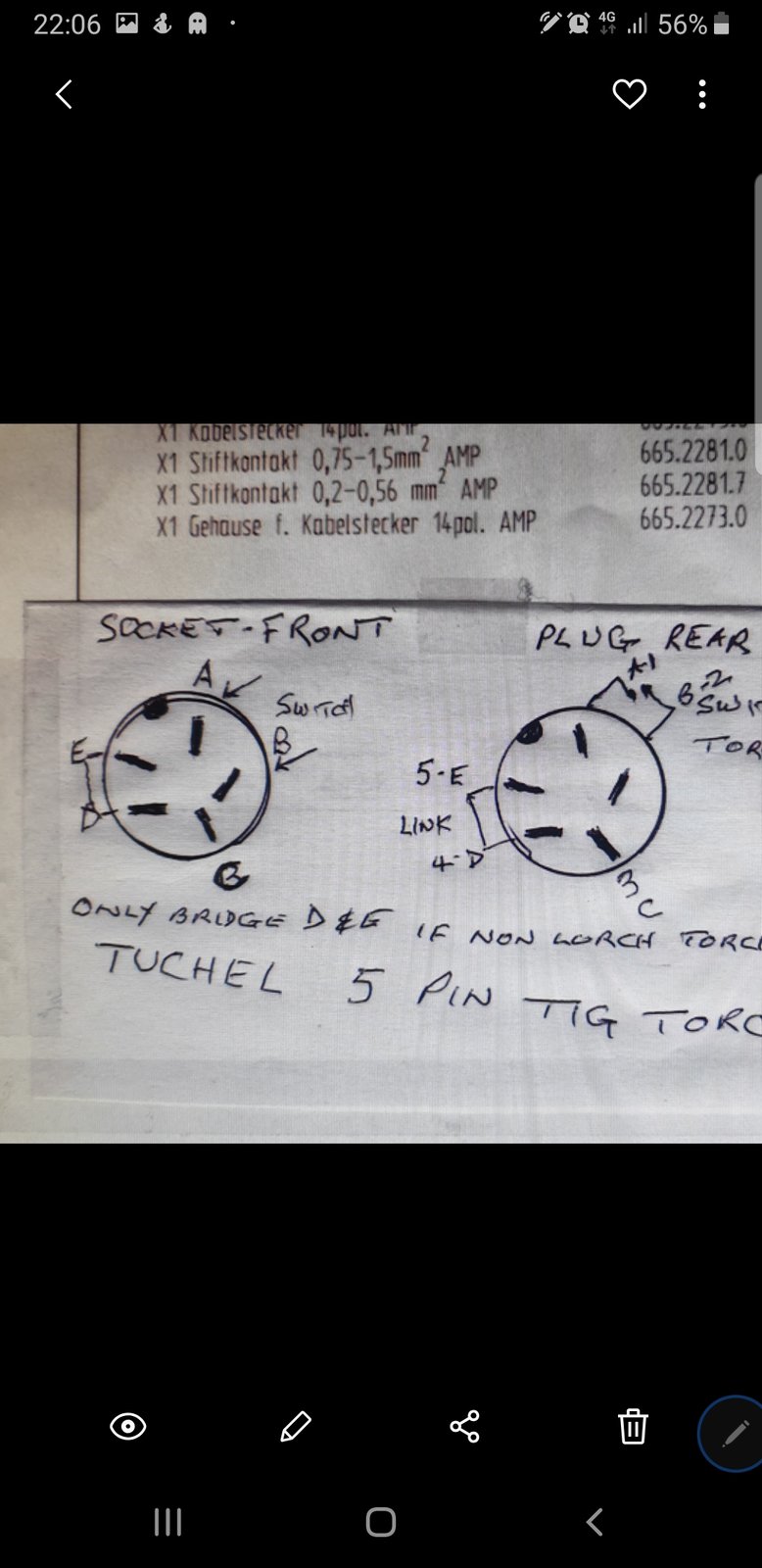

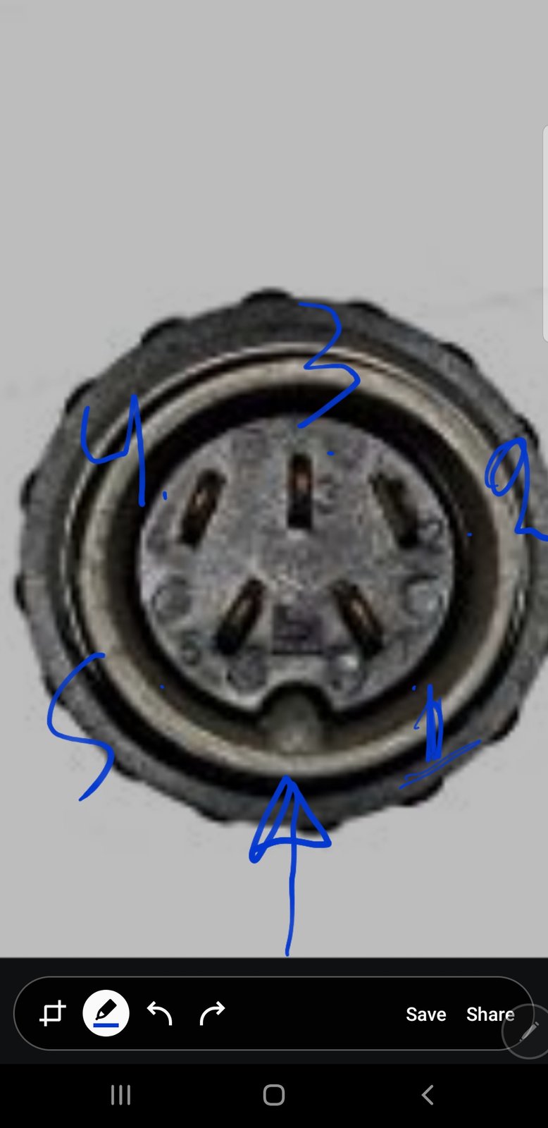

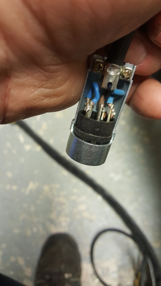

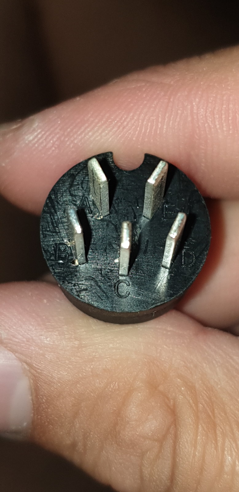

Hello guys.
I tried today my 180 ac/dc handy tig with an AES pedal the machine seems to recognise (the remote icon gets on the moment you press the pedal as writen on the opperator's manual).
It creates arc but after like 8 seconds it cuts and pops a E05-00 error
The torch has no switch connection on the front of the machine at all. Its a CK9.
I red somewere that you must bridge 2 pins on the ampnenol tuchel on the front even if you dont use torch switch?
Its the first time i opperate this machine.
I also have 2 wire switch for the torch i could try. Is there a diagran on were to connect this 2 wires on the from 5pin tchel?
Im kinda confused.
