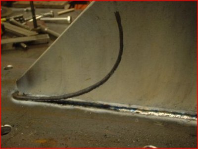

Know pro guys will be used to peelers, but as a hobbyist ya cant beat it
Just something about that beautiful peel up

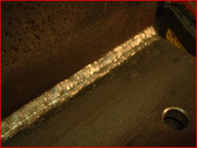

You boys are easily pleased!, you will usually only get the slag to peel with E6013 electrodes aka rutiles, you'll find other electrodes will have loose slag but rarely peel, all it means is that the current, travel speed and arc length are about right,
This is a 3 pass fillet weld the peeling slag is on the second capping run, that's why it appears to be off centre to the joint, other pic is the completed weld after a rub with a wire brush.
