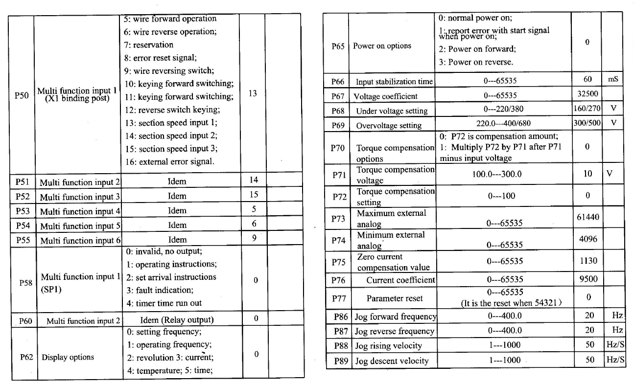

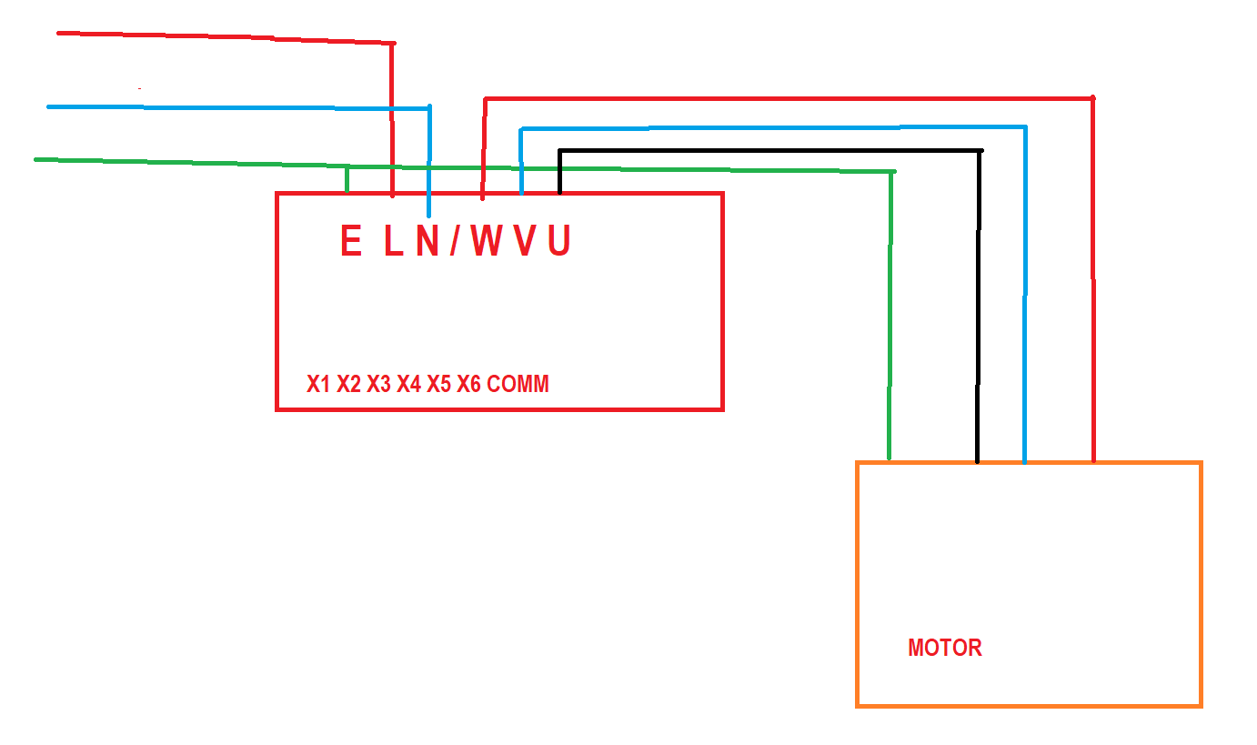

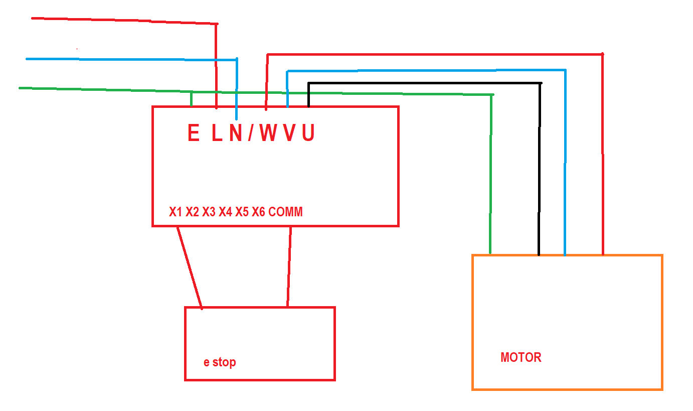

As has been said, you need to wire the e-stop so it switches between the com terminal, and one of the X terminals.

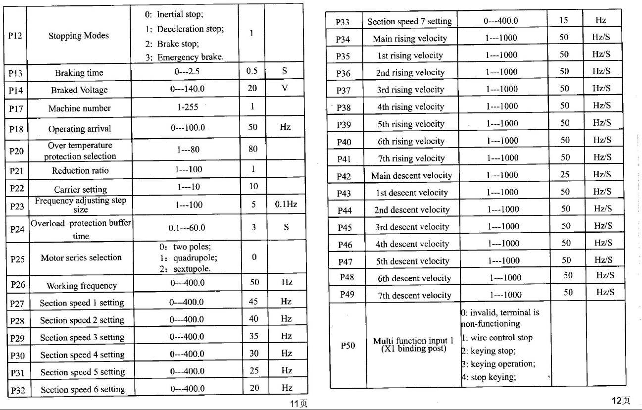

You then need to set the parameter for the relevant X input (P50-55, which correspond to X1 to 6).
From the manual I've found, I think you want option 1 for an e-stop button, but possibly 2 or 4. You may need to experiment, and there is the possibility that it may only work with a NO switch, not an NC setup like you would normally implement with an e-stop.
The biggest issue with that VFD, is it doesn't allow for an external braking resistor to be fitted, so it's limited in how quickly it can stop the motor, without faulting out.
