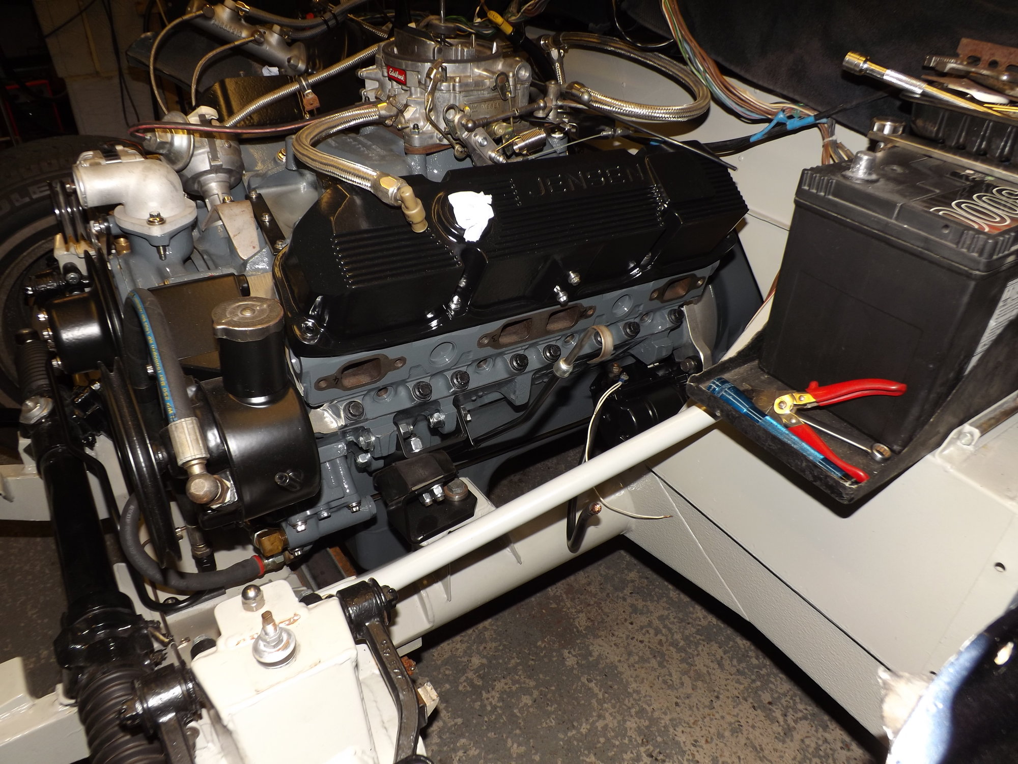

Ooh, an Essex. Question time, what is the water outlet for on the back of the water pump for? I assume the two blue hoses are heater, but that third one baffles me.

The blue hoses are feeding the choke on the DGAS. the heater should be plumbed between the back of the pump and the spigot at the rear of the inlet manifold.
There we have to disagree! At one time yes, but that time is now well in the past. Far superior products are now available that do not need to be imported and so cost far less. They are also immune to solvents, unlike single component paints like the POR range.
Okay, sounds logical, now I look closer at the picture . I’ll be eliminate the water temp temp choke, for simplicity, I have a manual choke conversion.
I guess I can just plug off the two pipe stubs?

I would connect them together, ie short circuit rather than open circuit. Save up for a 38DGAS, far better for the engine and the driver not to have to play tunes on a choke cable
.......Left it open in the end and used the accelerator pump to get the car running.
Anyway, I'm strayingfftopic:
For a guess, connecting them together means water bypasses the block, loses a touch of cooling capacity.
It is an important part of the coolant flow through the head and was a later Ford modification. So even without a heater I would recommend connecting them.
