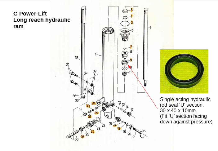

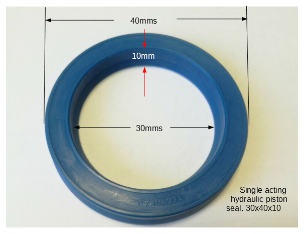

As already said - highly unlikely a designer of such things would create bespoke seals - first thing you do is reach for the seal catalogue and pick what you need for the bore you have decided to use.
So take it apart, make a note of what goes where, find local hydraulic specialist, take the bits in and walk out with new.
