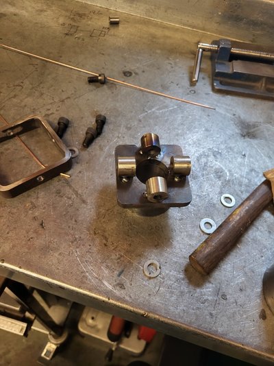

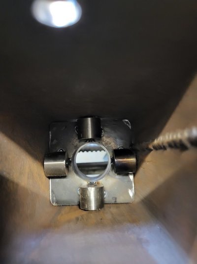

Thanks Fazerruss. Sorry to be a pain - what are the cap screws, half way down in this pic holding? Is there another bush there? We're starting the adjuster build now. Cheers.It's the steel bush that goes inside the column ( the part that supports the lower anvil cradle). It keeps the piston centred
