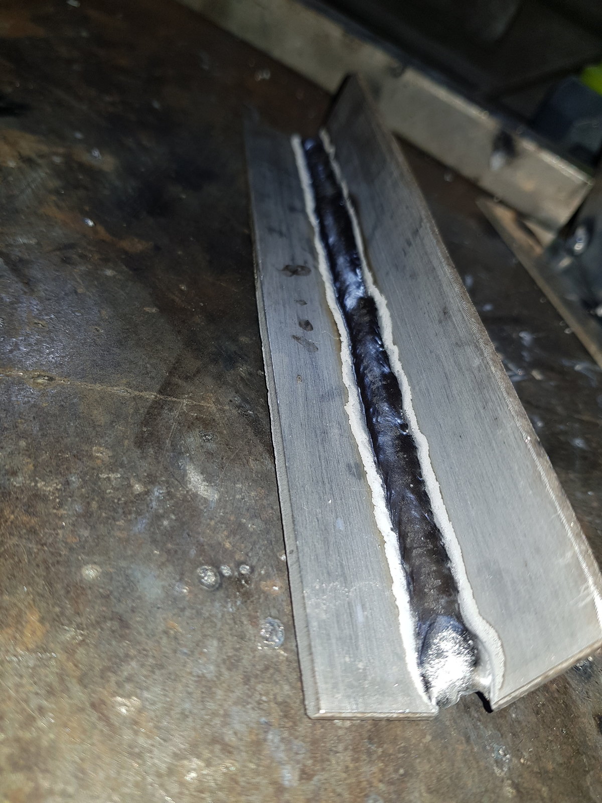

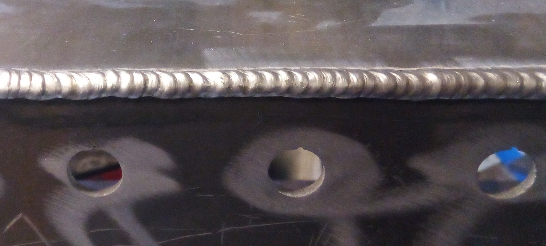

Not bad at all for first go
Looks to be a bit on the hot side and maybe a bit too fast on the travel.
Might be worth turning down to under 2mm and see how it goes.

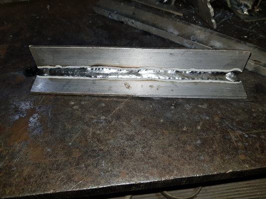

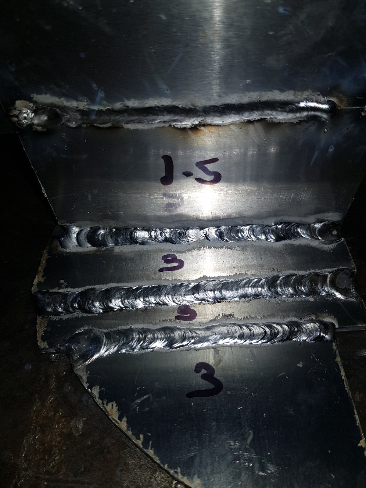

I have just been keeping the setting for the thickness of the material so far..

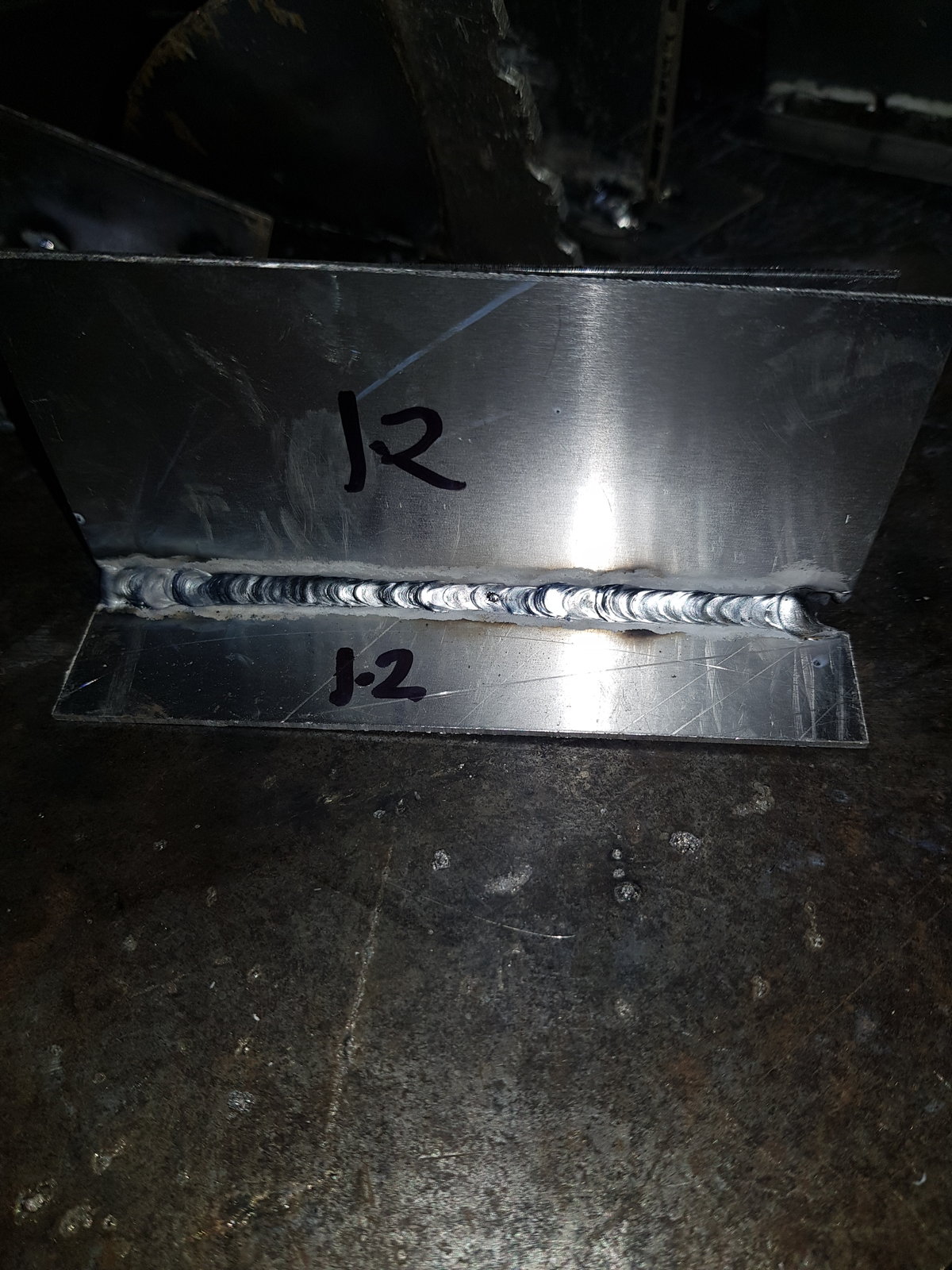

Tried going down to 1.5mm sheet butt weld and that worked so went down to some 1.2 which I managed to get a fillet on ok. (Ish)
The welds loom better in the flesh than they do in the photos. Honest.

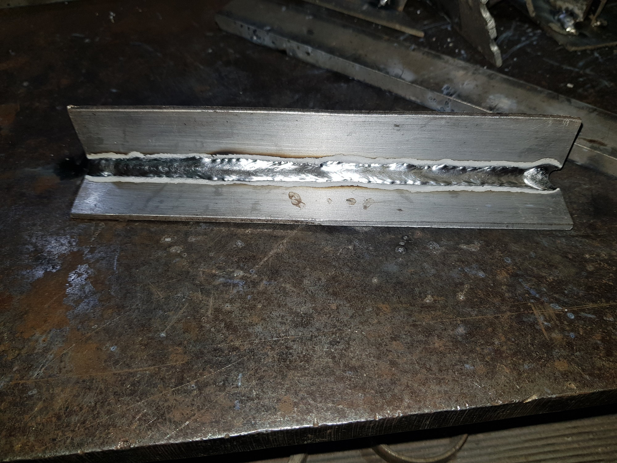

Found some 3mm and did (bottom to top) butt then a lapp. Then stuck the bit of 1.5 that I did the butt weld on to the 3mm. (I turned the welder down to 2.2mm for this (that was a guess which seemed ok)
Then tried inside and outside corners on 3mm again
I know what you mean about the camera, sometimes I take a snap of a lovely weld and when I look at the pic I can't believe how bad it looks, so much so I have to go back and look atthe weld again to make sure I wasn't imagining it

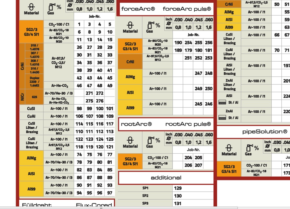

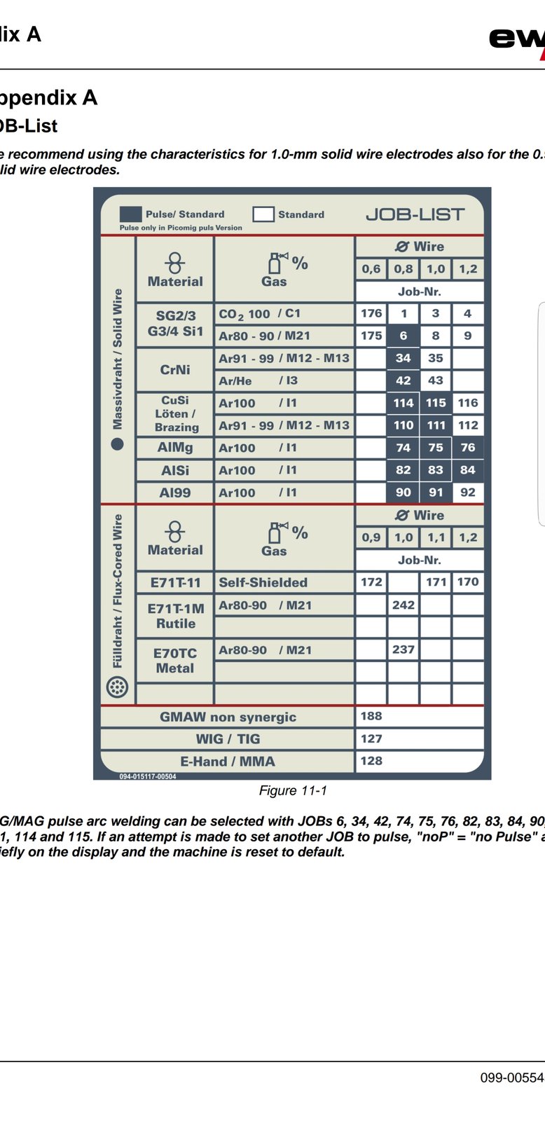

How about the arcForce, arcRoot, etc.
Are they something I select or just something added in to certain Job's?
I have checked the job list and it's only giving me the ones that are on the sticker?
I will drop ewm an email and see what is going on with the missing features.

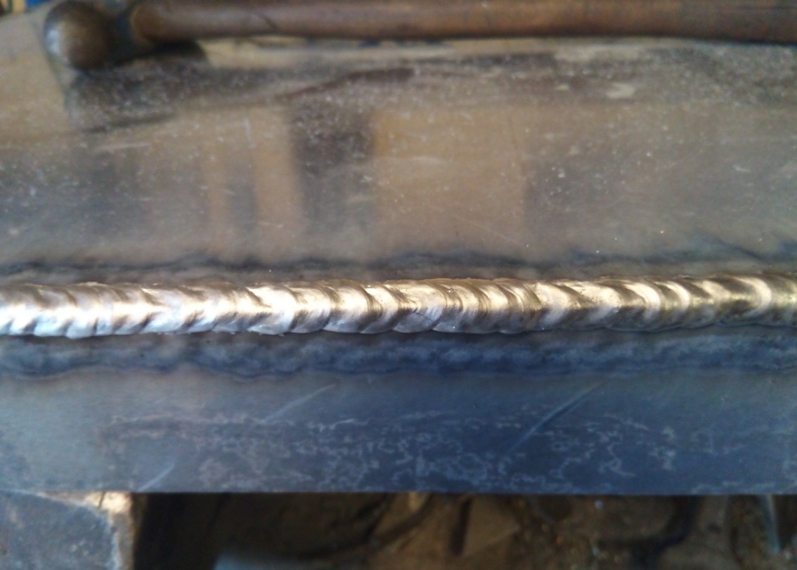

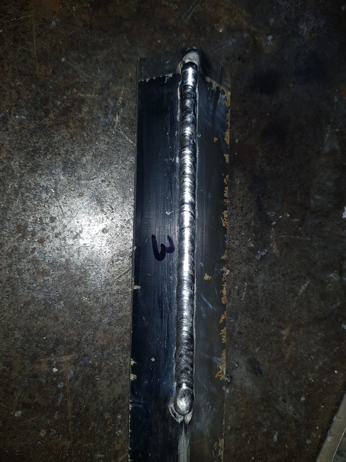

I have had a bit more practice at 'cosmetic' welding but not quite got there yet! Ran out of scraps today so will have to cut some more up and have another go!
My welds are still a bit smoother/flatter than I would like (trying to achieve the stacked look). If I was using tig I would add more filler at each dab it stack it up a bit, with the synergic, I turn the wire speed up which also turns the amps up so I just end up traveling faster rather than building the weld top up.
I tried JOB188 (manual / non-synergic) but it will not let me turn pulse on at all when in manual? Is that normal?
Not sure regarding manual mode, never used it on the 355 and don't even think the 330 has it.

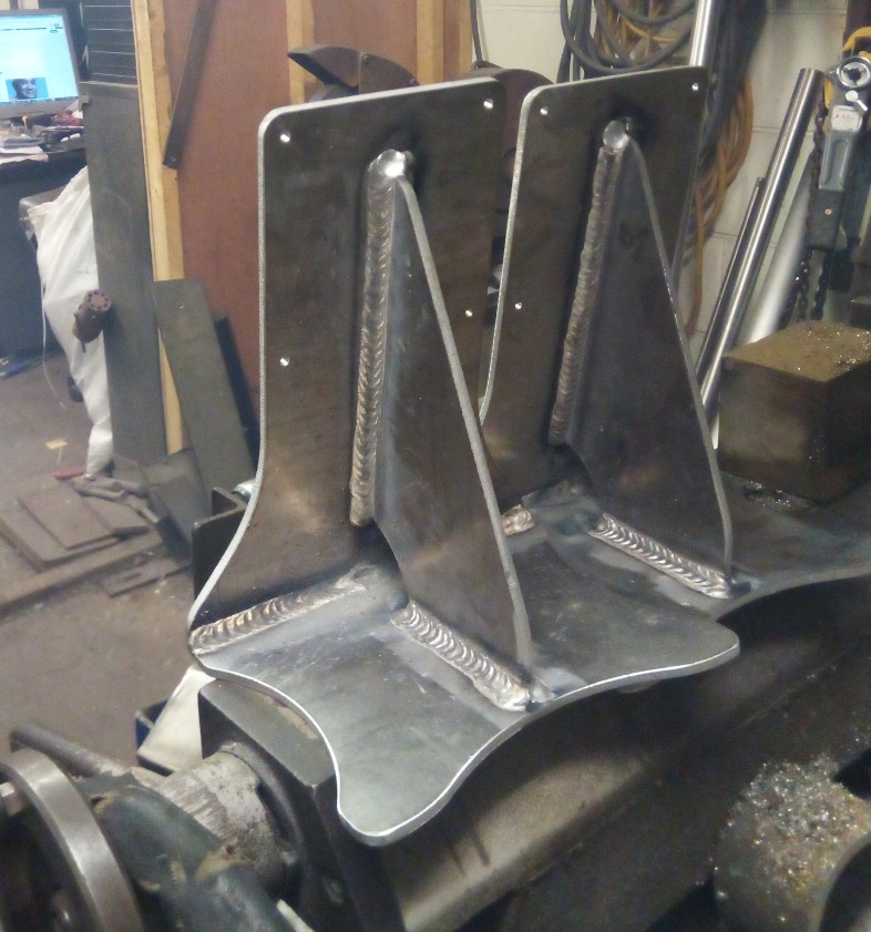

As you only have single pulse then torch manipulation will be the only way to get any real pattern in the weld. Try either back/forth or small circular movements, think it most likely circular movements I did in the previous pic of the monitor stands. Then again I just vary things as I progress as I watch the puddle and can change between tecniques as I go
To get the stacked look you really need double pulse I would say.
Hi all, just wanted to say this really is a thorough and excellent review of our Picomig 180 Puls machine! Thank you to Hotponyshoes for taking the time to share his experiences, and to all those that have added comments and advice! I will send a link to this to our factory in Germany, as i am sure they will be very interested in all of the valid points you have made. I can confirm that the 180/ 185 machines do not have ForceArc/ or RootArc options, these processes are only available on the 415v Picomig 355 variants. I agree with your point ref the guide tube being part of the conversion set, however the only reason I can see is that in the past where we had conversion sets that could be used on different machines, they all have different distances from the euro fitting to the rollers, therefore we would have several additional part numbers to stock, with every conversion set for each model. However in the case of the 180, this is now the only machine that is using this particular wire feed set up, so we would only have 1 size. I will mention to the relevant people. If there is anything else i can help with just let me know. Happy New Year to all!!
