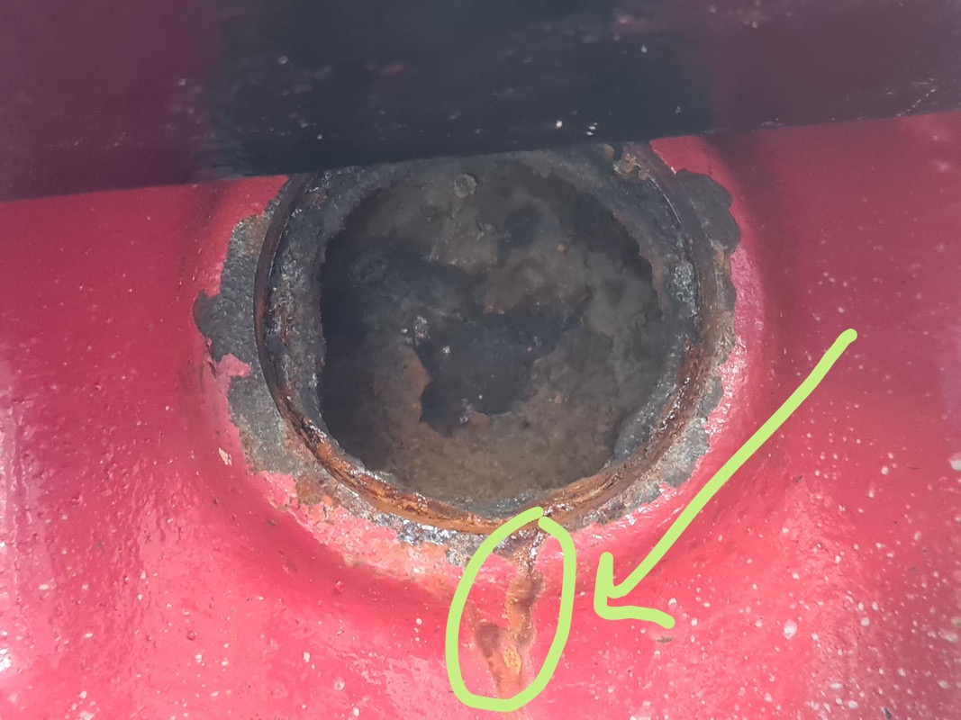

So a basic hole filling job done, epoxy resin and West systems filler 404, used a couple of hardwood plugs aswell.
chamfered back the edges both sides where i could.
valve that was removed
prime the holes and plugs first with the epoxy and while that is greening off mix the filler

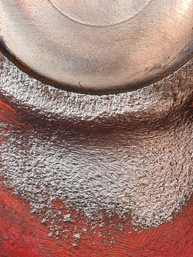

oh and prep the woven, always good to be ready
add the filler to the catalysed resin untill its a thick enough to hold igts weight, liek peanut butter for this job.
then a matter of applying to the plugs and filling the holes but not to the top as to be sure i added the woven matt.
left for an hour so it was then the excess was able to be scraped off to get a better adhesion for the matt
once happy then let set, sand back to be level with the outer edge then fill with more epoxy resin/filler
sweeeetttt
