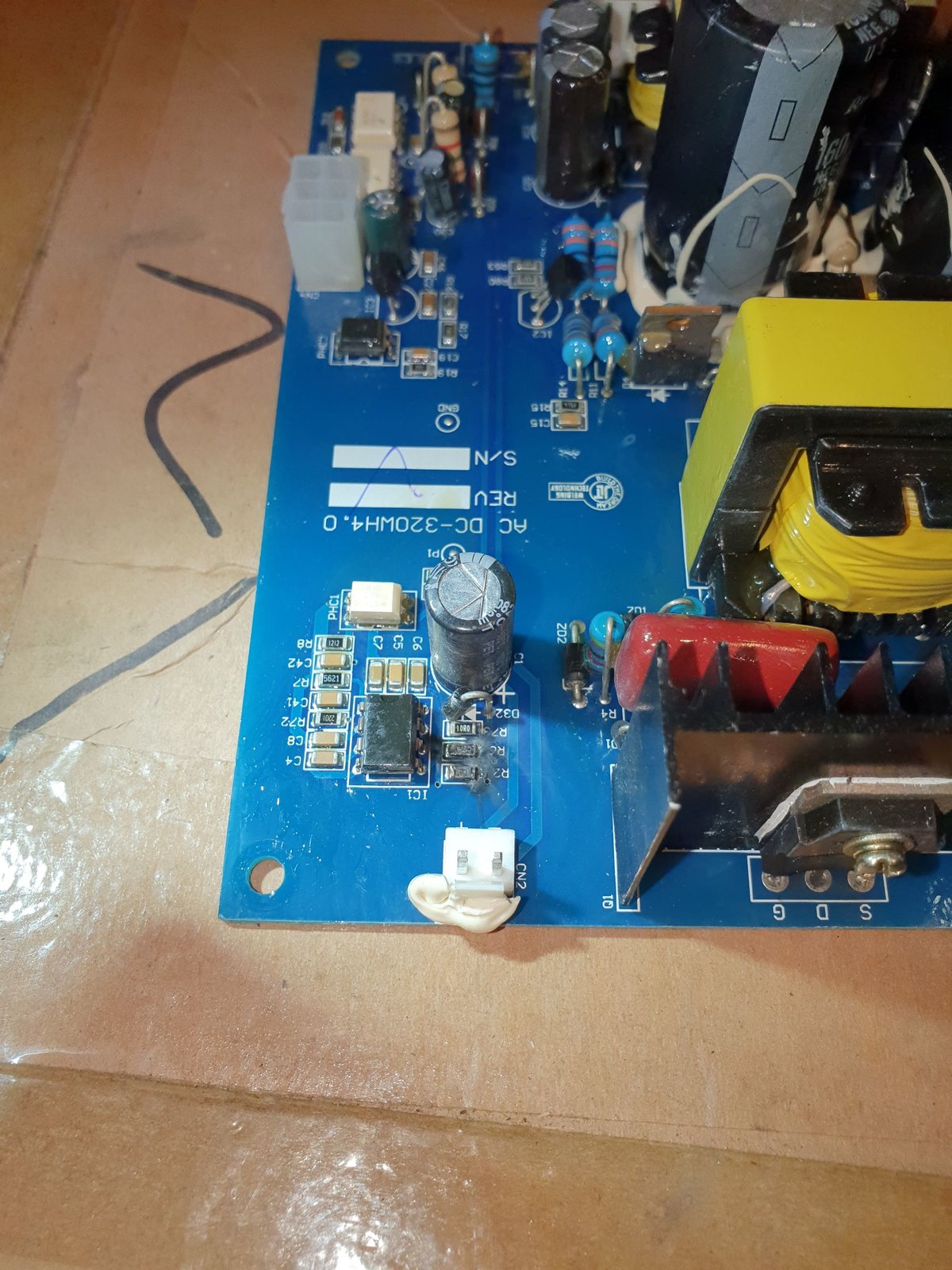

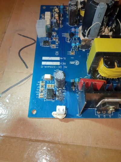

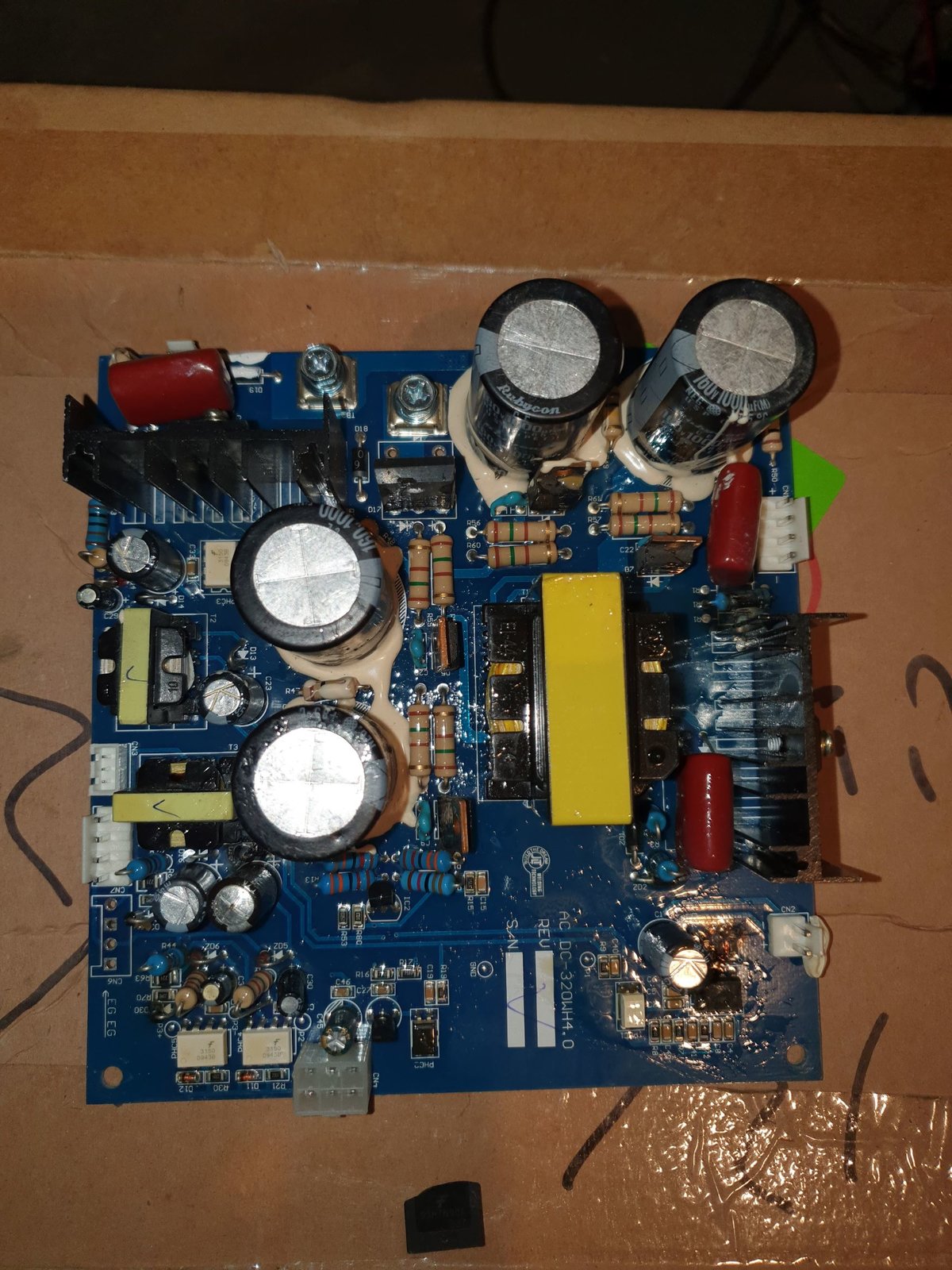

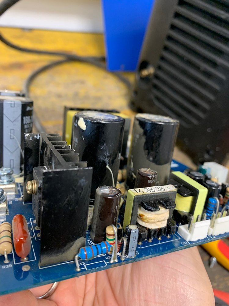

I know, that the problem of the blown capacitors was caused by not using the device for a long time.From the way that the problem on your machine occurred after a period of non-use, it sounds like the insulating aluminium oxide film in the electrolytic capacitors deteriorated, causing a short-circuit.
I think that happened within one minute after switching on the machine. I haven't tried to weld, but I didn't switched off the device immediately (because at first I wasn't sure, which device caused the bang). I switched off the device after about 2 minutes. My next mistake was turning it back on again after a short while (tto see if it was still working) - it powered on normally but a few minutes later it got dark (this was propably the moment, when the winding of the transformer got damaged due to the short circuit of the capacitor).How soon after you switched your machine on did the fault occur, and had you already tried to weld by then?

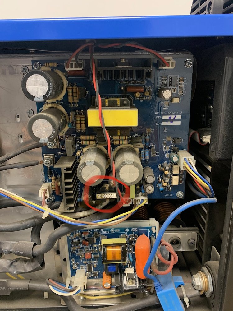

I think, that the label on the transformer (14:38:38:14) describes the amount of windings or the ratio of the coils. In that case, there seem to be 4 coils included in this transformer. It might be somthing like this https://pdf.directindustry.com/pdf/...co-ltd/flyback-transformer/224418-928933.html but with only 8 pins.How many windings are on the transformer?
No - not yet. But you can see that the insulation film is burnt and discolored (that's why I think it's damaged). I will unsolder it maybe this weekend.Have you removed it from the board and confirmed that the windings are open-circuit?
I've already looked at all of these entries - there is no transformer with this ratio available.The Chinese website Alibaba lists many electronic components and complete PCBs used in the "generic" inverter welders, but as you said, it is hard to track down the exact part:
This would be the last option - since there are two coils on each side of the core and these are also insolated with a foil, it wouldn't be that easy. The windings are very thin (not thick as you mentioned) - the affected transformer is on the PCB for the internal power supply (not on the high power side).I think there will not be much wire on this transformer, and the windings will be quite thick. You may be able to dismantle it, count the turns, and rewind it yourself, or find a local transformer/motor rewinding company to do this. To resist the skin effect at the high frequencies used in inverters, the wire used may be multi-strand "Litz" wire.
I guess this board may be supplied by AC mains, or powered by the main DC bus after the input rectifiers ( i.e. it is a DC-DC converter ). Either way, if you know the output voltage(s), maybe you could replace it with a general-purpose power supply.the affected transformer is on the PCB for the internal power supply (not on the high power side)
