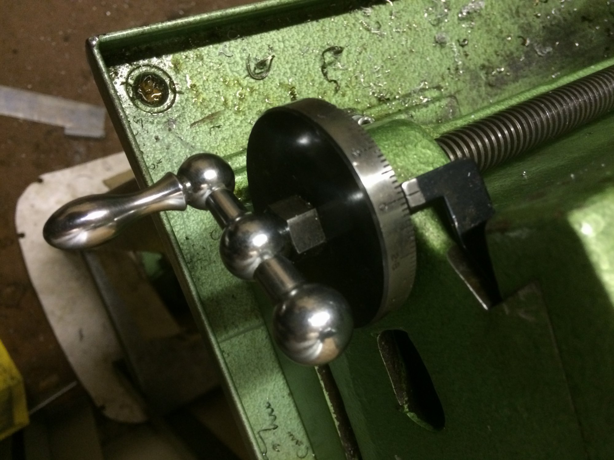

While the lathe was running I engaged the feed with this bad boy which set the travel to cut (pic1)

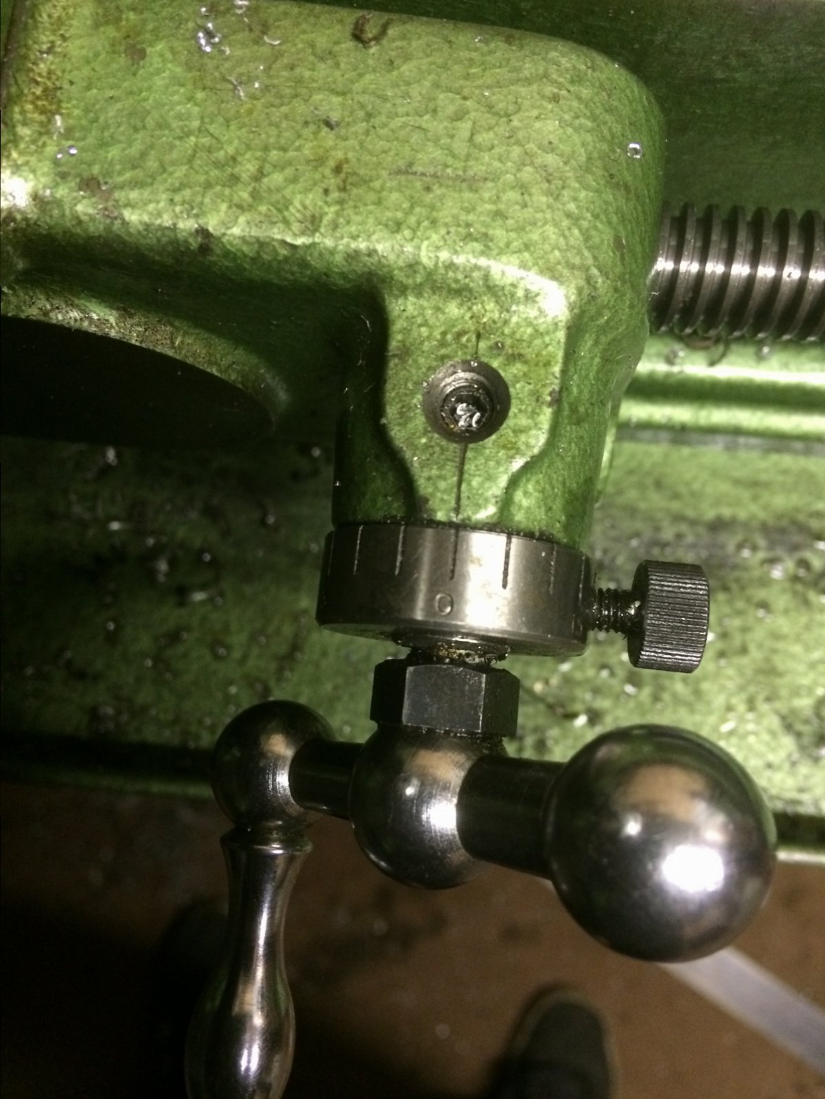

The thread dial (pic2) remained at zero as the half nuts were always engaged but I could stop the feed with the item in pic 1. Then I wound it out

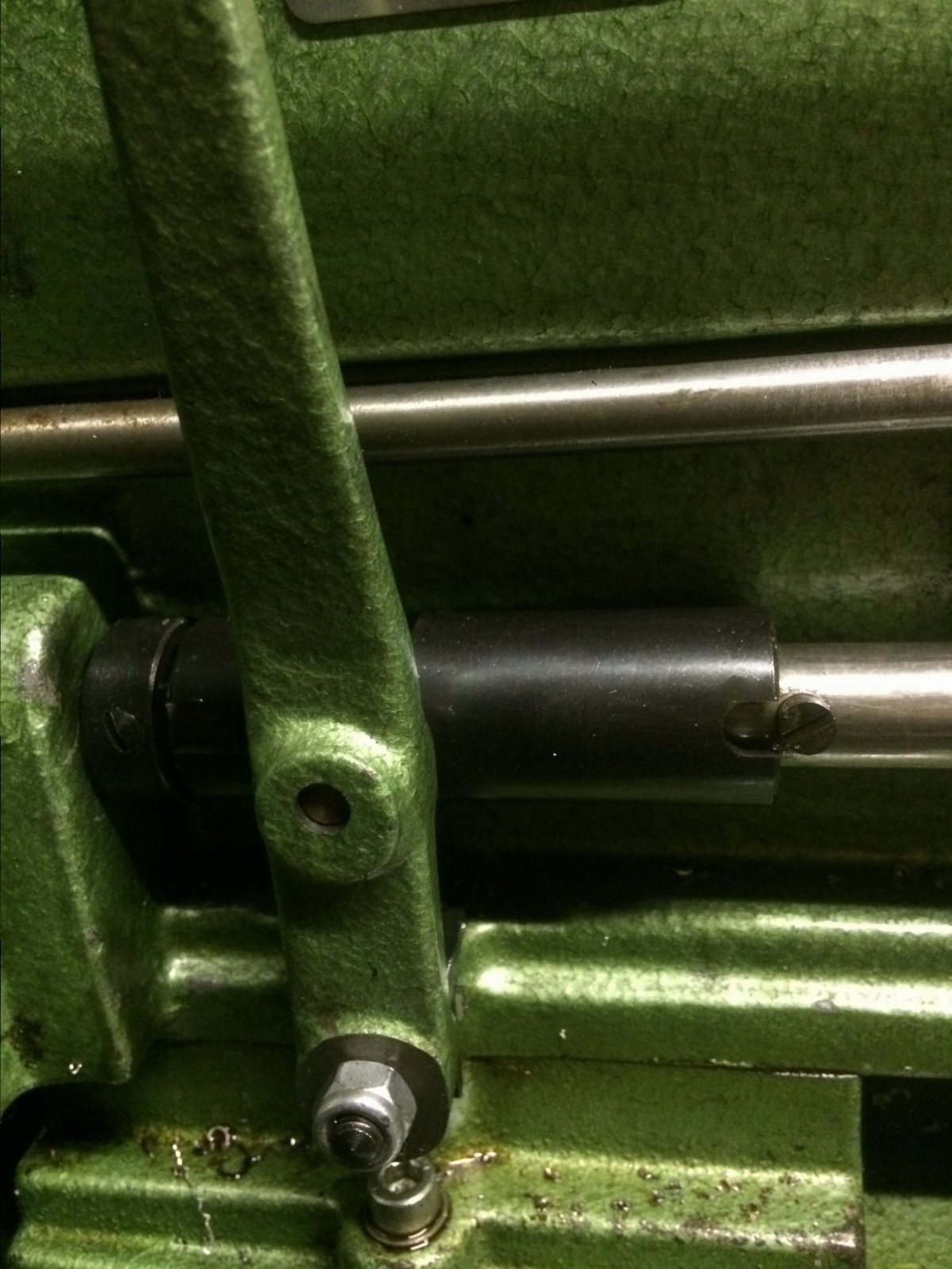

And bought it back with (pic3)
Bought it back in to cut again then reingaged with pic1
Is that a bad way.

The dial stops when the nuts are engaged it is easy to get muddled upYou don't set the dial, you wait and watch it turn until it reaches the correct graduation then you engage the halfnuts.
Mid flight????? On the fly???? So while it's turning I hit the lever at exactly the right time.You don't set the dial, you wait and watch it turn until it reaches the correct graduation then you engage the halfnuts.
I got no chance.
its not as bad as it seems its easy practice it without cutting sometimeMid flight????? On the fly???? So while it's turning I hit the lever at exactly the right time.

I'll leave the dog drive engaged and just engage the feed when the tdi hits the same mark every time then bring her back on the pinion.
With the tdi handle and repeat yes?
