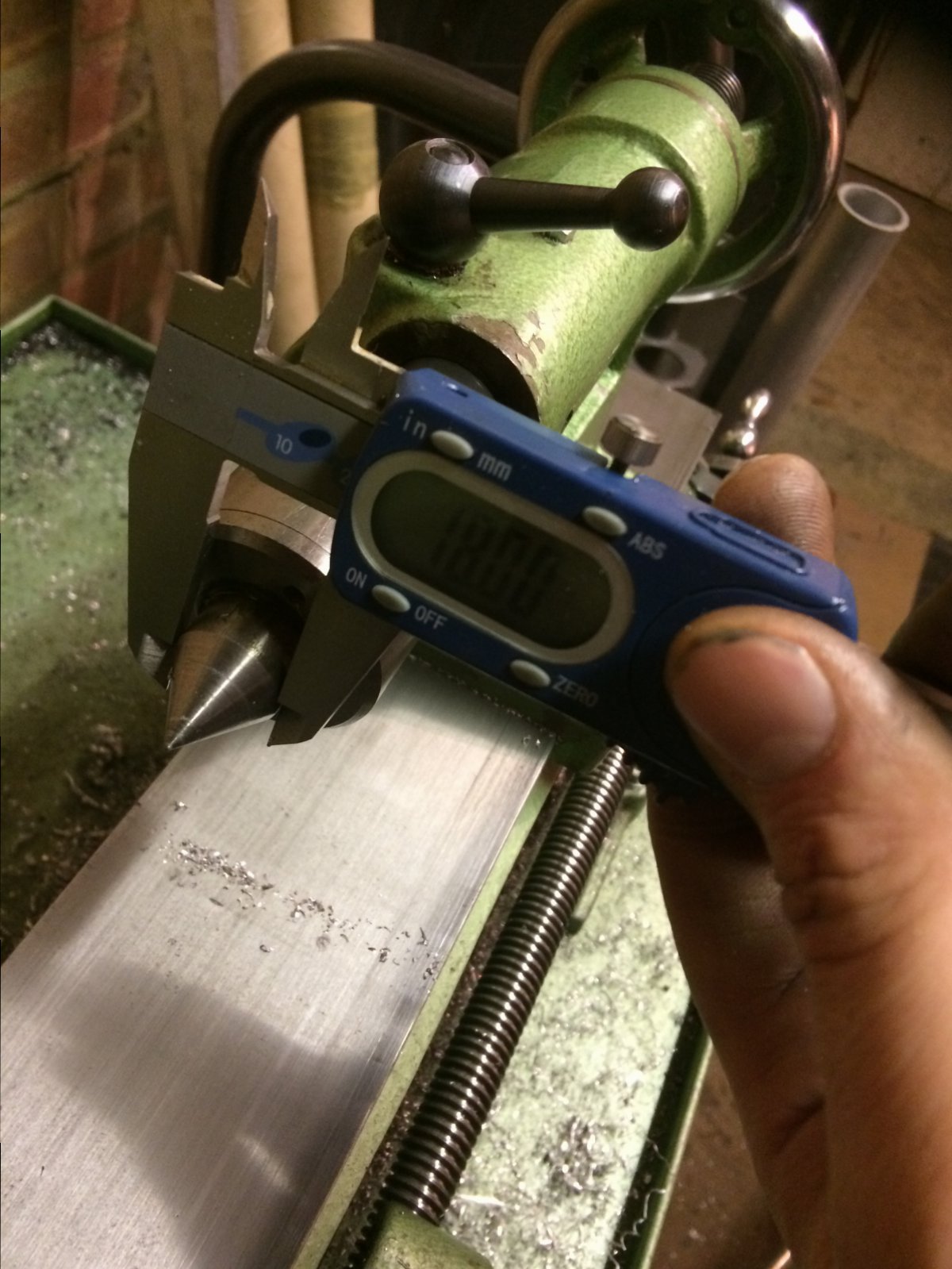

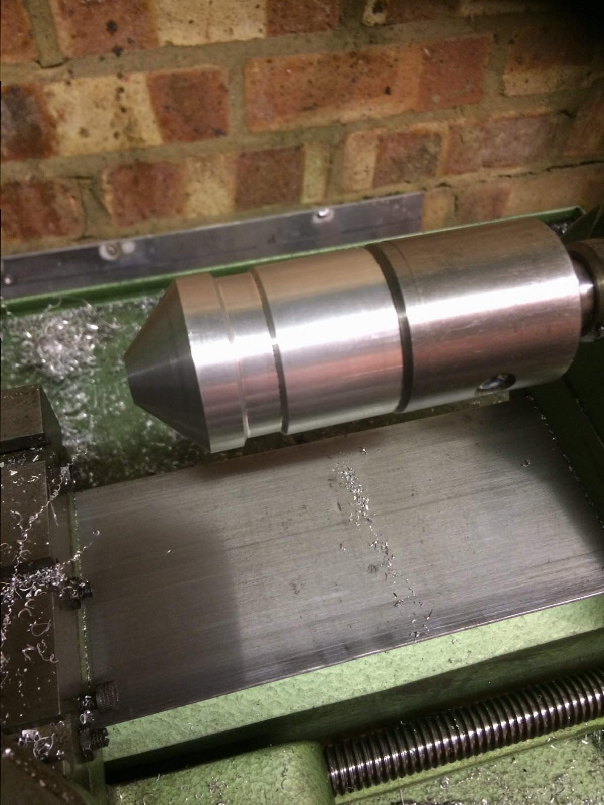

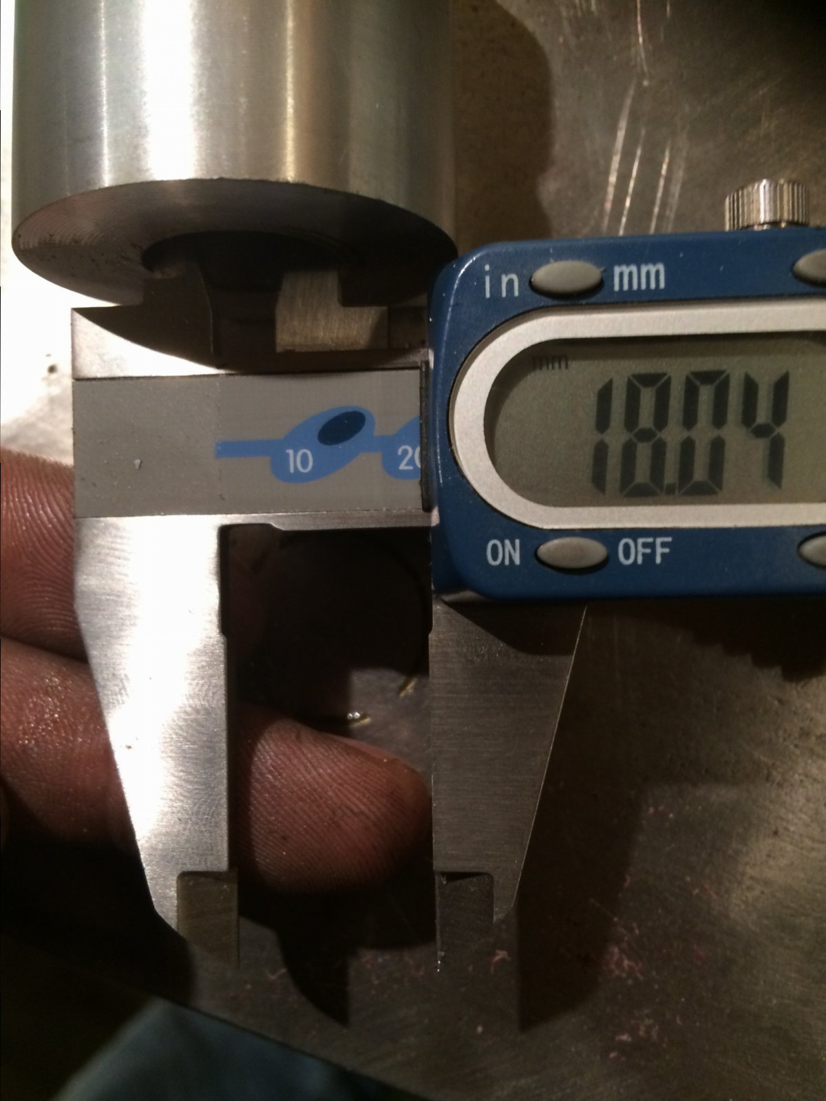

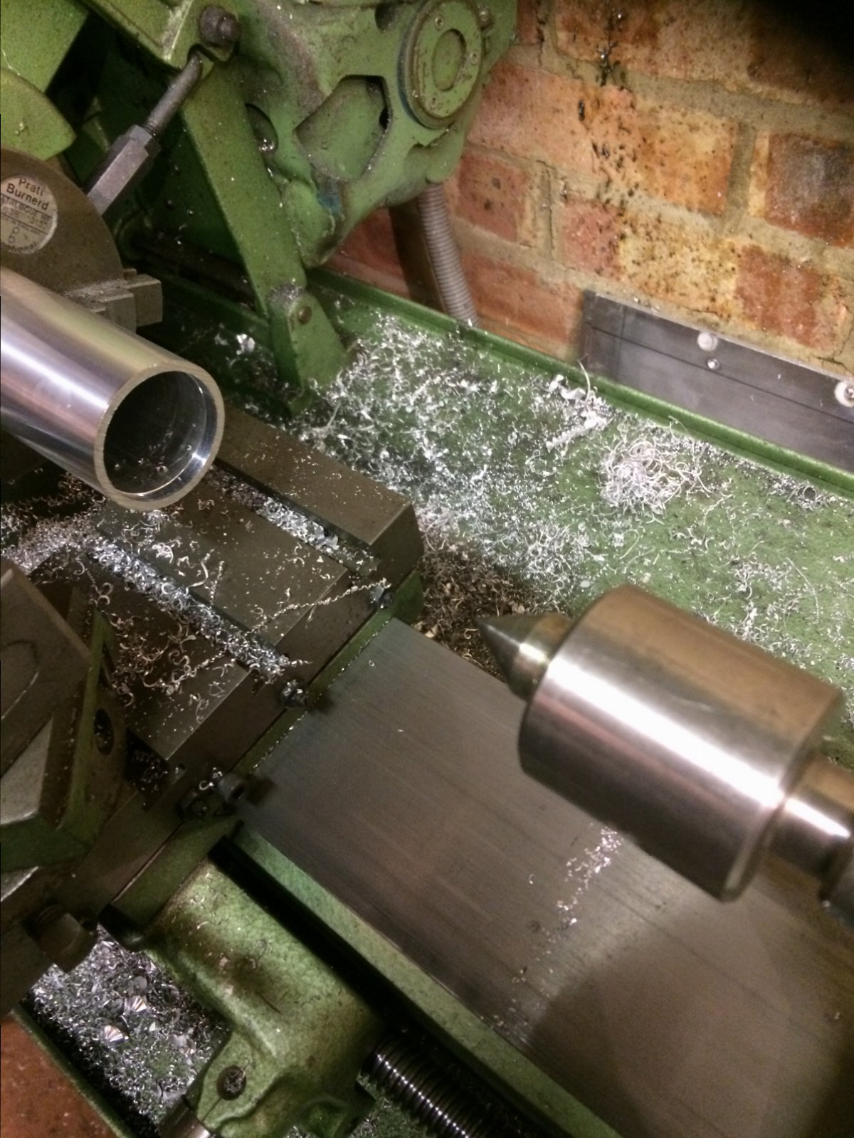

That's what I noticed Pete. My saw is very good but it's still 0.2mm out of square on the vertical and the centre noticed it straight away. I faced off the short pipe unsupported and then refit it which then it ran bang on.That's a handy job Richard.
The only trouble with pipe centres comes if the pipe is not cut square, it makes it run out of true.

Well I must say for a little lathe it's a very good accurate tool. I turned down, faced off and internally bored out some short sections of pipe to practice with and really enjoyed it.

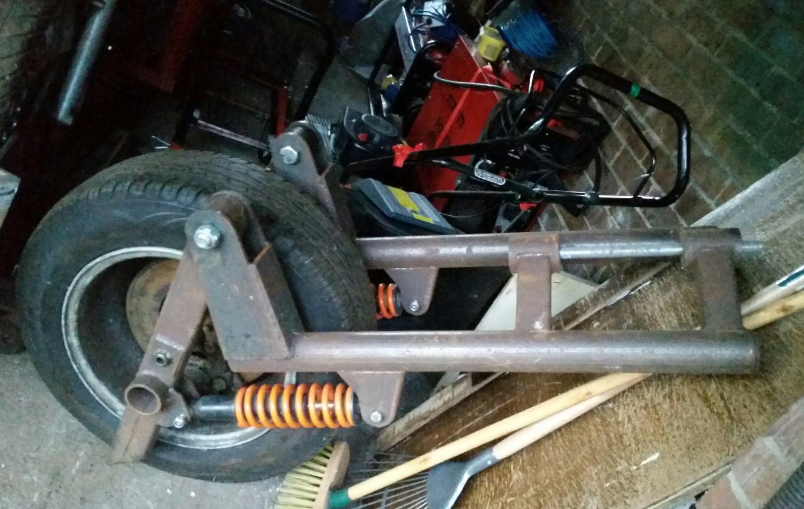

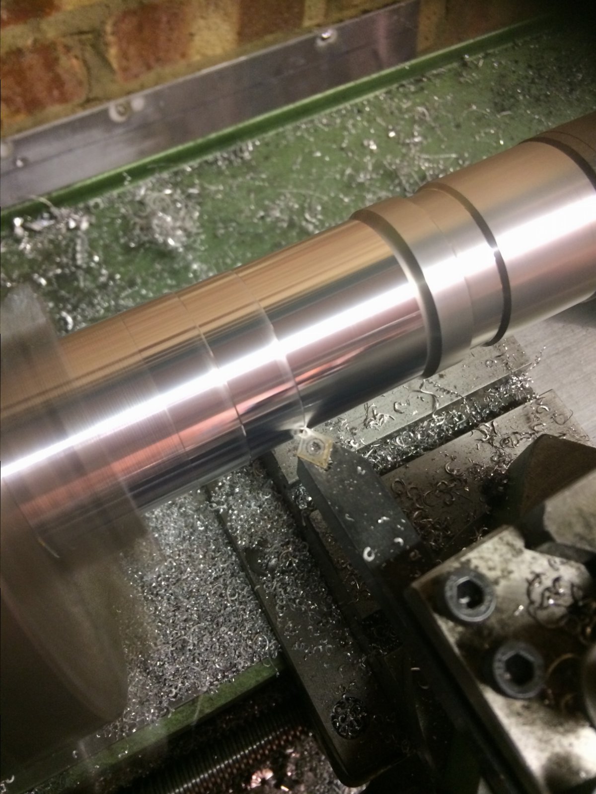

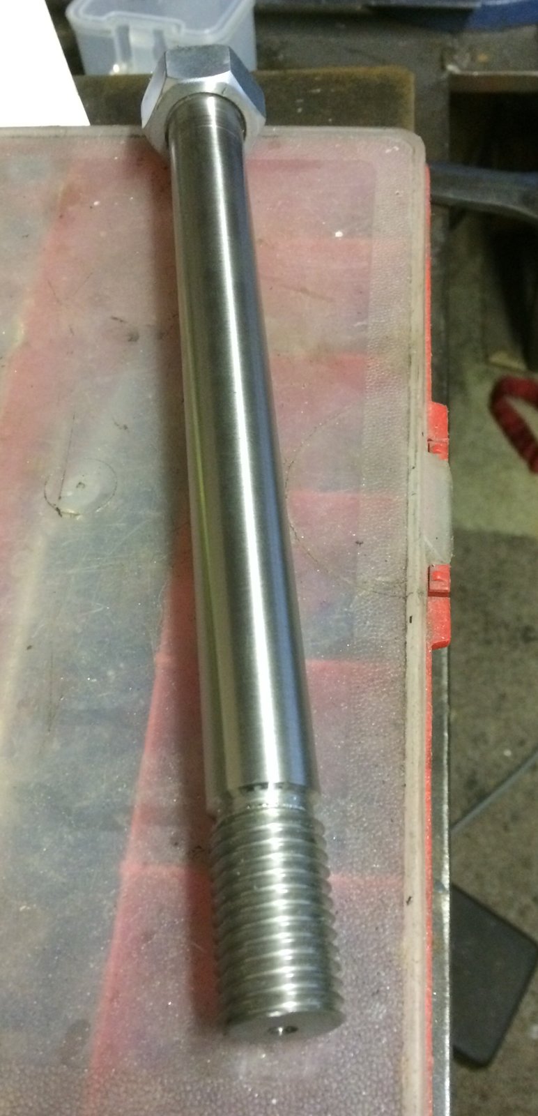

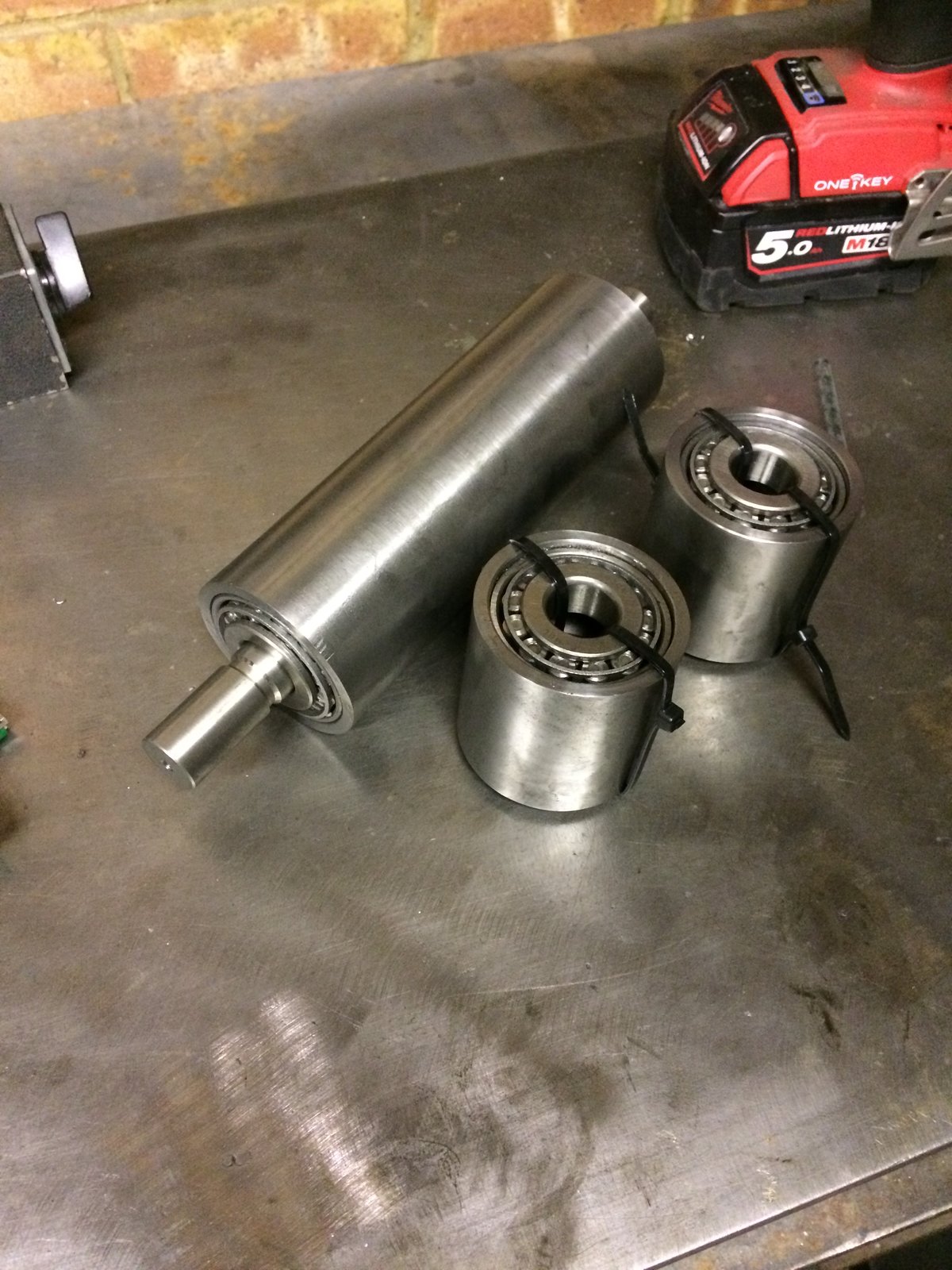

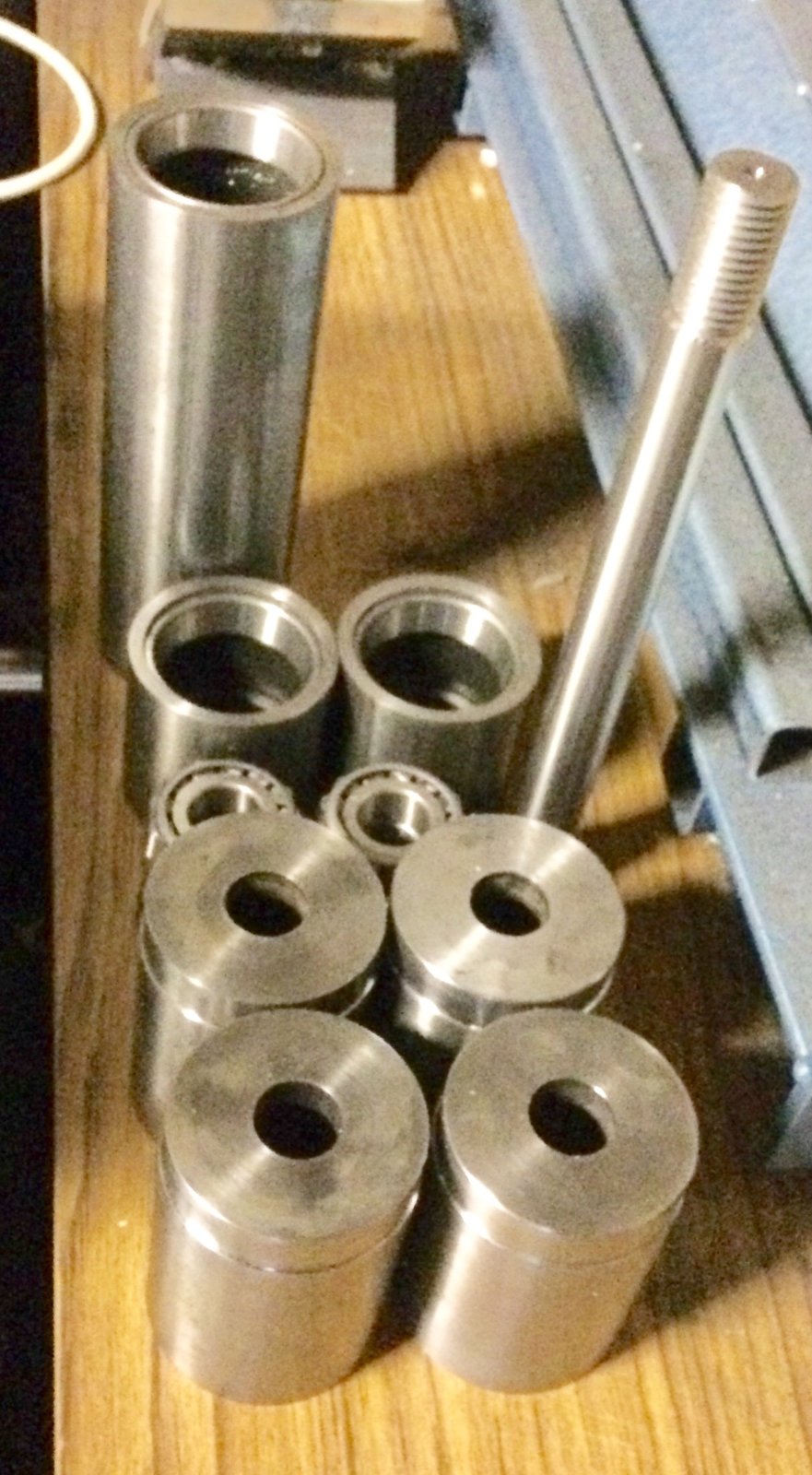

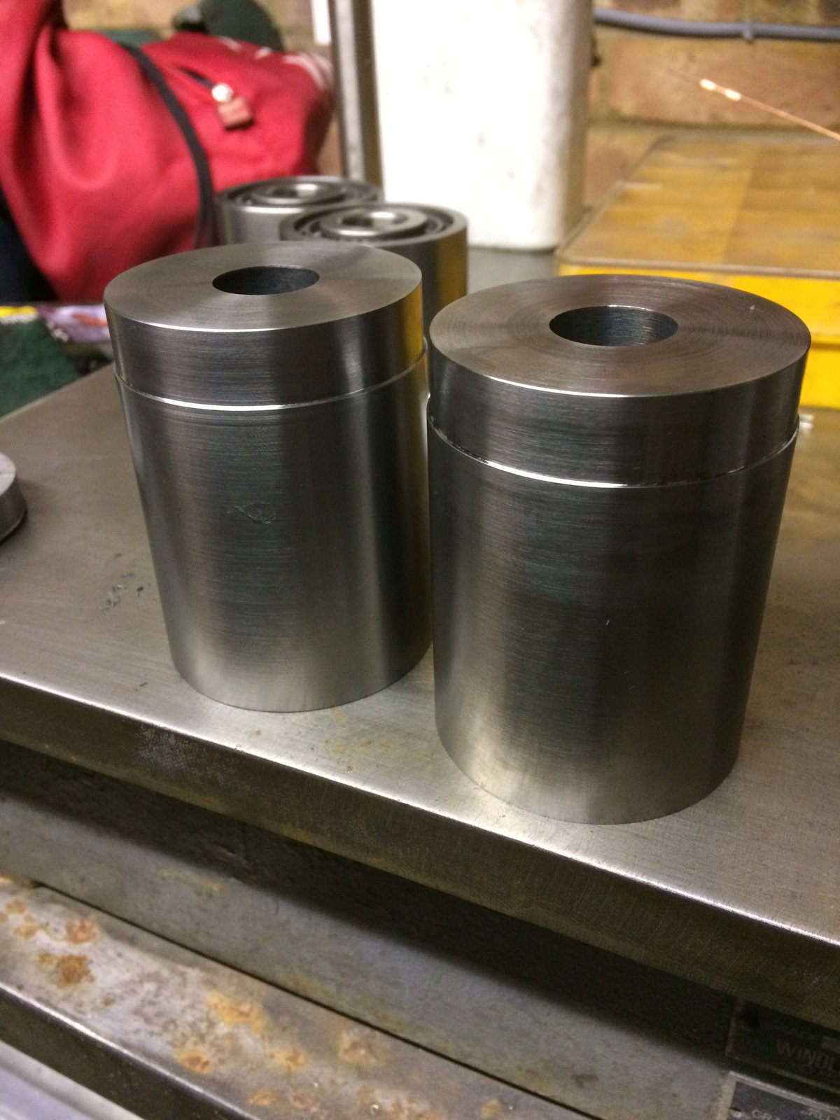

Yes then leading link.This is the front fork assembly that he intends to copy. He is building a complete trike eventually. I’m doing the bits he can’t do. Like the machining and the aluminium welding.
It’s gonna be the 2nd one he’s built. It’s got a 2.0L pinto lump to go into it so it’s gonna be pokeyYes then leading link.
