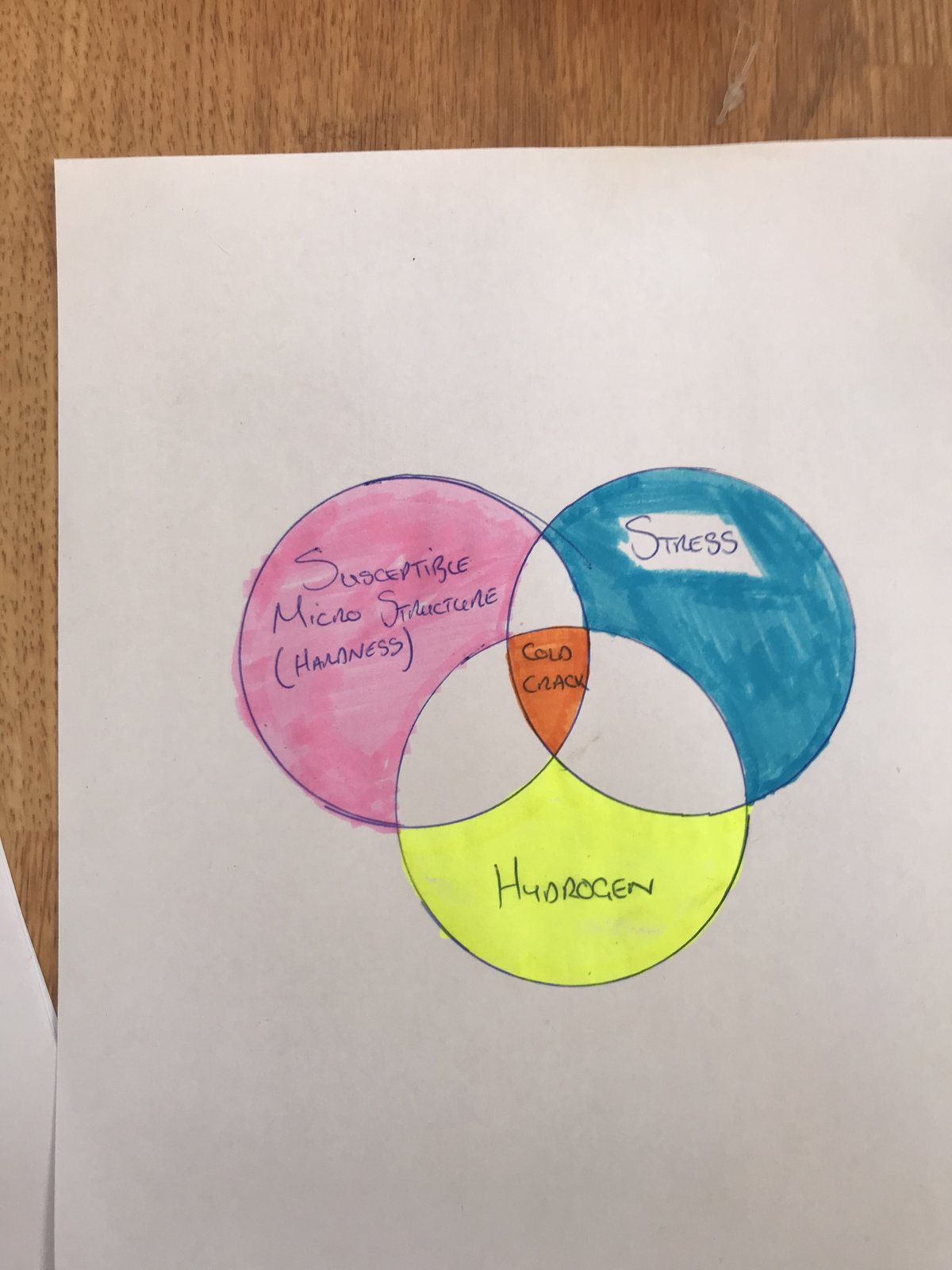

7016 acording to my old fos bible are for high sulphur and high carbon steels that crack under weld deposit.
