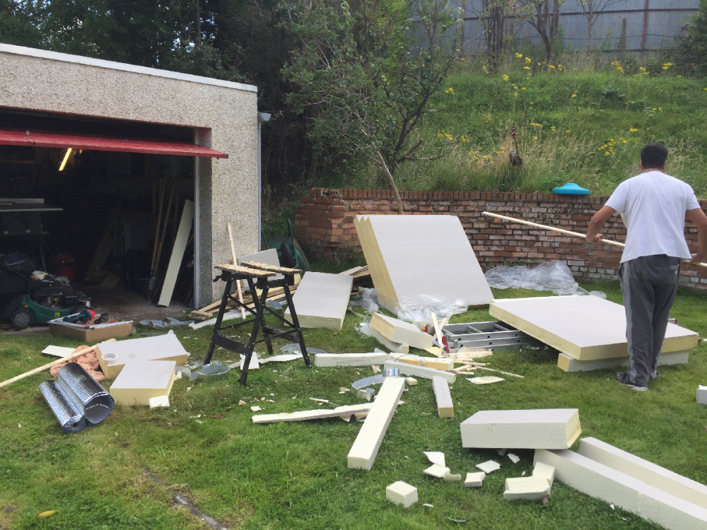

As the title says, finally got round to fitting insulation into the garage roof, hoping to sort out the condensation / rust on me tools.
With many, many thanks to @roofman for the advice on technique, what to buy and where to buy!
I got some 110mm-130mm seconds off a Welsh company on ebay for around £130 delivered.

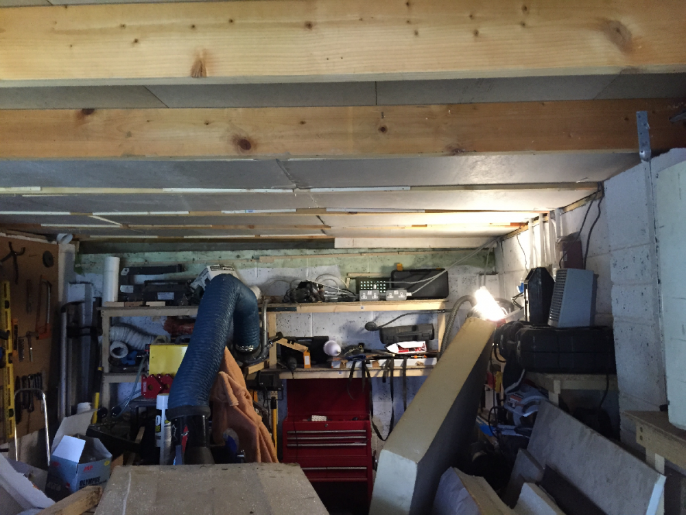

Then got some silver backed insulation bubble wrap to put between the insulation and the roof.
Took myself and my mate all day to get it fitted and hats off to people who do this for a living - the PUR is flipping horrible to work with. Masks and goggles and I'm still coughing six hours later!
This is half of it fitted - I've got insulation tape, too, so will be covering up all the seams (and, yes, there is plenty ventilation in the garage).

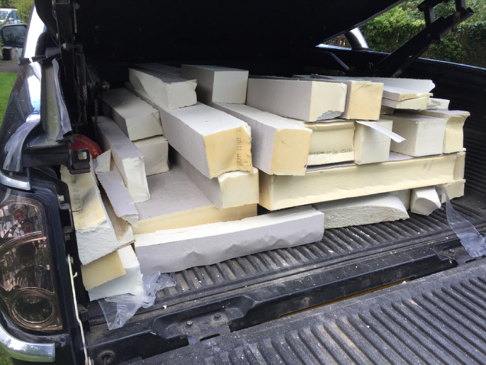

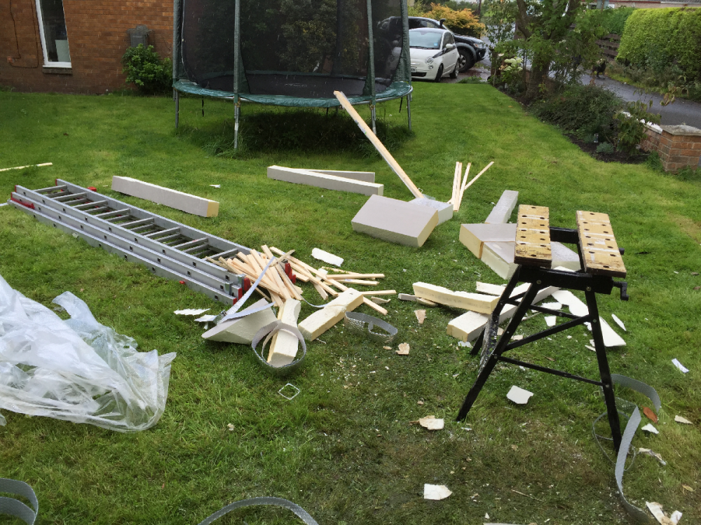

And this is what's left...
It's too bulky for me to hold on to so I've offered it free on the local facebook page, otherwise it's off to the tip in a couple of days.
So hopefully that's it! We'll wait till the winter to see what difference it makes to the condensation & rust.
Oh, and I need to refit the lights and sockets...
