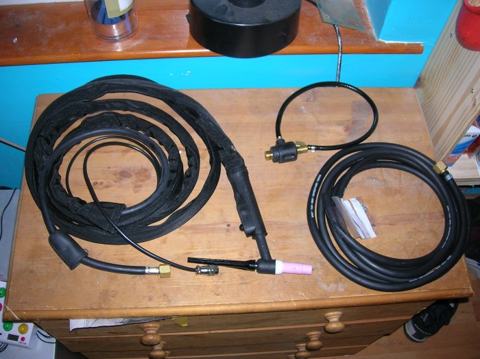

well my little inverter arrived this afternoon, ran a few quick beads with it just to see what it was like, will be more pictures once i have used it in anger, don't really like having to crouch down in a dark corner of the garage to run beads
thanks to steve (weldequip) for the great service, did you start pulling bits of your shop apart to use as packing
ran a few beads with bohler 2.5 rods, all at 90 amps
these are DCEN, arc force 0
DCEP, again with the arc force set at 0
and finally, DCEN, the top bead is with the arc force set to 8, the bottom with it set to 4
accidentally hit the button to change from mma to lift arc when swapping the leads over, took me a minute to work out why it wasn't working
appologies for crap picture quality, am currently using a cheap phone with no macro function
