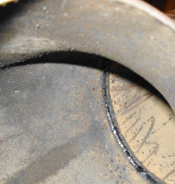

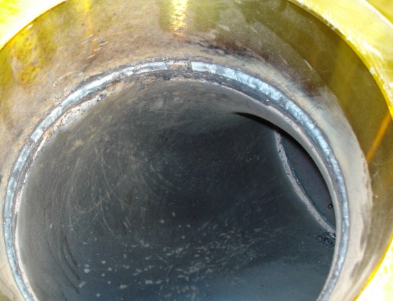

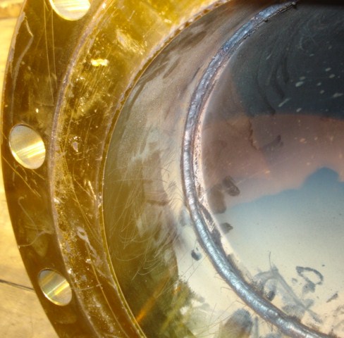

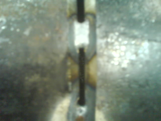

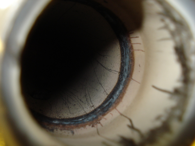

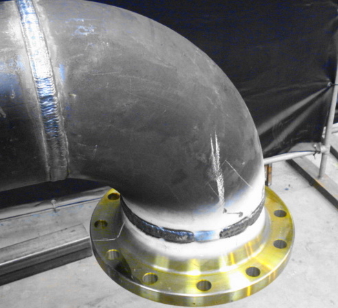

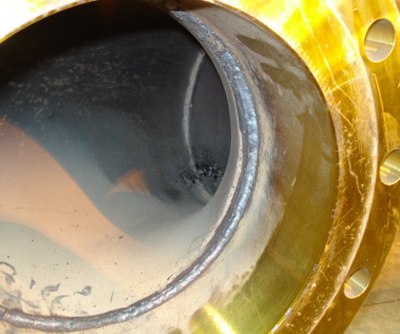

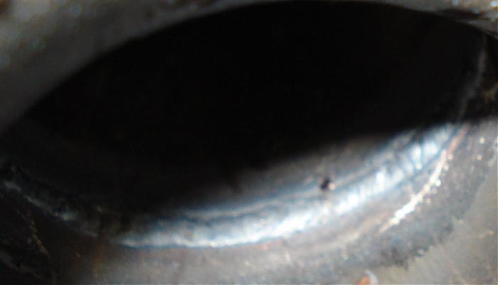

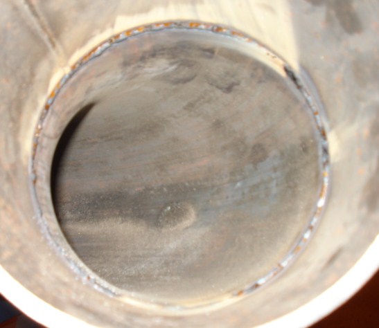

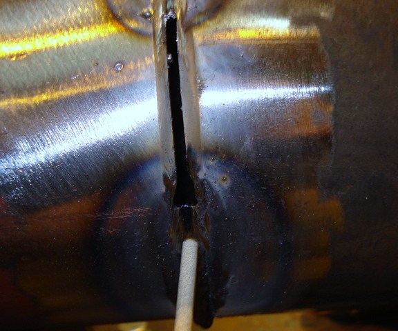

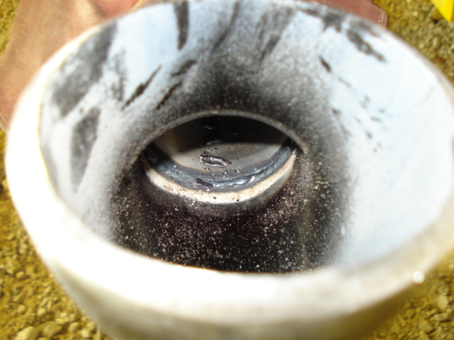

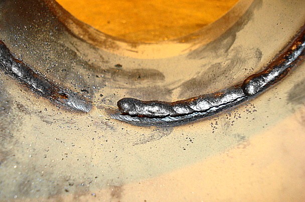

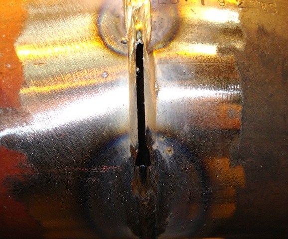

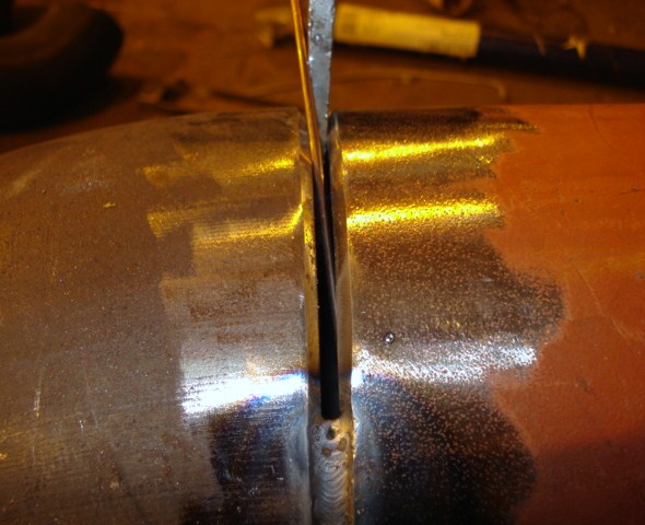

snowy, puddles thanks for your interest,you both mention the fact that the 6010 is a deep digging rod good for roots,recently i came across a butt ,i was ready to weld with 10 root,when the two pipes were lined up there was a difference in the I/D,in this case you must open up the gap to 3.25,this isn,t the main problem for me,the inside root edge is blind so you need more control over the pool,the pics may explain better,it was welded 5g 2.5 6013f/j
