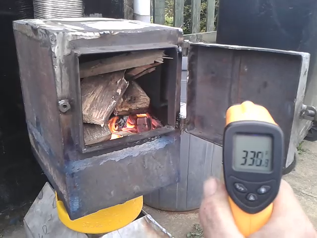

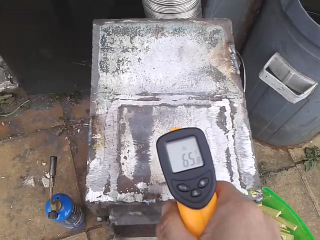

cut the pieces to size and stick them on a disposable barbecue, cut a few small holes in one end of the tray and light up as normal. Once its up to temp use the wife / girlfriends hair drier to improvise a blast furnace. Direct the (cold) air into the holes from a distance otherwise you need to budget for replacing said hair drier.
I've got 6mm plate cherry red on one like this, although I did make a tray, air duct and use a small snail blower... but a disposable barbecue is fine for one off jobs..
