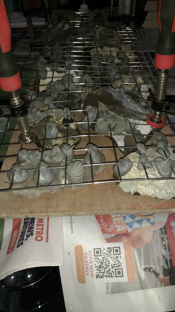

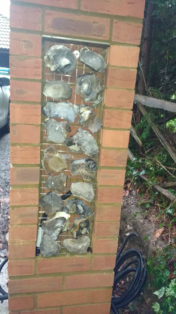

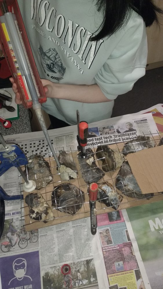

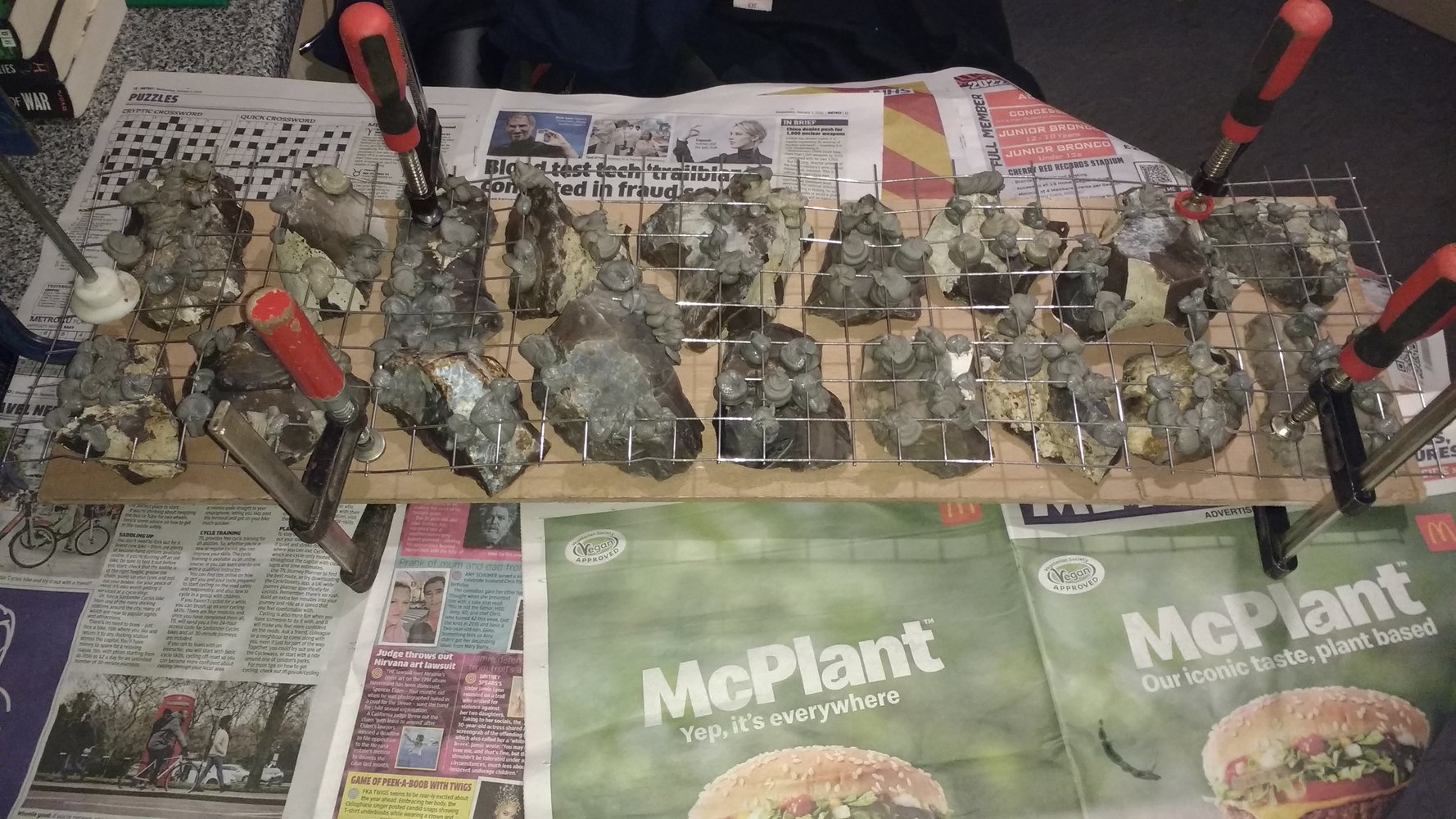

drilll a few holes in the thin ones and resin in a couple screws before fitting
Was wondering about drilling them. What with?

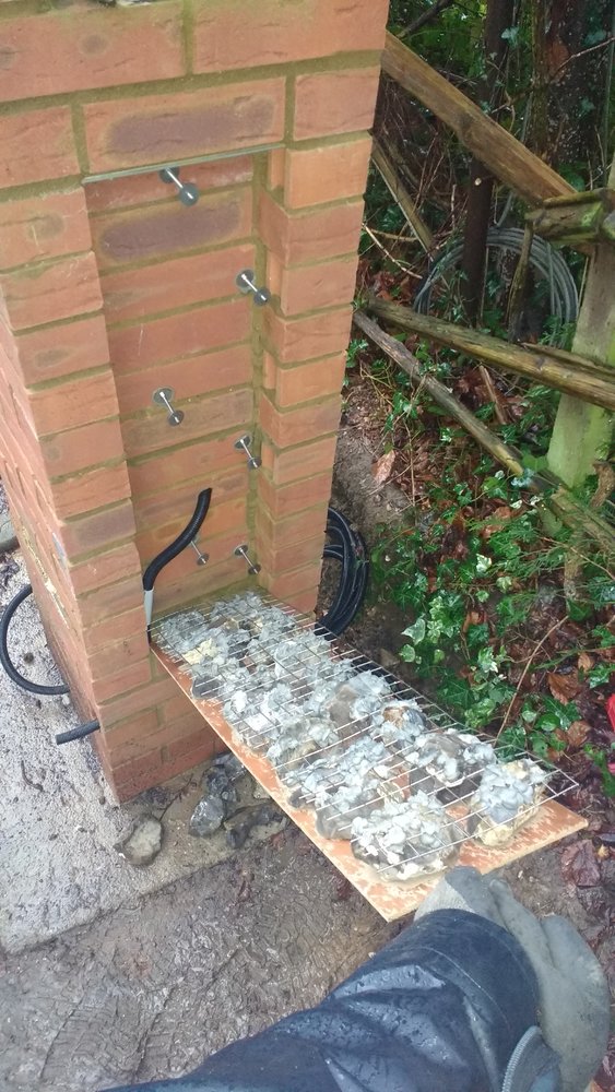

or a daft idea cement the stones in to cement on the flat then mount the slab in the space

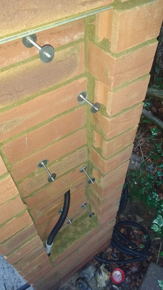

with the weight of the slab a lip at the bottem to stop it sliding out and somthing at the top would id have thought would be enoughOne of my first plans that. With some sort of hook arrangement in the back of the panel to go over brackets bolted to the recess.
be carefull when you move it any movement in the wire will easy pull off the stones
