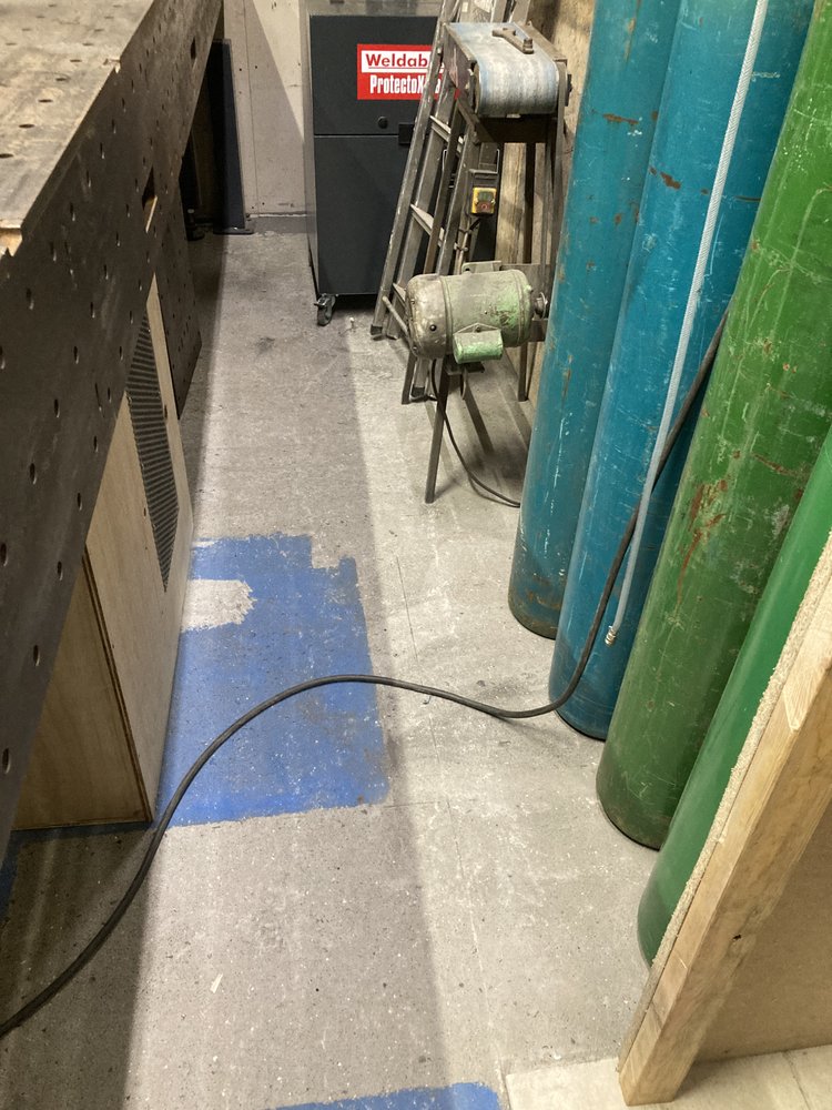

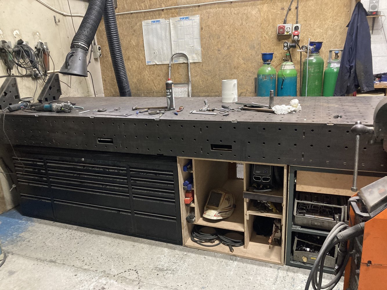

Finally getting the workshop mostly my workbench to how I want it taken quite some time!
I’ve made a new cabinet to house tig (will go where my helmet is) cooler and plasma just need to do the last finishing and add front door
would like the gas bottles chained up against the wall where they are in the pics
Currently have 2 of each gas but will reduce to 1 of each (2 bottles in total)
My bench is away from the wall so I can get all the way around it. Does mean that I’ll need to run gas, air and power a short way (about 1mtr) along a floor then up the wall to the various outlets and gas bottles.
So I really need some mechanical protection from falling objects from the bench etc. can anyone recommend anything off the shelf. There’ll be some 5 core 4mm several air, 2 x gas, 13a single phase cable and 2 more 4core 3 phase cable to house and protect
I do have a part sheet of 3mm Ali chequerplate so I could fold up a two sided ramp around 30mm high in centre with added strengthening ribs on the underside. Just wanted to see what other options/ideas people come up with
Also if anyone has a recommendation for some good quality hose for gas the kemppi came with a nice reinforced rubber hose but I’ll need to extend it so would like similar
