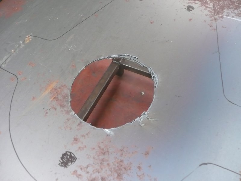

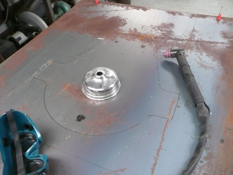

I managed to get a bit done early doors and at lunch. Here's that top marked out. I was looking for an internal circle as a template for the plasma so any mistakes are in the waste but could only find is this external circle, i.e. an old shower head
I haven't had a lot of practice on the plasma, and made a right mess of it, but it's under the press so not seen.

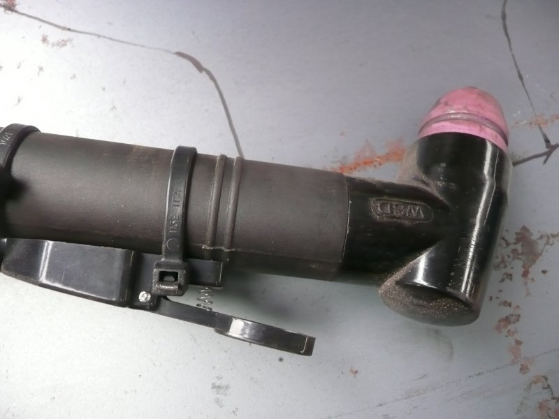

I couldn't seem to keep to the template, I know the trigger on the torch handle swivels around and is a PITA but this time it was the head. It was loose on the thread, next time I will check it - doh!

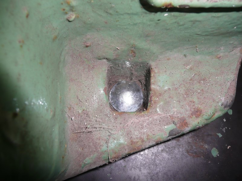

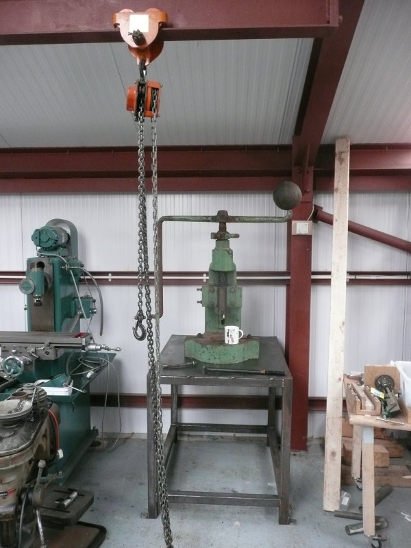

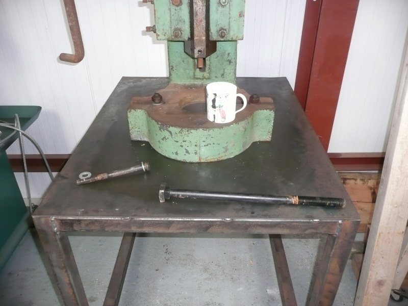

Here it is, all finished for now, I drilled some 19mm holes to fix it down with the mag drill.

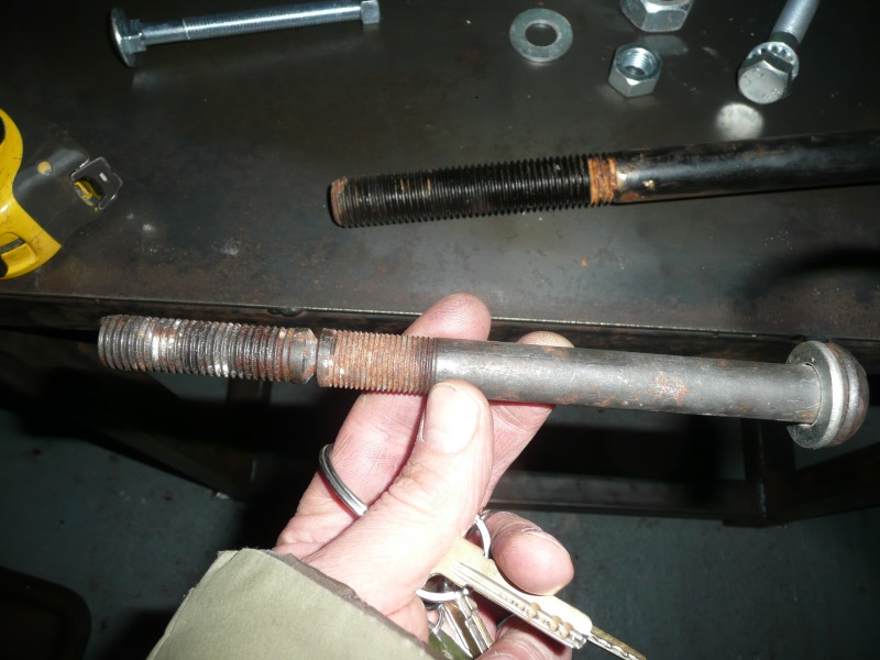

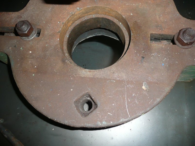

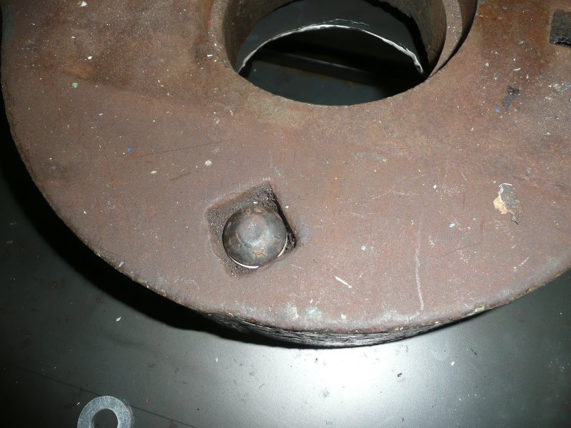

I wanted some square head bolts, I remember seeing some in the downstairs barn. A bit big me thinks, they were from putting the columns onto the foundations of the barn.

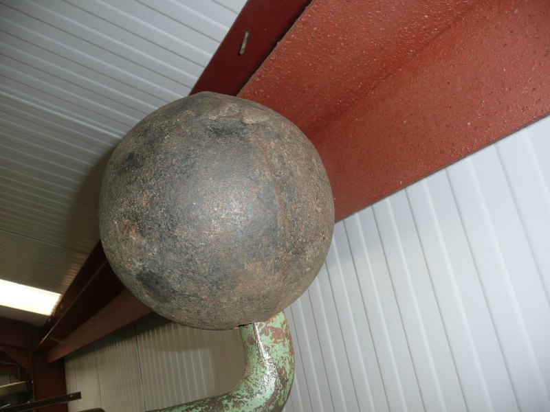

The ball just missed the beam when at its full height.
