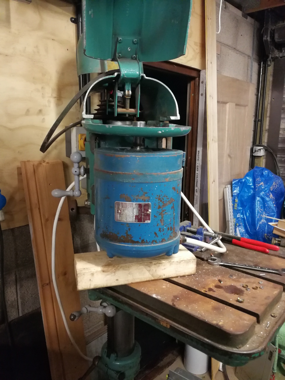

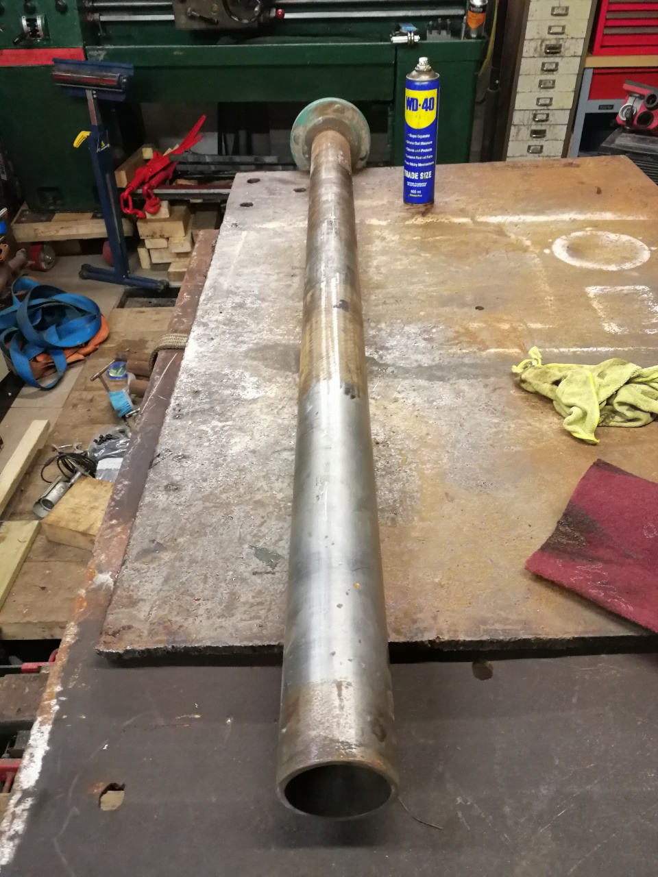

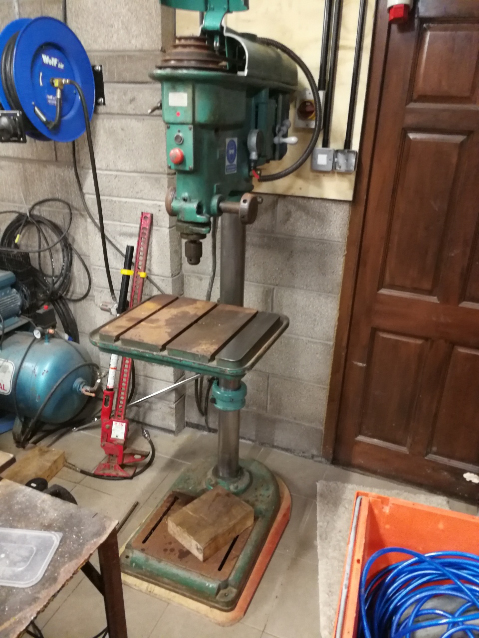

Bought this a few months ago and thought it was about time I made some progress with it

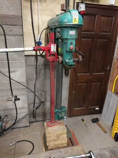

It's an ex school Fobco Seven Eight with the large t slotted table and 3 phase motor. Underneath the grime and surface rust it's in surprisingly good condition.

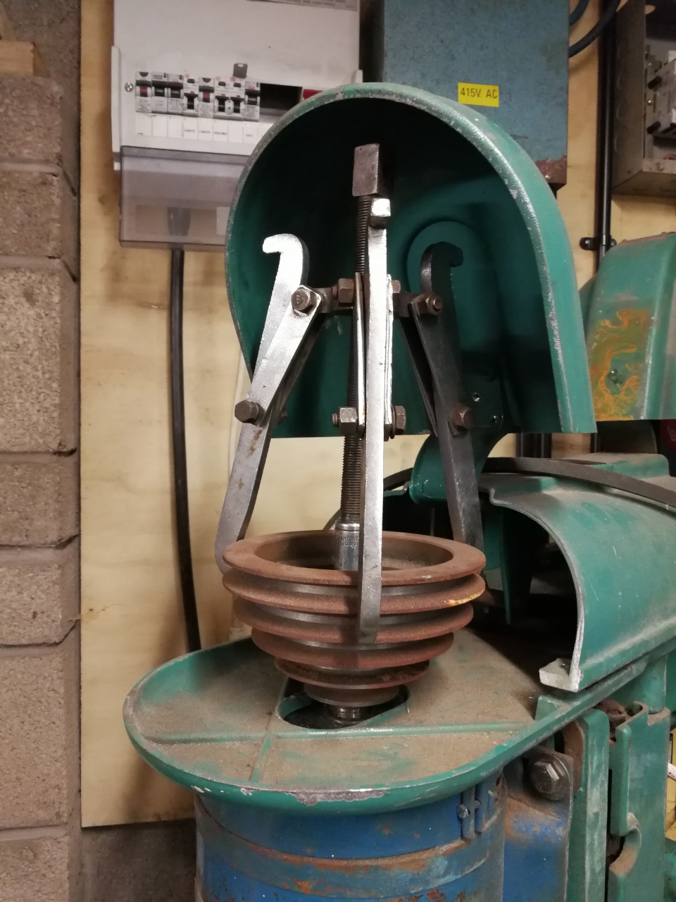

I had to dismantle it to transport it home and while it was apart I did clean up the column with scotchbrite and WD40 which now looks pretty good and then reassembled it
High lift was needed to lift the head up from the bottom of the column as it's bloody heavy

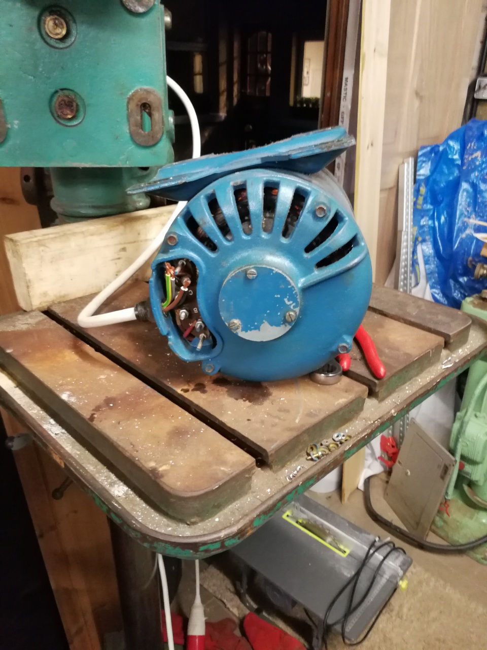

Tonight I made a start on the electrics, wanted to make sure it was safe and fit a new power cable with 16A commando plug

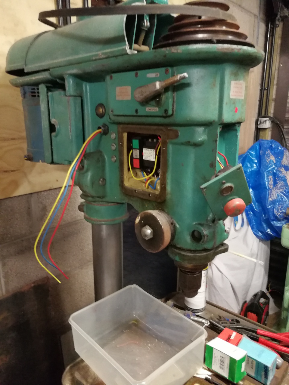

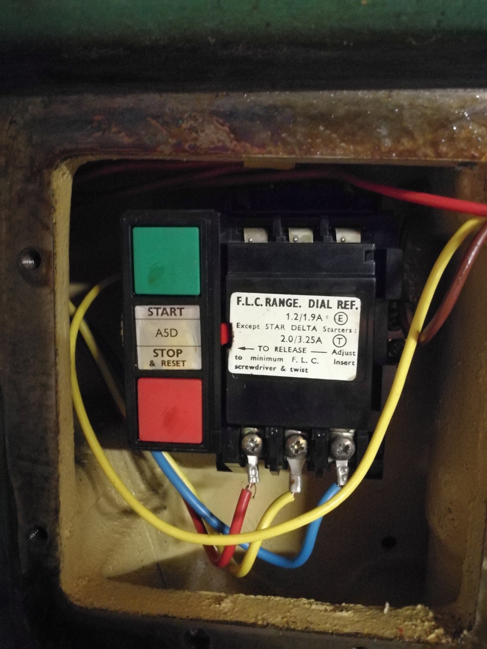

Popped off the side cover and discovered some modifications
Looks like it's been wired in while still retaining the original front mounted switches
