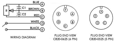

I recently bought a very nice, barely-used Tec-Arc TIG216i AC-DC, and want to adapt a generic pedal to connect to the 5 pin XLR remote socket. I need to know which pins to use for the switch & potentiometer etc. I've emailed Tec-Arc three times to request this information, but no reply is forthcoming. Maybe they're closing down, or they don't care about second users.
I've seen comments from people who worked it out by trial and error, using multi-meters, logic probes etc, but I'm not at that level of expertise and it feels scary to connect wires 'to see what happens'. I'm hoping that someone has done this with a Tec-Arc and can help me out, or better still if anyone has a wiring diagram for the TIG216i AC-DC?
