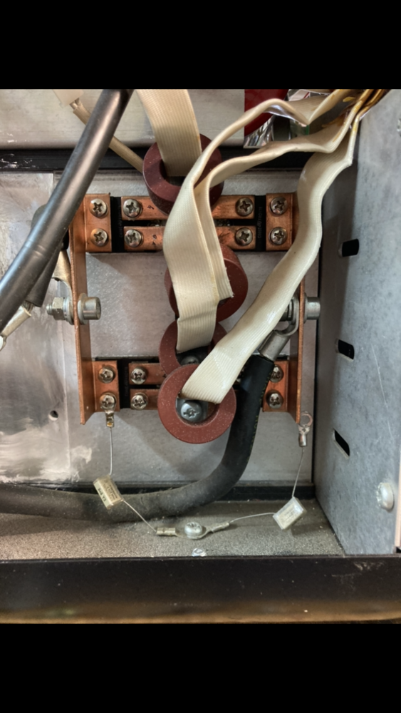

Diodes arranged on the right side of the machine.
Easy to test with Multimeter in diode mode.
Unfortunately these diodes are not easy to acquire.
Some sort of ultrafast is needed like STTH20003tv1.
Good practice to change them all.
But first of all try to find out if one of them is short.
If so you can cut out one leg of the broken one and test the machine function. But not in full throttle.
I've tested diodes today and one diode was short. Then I cut the leg and tested welder.
It was working again. Must order new diodes asap.
Thank you guys for help! I appreciate it!
