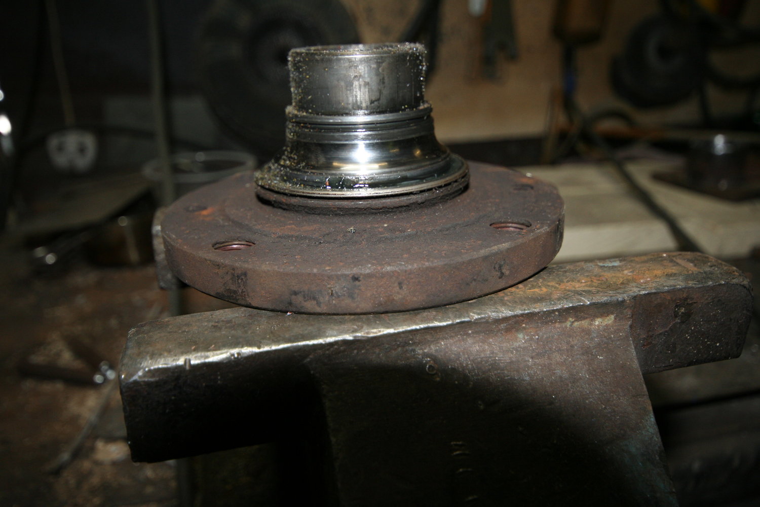

I'm changing a front wheel bearing on a Fiat Bravo and it's all pretty straight forward.
However, has anyone any tips for getting the inner race off the hub?
I normally just put a run of stick around them and they fall off but these are very tight.

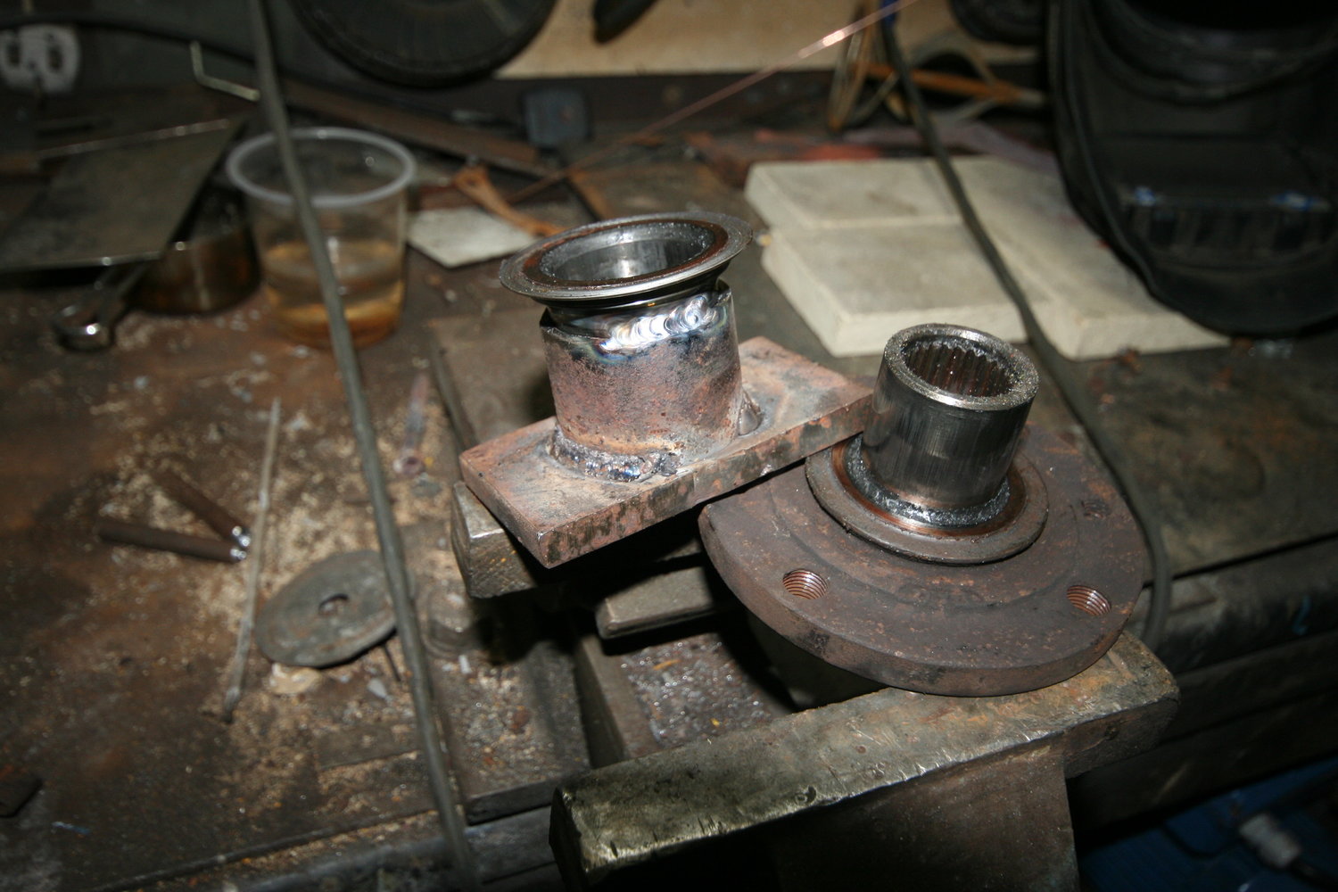

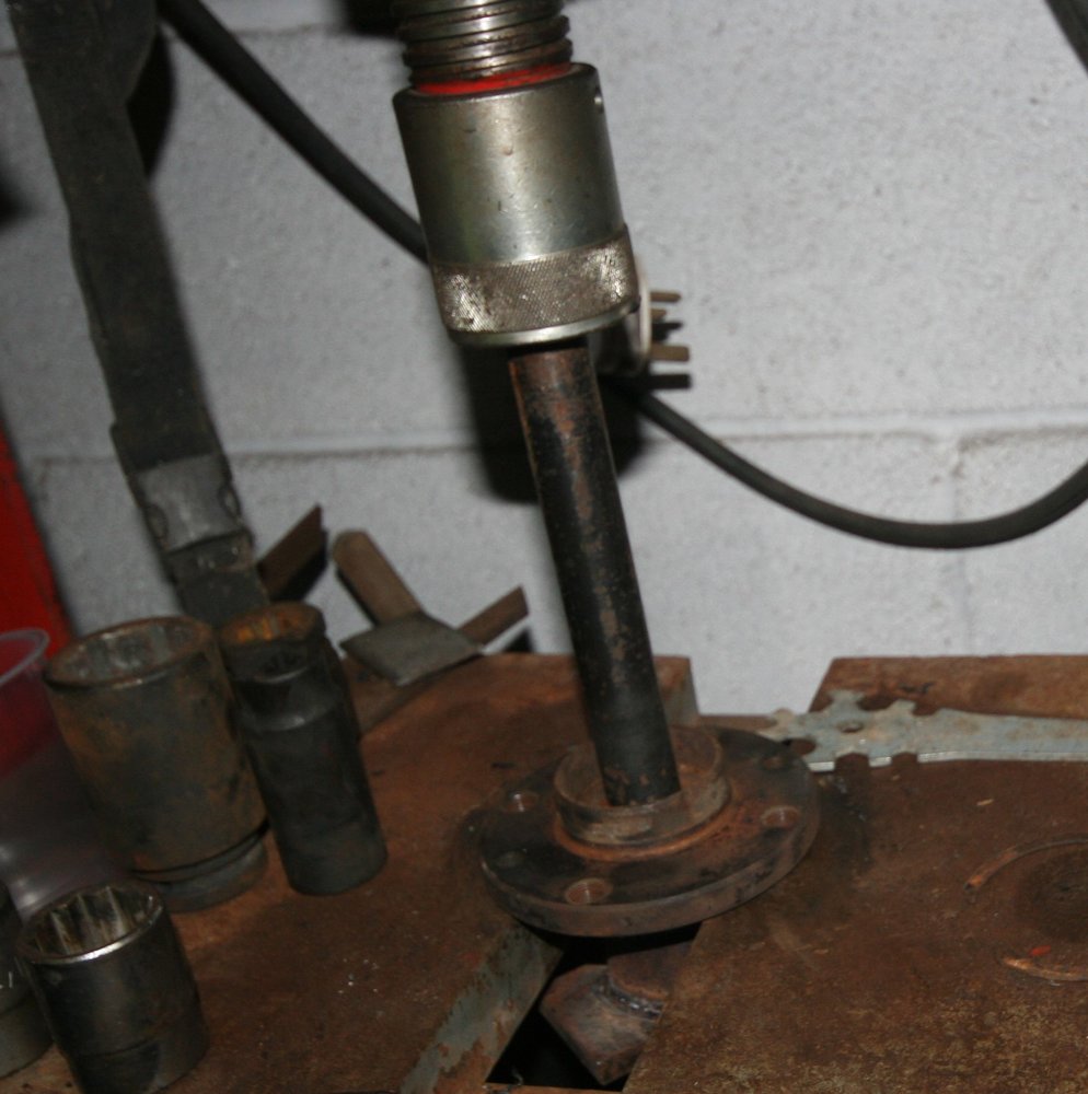

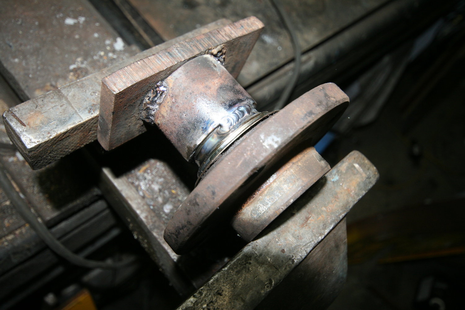

My method was to weld a short section of pipe with a closed off end to the race.
Then drop a drift through the driveshaft splines and press it off.
It worked well, but there must be a easier way that doesn't involve me looking for bits of scrap the right size every time I need to change one.
