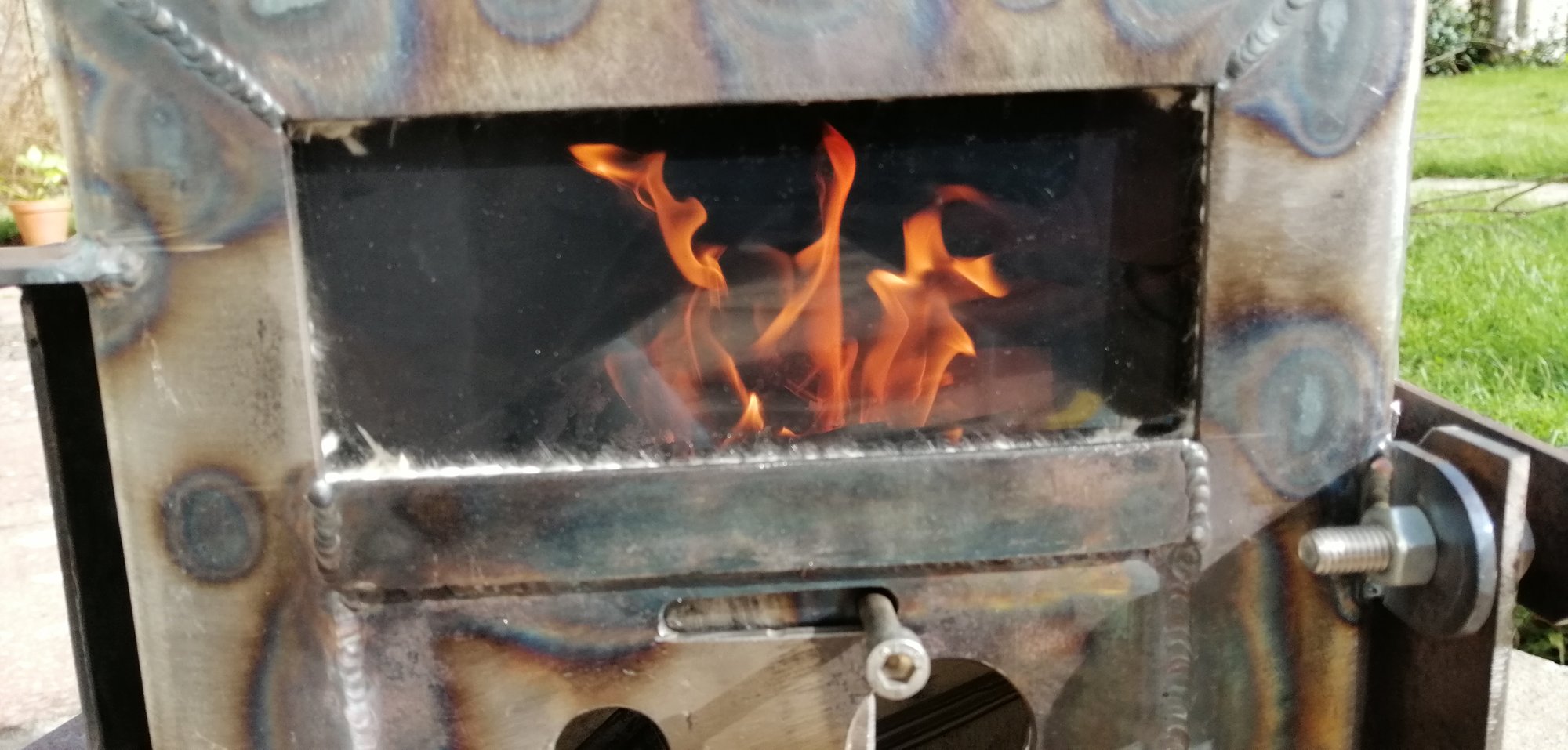

when primary air is heated it makes your stove even hotter than just direct air entering the stove from above or infront in your case
on rocket stoves certain models use primary air heating and then secondary air heating
lowering the flow makes it even hotter as the primary air has more time to heat up
note the orange colour within the flame the more orange to blue/purple the flame is the hotter the system is

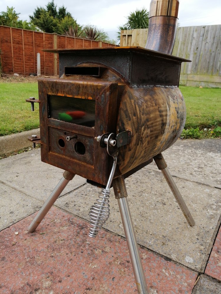

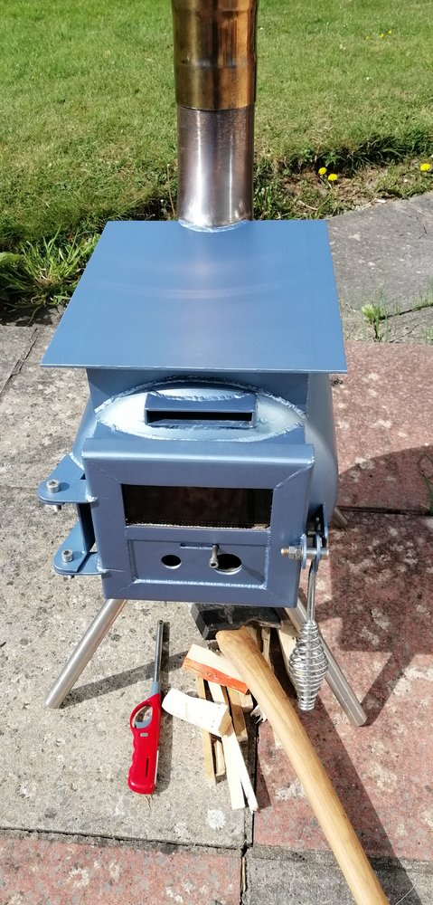

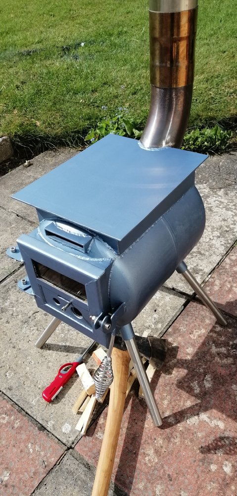

Nicely done.Now painted. Give a a couple of small fires and then one big fire to cure. Really pleased with the result as I am no painter!
View attachment 344395 View attachment 344396
