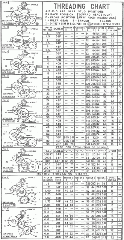

I am looking for a gear cutter to make some change wheels for My Harrison Lathe
The size I need is a "14DP to cut 63 teeth" I belive it is the number 2
