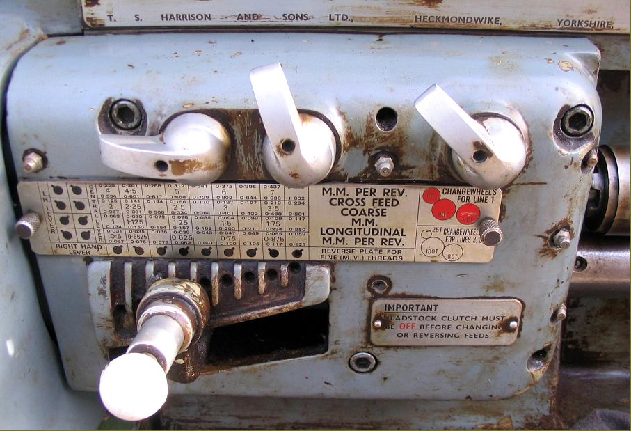

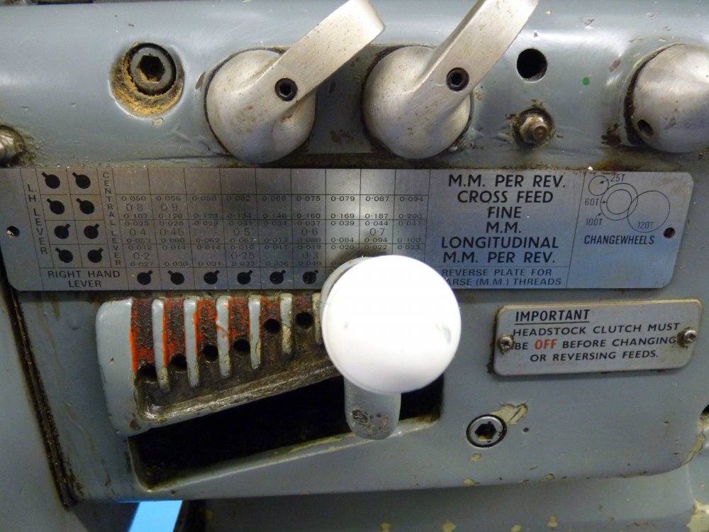

The Harrison Lathe both myself and John (doubleboost) have is the 140 Model with the 36 speed Norton gearbox, easily identified by the 3 selector knobs on the gearbox. The Lathe is an all Metric machine, Dials and Harrison screwcutting information plate are all in Metric.

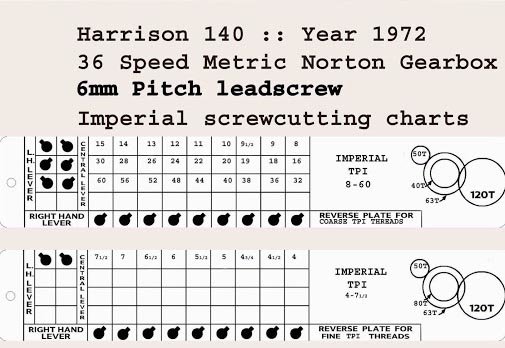

The introduction of the 63 translation gear allows the gearbox with the correct changewheel set up to cut imperial threads, with a range from 4 to 60 TPI. To cut this whole range, one changewheel needs to be swapped on the train. So basically 5 changewheels will cut the 4-60 TPI range, although only 4 are in use at any one time.
