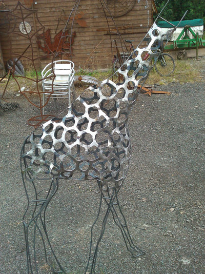

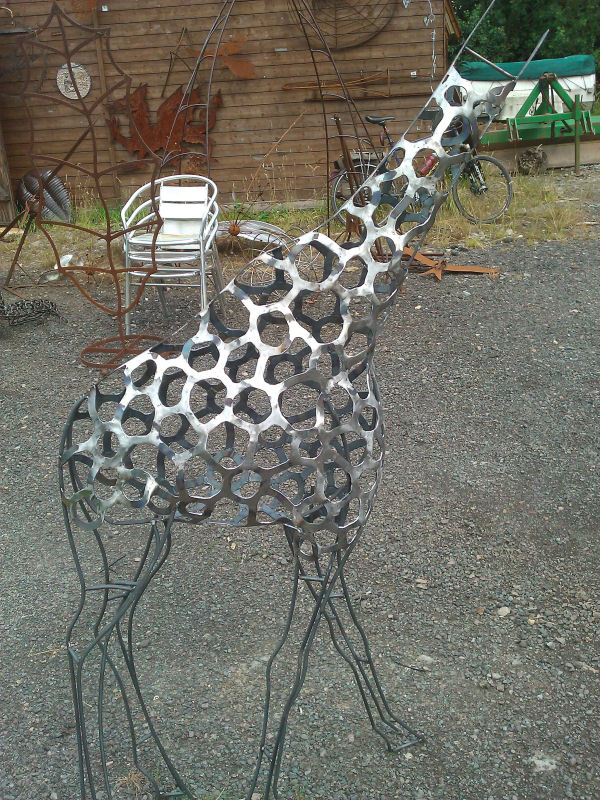

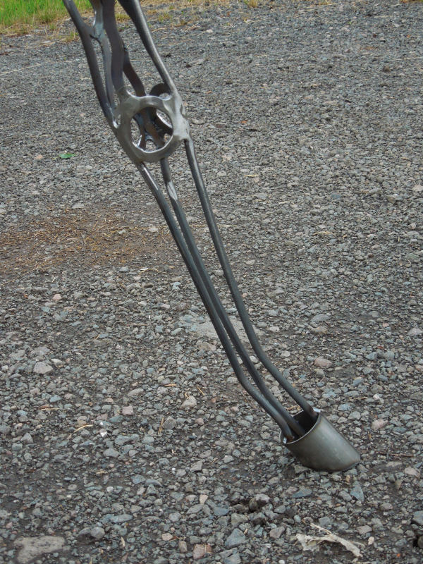

The body is made of 15x3mm strip. Ni.ce stuff to work with.
The legs are 8mm black bar, not sure how to integrate the two sections but I a sure it will do it itself.
Blackboard? 8mm ply, joined in the middle with those weird star backed washers used in furniture making. 1 coat of primer, two coats of blackboard paint. A third coat needed after this job.

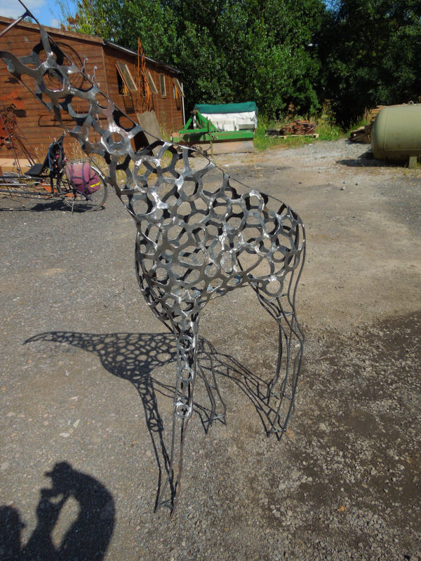

Customer wanted the legs changing, front legs side by side.
I confess to getting stressed by this as I was well pleased with them.
Took my time, sent him another photo and he has changed his mind.
Delighted. Modding them would have taken maybe an hour or less; so no problem but they look so damn right.

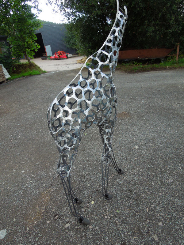

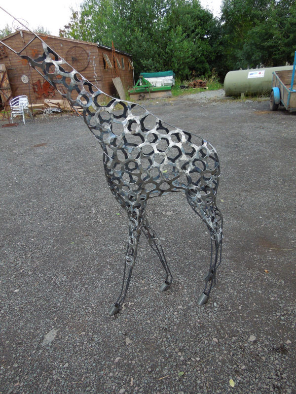

Finally had a bit more time on her today and yesterday.

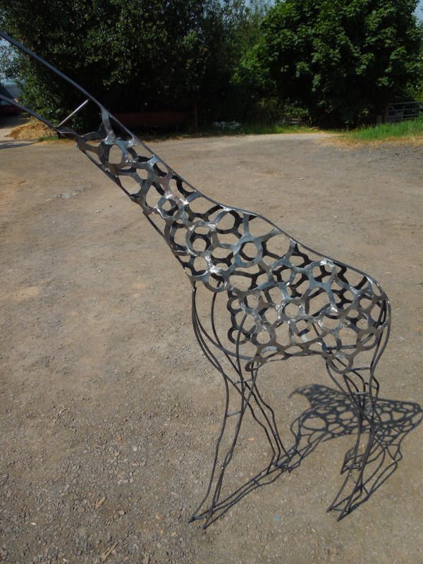

Filled in most of the body and got the welds cleaned up.
A happy chappie.
I am finding it hard to stick with my plan of not controlling the pattern, but the idea works. The rings are stacked up and just take the top one and fit that, and no arguing. I think if I started playing around with them to get it 'right ' it would spoil it.
Am I finally breaking my symetrical habit?
Next stage fill in the rest of the torso, then get some narrower strip for the legs. This comes on Monday, then the head.
