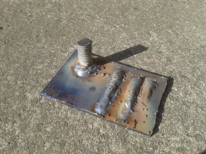

Still not enough gas mate, notice the hollow weld to the left? Thats porosity. Is it drafty where you are welding? Also it could be the angle of your torch. Hold it 45 degrees from vertical and keep the torch shroud as close to the work as possible. One thing I learned from here is what one experienced welder said.
