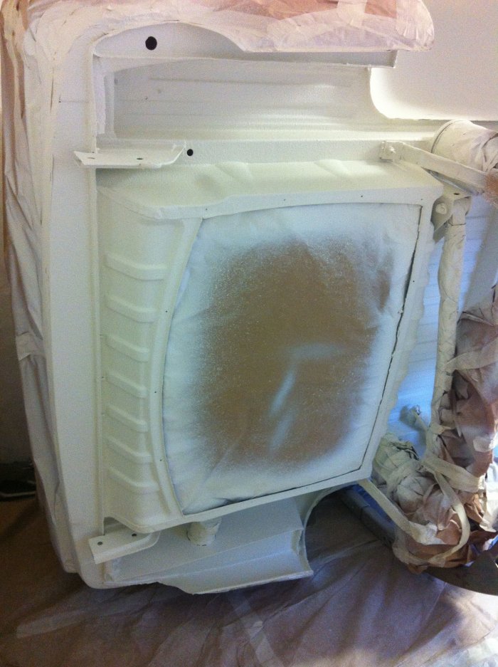

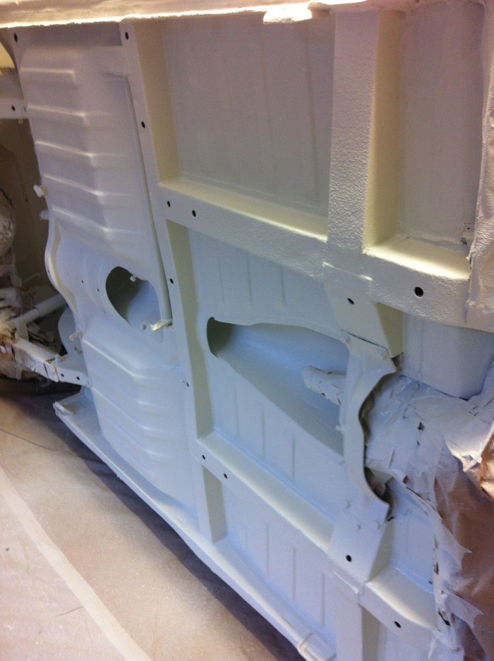

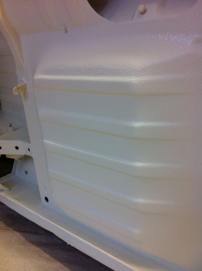

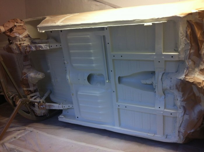

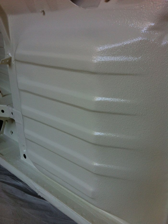

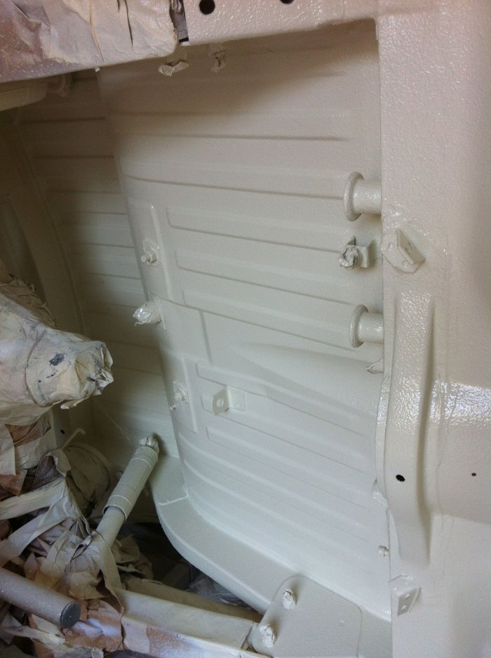

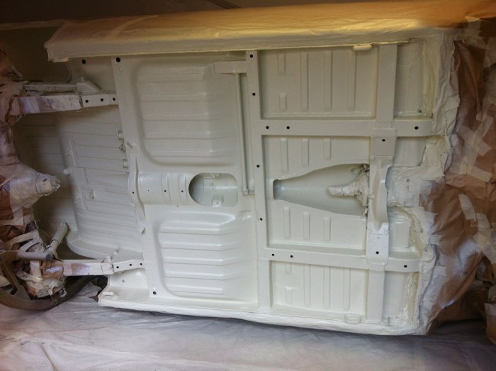

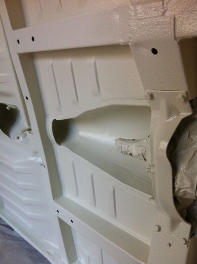

Well I have painted the whole underside of my mini with gravitex and will be over coating it in body colour shortly.
How's it look? Any chance of posting a pic?
Finished the epoxy mastic layer (apart from areas around the axle where I can't get to at the moment) and tiger sealing of the painting on my Volvo Amazon estate but still dithering in typical me style over if I should paint the whole underneath with Gravitex or just the arches. What is the general consensus? The car won't see winter roads, isn't a daily drive but I want it to be hard wearing but still look the part and am overpainting with body colour 2k.

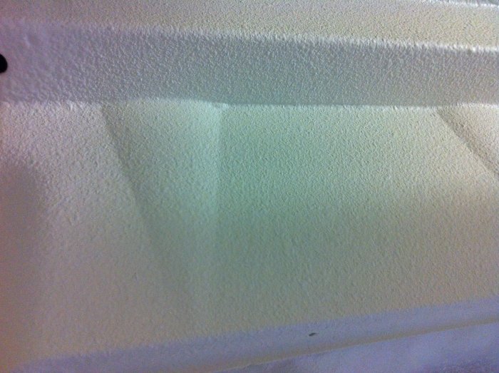

Says on the Gravitex bottle that for orange peel use this type of gun and for smooth use a 2.5mm gravity (I think it is) fed gun. I'll go for the orange peel look so at least that way you know it has anti-stonechip applied as I thought if going for a smooth look and it doesn't turn out very good it will just look like a very bad spray job.
