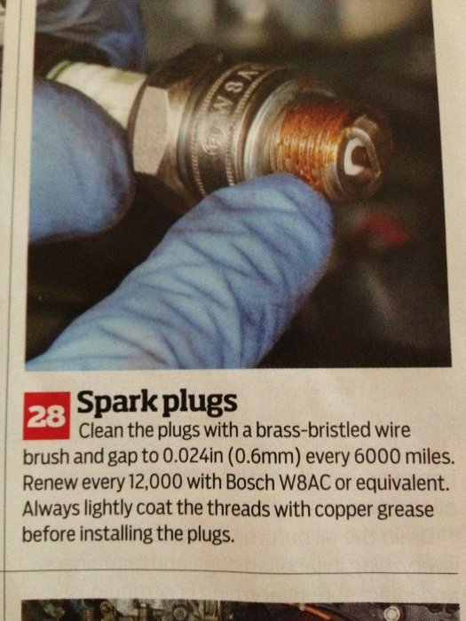

I was having a good look through the 30+ tins of grease left in the garage by the previous owner and it got me thinking. I don't really know which grease goes with which job.
I used copper grease on sparkplugs until being told only to use graphite grease on aircraft plugs because the manufacturer specified it. This is just one example.
Does anyone know of a good site to explain the differences and thus purpose of the various generic grease types?
Copper, graphite, LM, red rubber, etc etc.
