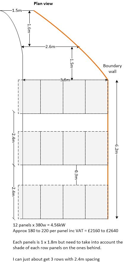

The wife has identified a small piece of land that she doesn't want to cultivate. The good thing is that its bang on south facing. The bad bit is that its a bit of a pig to get to and its next to our boundary. its also a bit small, ideally I would have liked twice the area, but we have discussed this at length. It was the site of the old Calor tank and wouldn't be used for anything else, so its a good use of a rough bit of land.
I'm not going to discuss planning on the forum. This may prove difficult and I would rather French kiss Liz Truss than go through this with our planning department, let's just say its not permitted development and leave it at that We have told all the neighbours, and none have an issue as long as they are camouflaged a bit.
Here's the rough site survey. I'm going to do more detailed one once I get the strimmer out.

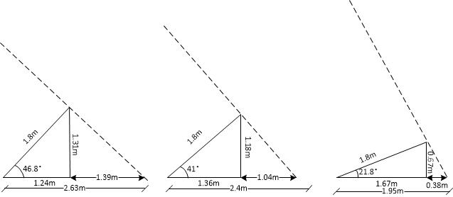

As per the text in the pics, I'm going for 3 rows of 4 panels. I need to make sure that I don't shade the panels behind so worked out the max angle I can tilt at is 41 degrees from the horizontal.
This assumes the panel is right on the floor, no gap, in reality there will be a bit. I'll rerun the calcs once I've done a better survey with a longer tape and somebody to help.
The height is important as I have promised the neighbours that they won't be much higher than our boundary wall. about 1.2m should be fine, the wife is thinking of adding a bit of trellis to make sure.
I'm thinking of making this a manual tilt system. So, I can adjust the angle of the dangle every couple of months to improve efficiency. The next thing was to understand the best angles at different time of the year.
The rule of thumb is the latitude minus 15 for summer and plus15 for winter, So between 38.7 and 68.7 degrees summer to winter.
A supposedly better method is during winter, multiply the latitude by 0.9 and then adding 29°. this gives 77.36 max angle. For summer, the tilt angle is calculated by multiplying the latitude by 0.9 and subtracting 23.5°. this gives 24.86 max angle so a much wider range, 23.5 to 77.36 degrees.

Using the above, my max angle of about 41 degrees means I would only be suboptimal for 3 months of the year. I'll do a bit more reading on this one, I don't like when stuff like this differs from the site to site
