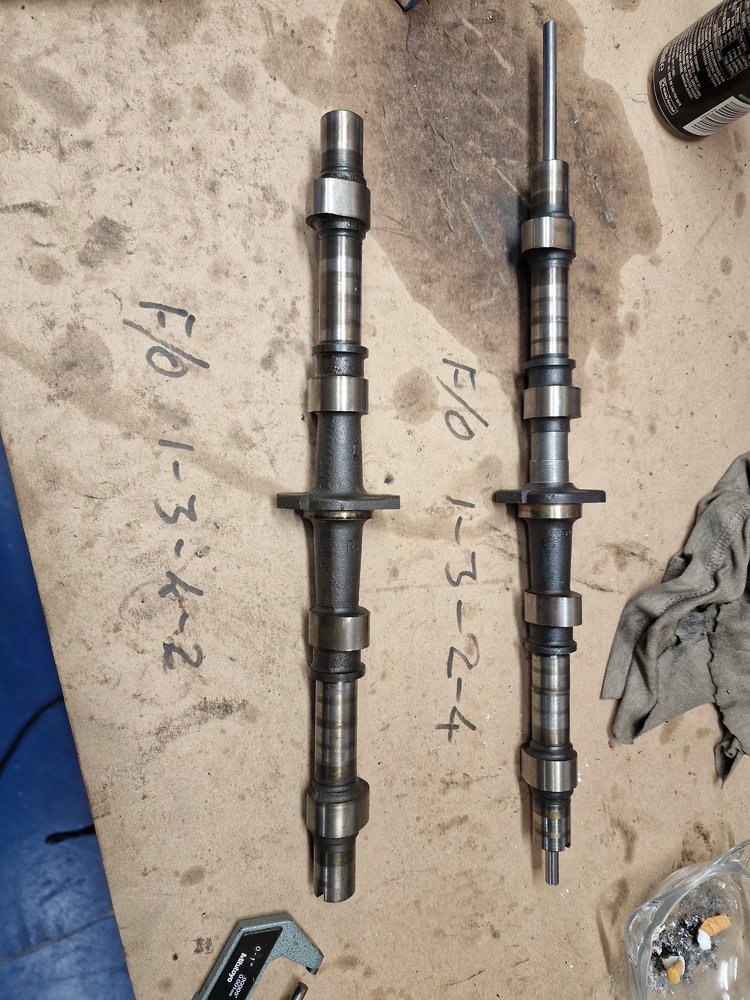

Cams have been cut by spark erosion as it only removes 0.3 mm. The pieces were then drilled and made into a camshaft kebab so that I can set them up for the new firing order, mark them, then they can be bored pressed onto slugs and pinned.

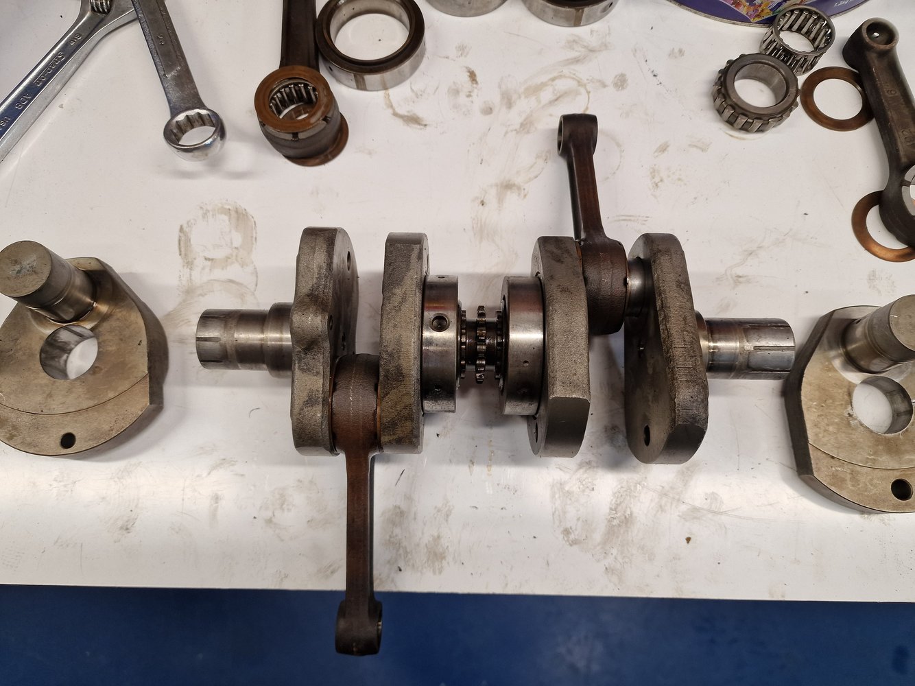

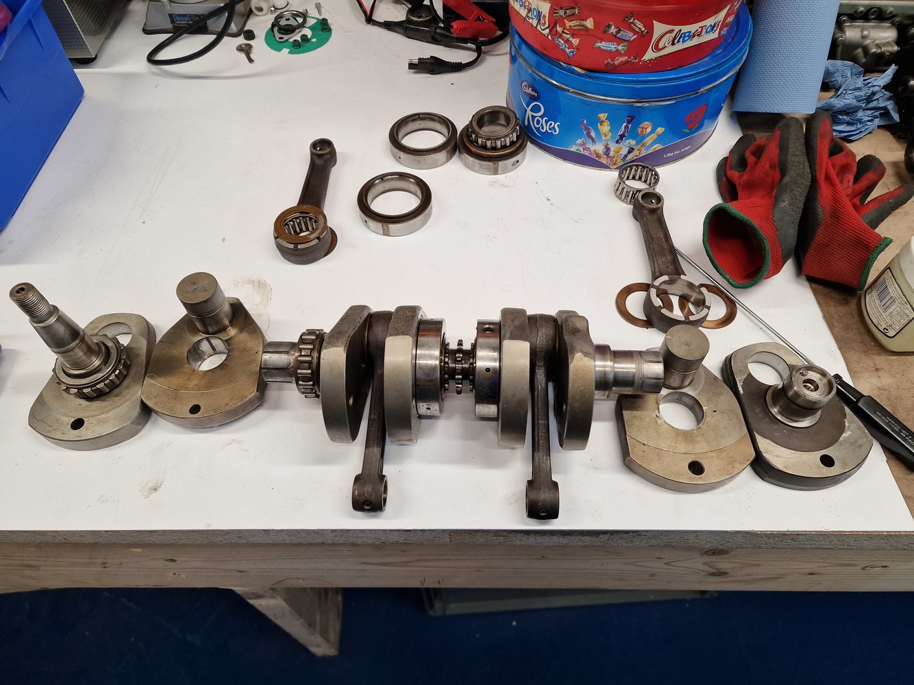

Crank pressed apart, and then reassembled in cross plane configuration.

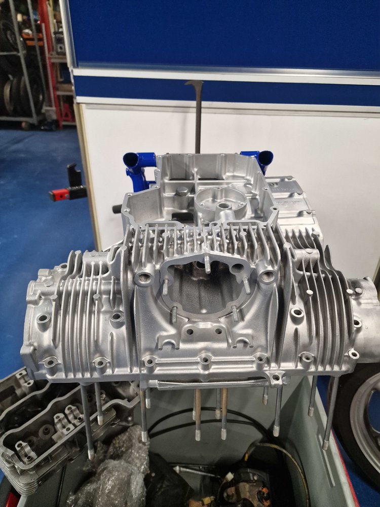

Cases vapour blasted ready for assembling into.
