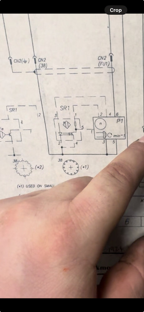

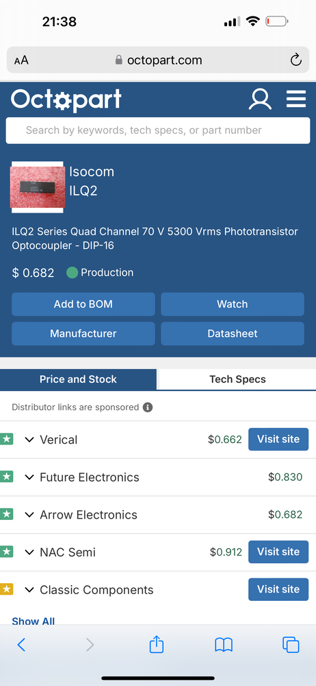

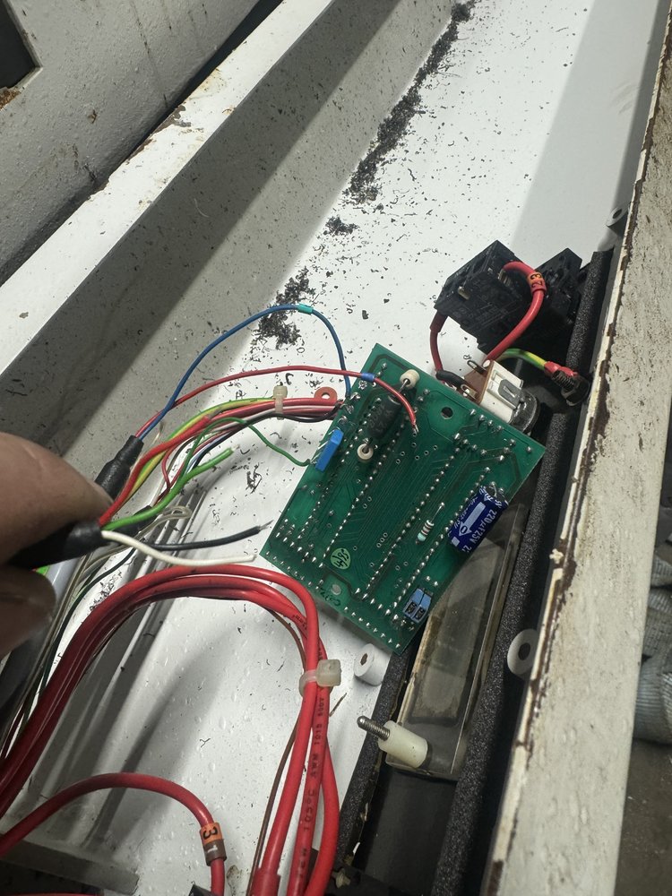

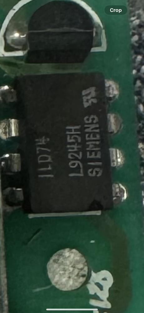

I think something like this would be a close relative of the part spanning the slotted disk:
See if it has a part number or manufacturer on it and you will find a datasheet telling you what its output should look like.

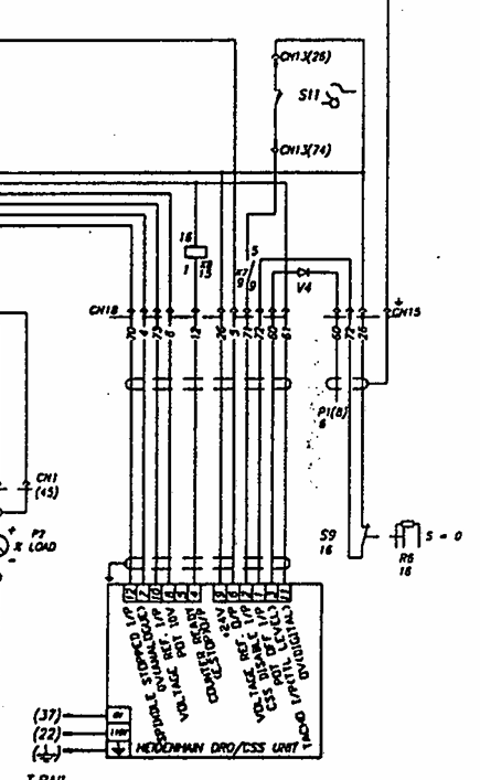

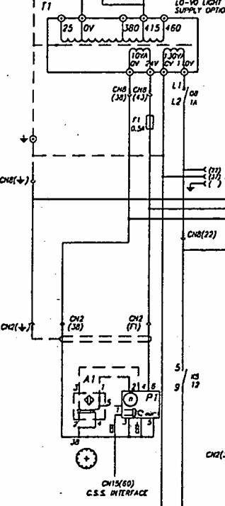

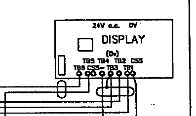

The wiring is bottom right of diagram on p.44 of manual above.
It should be simple to verify that one: give it power and when the light beam is through a hole, it will register an output. When the beam is blocked, it won't.

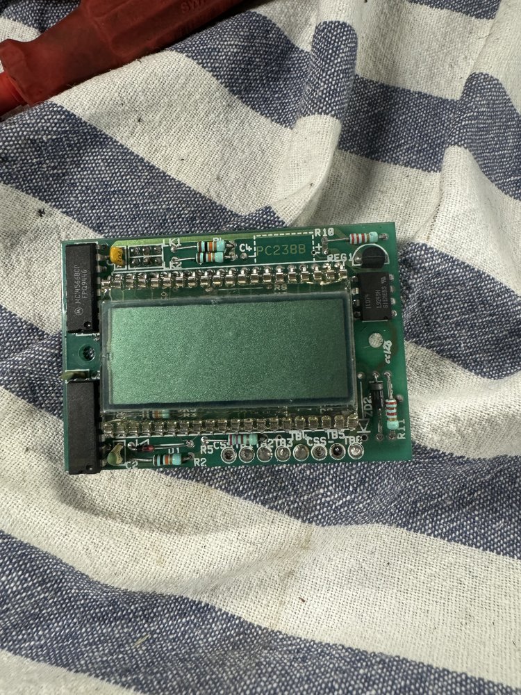

To make that work exactly as is, you'd need a tacho that has a configurable number of pulses per revolution. A lot of the cheap ones only work on single ppr and that makes the display a bit vague at slow speeds because it is a long time (in computer terms) between seeing pulses
At very worst, you might have to make up another holey disk with fewer holes in it.
