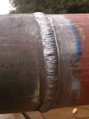

That's interesting.
It could be that the rest of the structure is contracting or moving when welded and putting too much stress on those particular welds, causing the cracks.
put a prep on the plates,looks like a square butt with no gap and your grinding all the weld off.also overcord does have a slight course finish like vodex(compaired with other 6013s)
Have a read at arc welding tutorial (link at top of page) you will find plenty info there covering various aspects of arc welding, including joint preperation.
