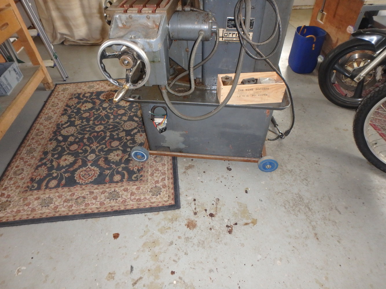

I needed to find a way to get the mill off the pallet it came on and move it around easily. Below is my solution. I hope you find it interesting.
Nice job!
I am lucky I have a forklift and a huge real 4 ton lift engine crane.
I tend to leave most of my stuff on pallets though - as I always have to move them around. An electric pallet truck is a Godsend.

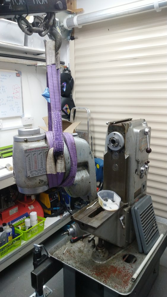

This week I removed the vertical head from my machine.
It was relatively straightforward. I used my engine crane. The head balanced nicely. At first I thought that the spindle forward bearing housing was being used as a locating feature for the head. It isn't though.
There is a dowel on the head and a corresponding hole on the main body of the machine that serves this purpose.
For some reason, the dowel seems to have been withdrawn at some point in the past and not reseated.
