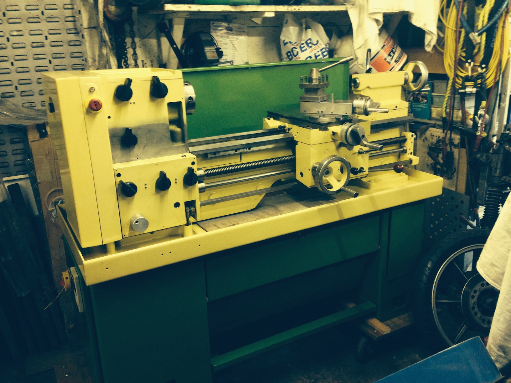

I've reproduced most of them the speed chart has been on there for a few yrs now> It wont cone as much surprise that 600 Group want stupid money for the plates. I intend on reselling them at some point

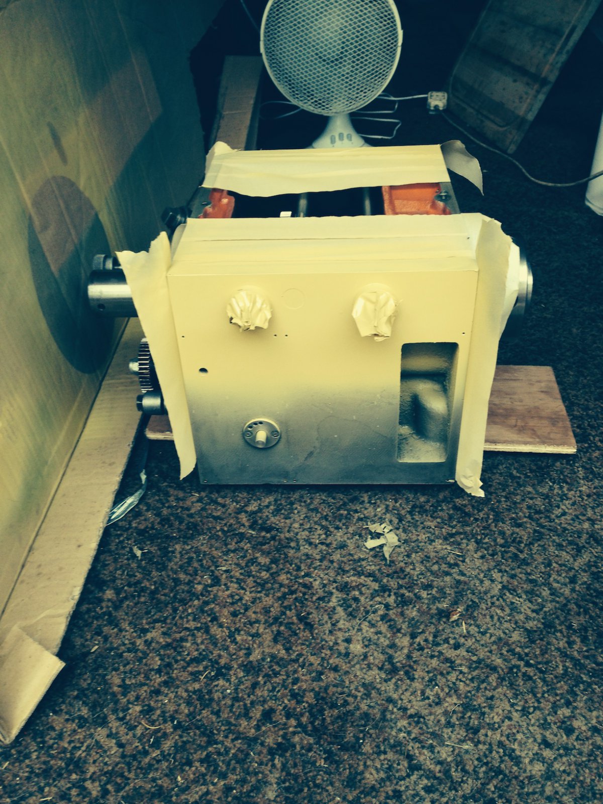

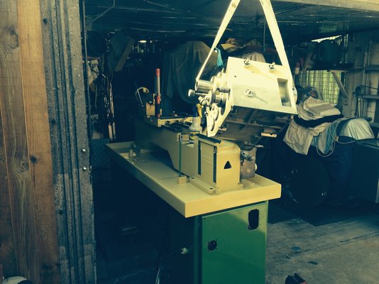

Hmm could have a small problem I took the 1-8 selector knob off and took the gear(to clean the rust off) out I made witness marks on the box and the holder body but DOH! didn't pay attention to the position the gears were in. Now iv put it back tougher and the witness marks and grub screw marks all line up, but don't know if its selecting the correct gears to the correct number.
Any body know which position the gear should be in to equate to position 1.
Long shot I know and I'm a dumb ass for not checking the position the gears were in
Thanks
