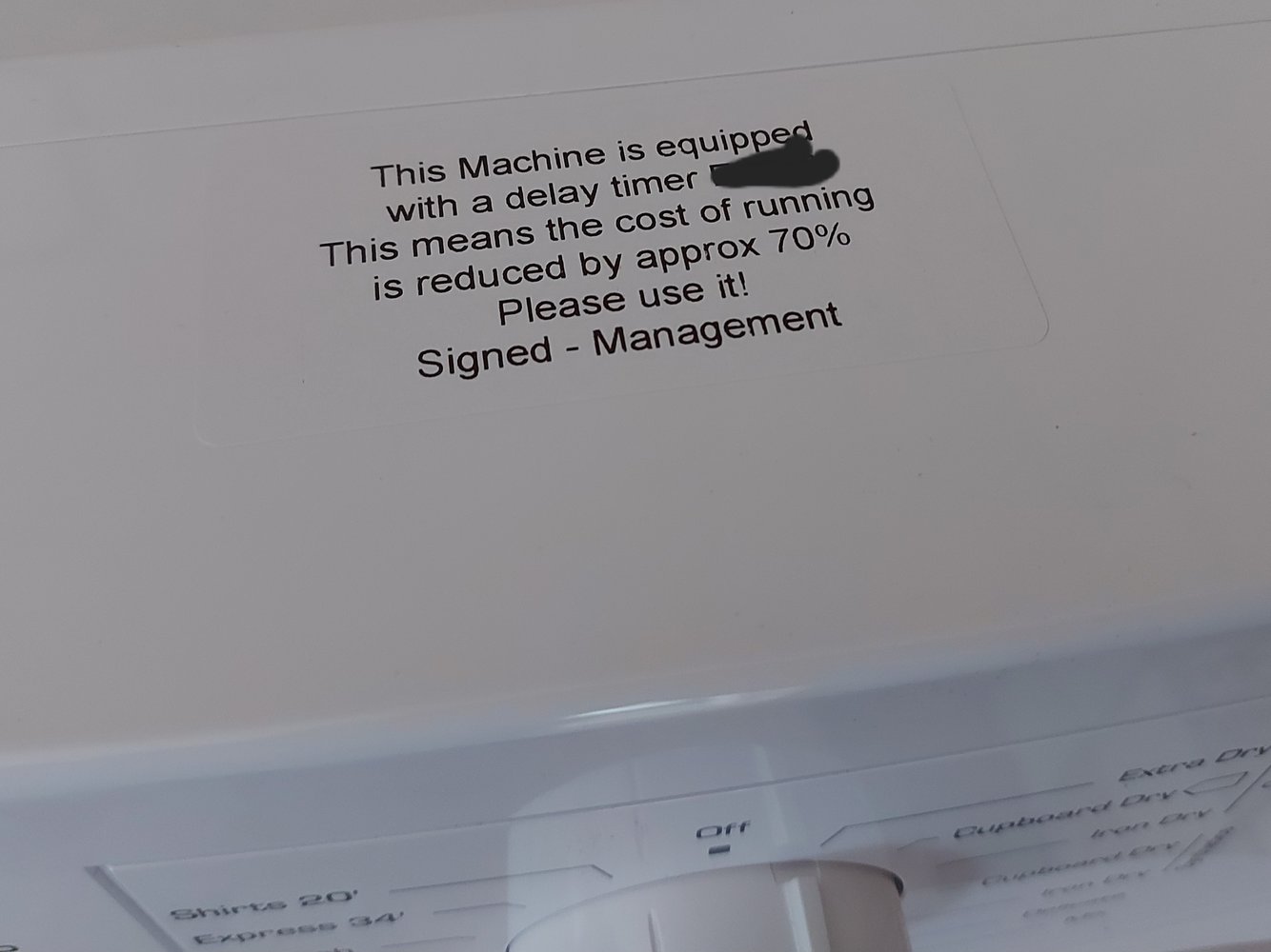

I did also attach a special decal for my other half who thinks electricity grows on trees

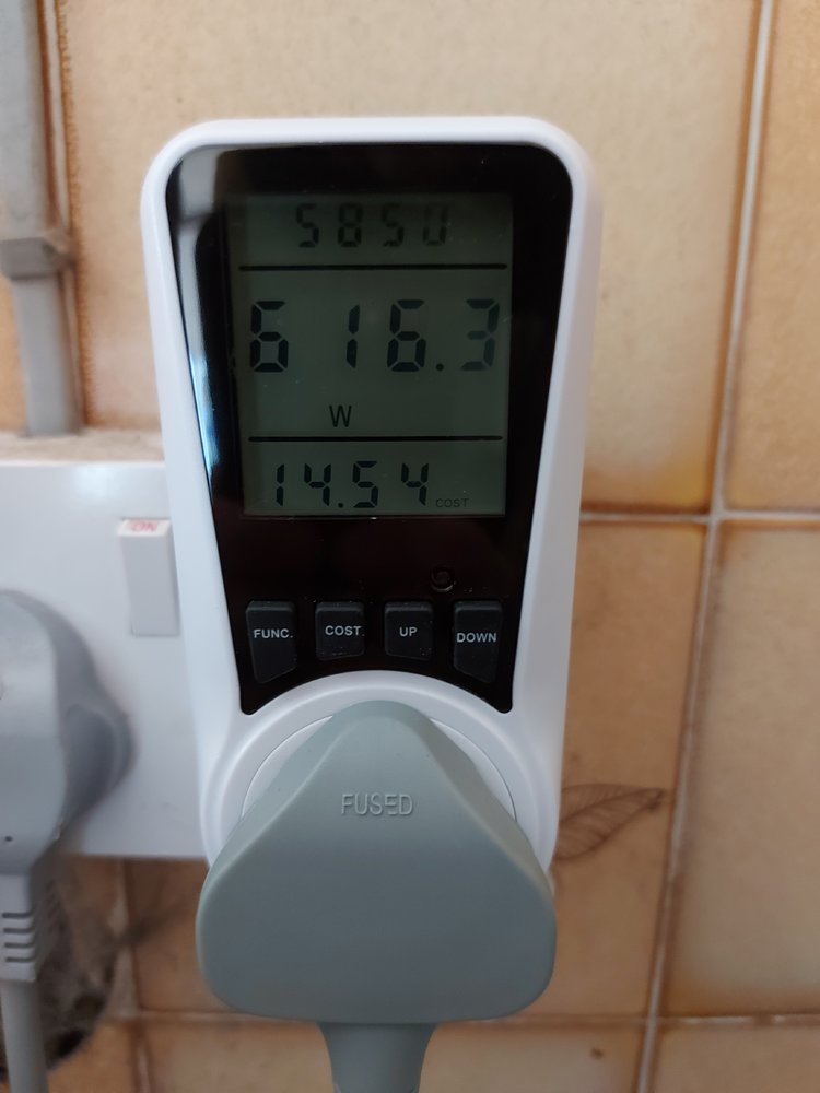

Perhaps you might elucidate on that pic? Tells me nothing, indicates something - but may be irrelevant, anywayRunning a test on the actual power consumption and cost during daylight electricity costs
It tells you it's using 600 watt load. Which is considerably less than a conventional tumble dryer at 3000 - 5000 watt consumption.Perhaps you might elucidate on that pic? Tells me nothing, indicates something - but may be irrelevant, anyway

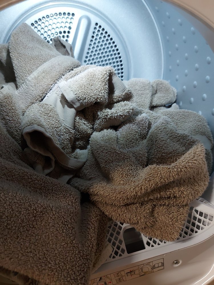

Full Load - Extra Dry Cycle Full dry setting also selected.

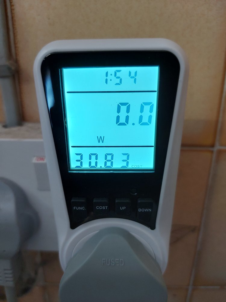

Total Run time : 1 Hr 54 minutes
Power consumed: 1.094kw/hr
Peak load: 706watts
Low Load: 9 watts
Cost to run: 30.83pence. (Based on my tarif of 28.19p inc vat)
Pretty damn good very pleased with that. My Econ 7 cost per load is then about 10p!
