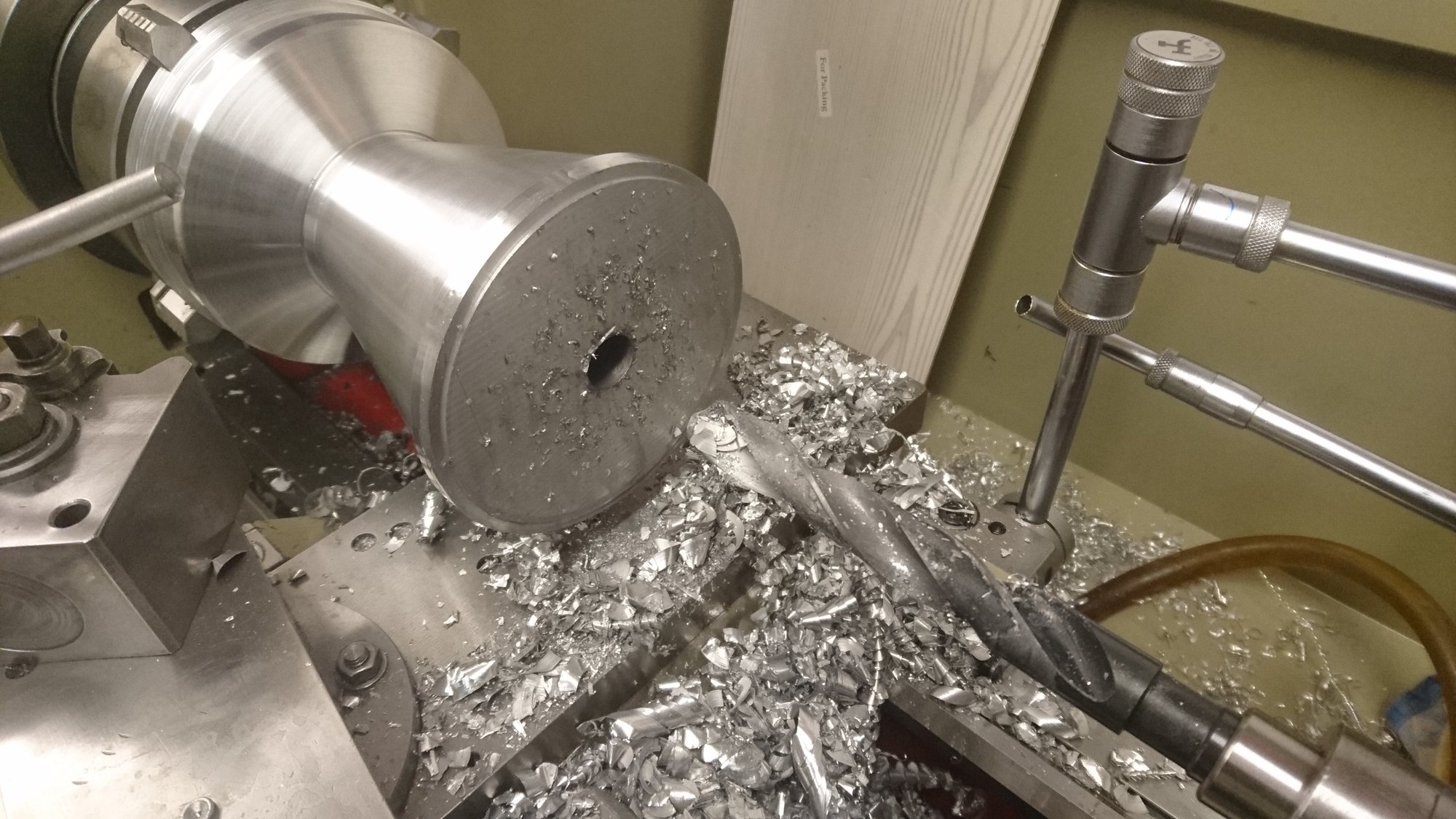

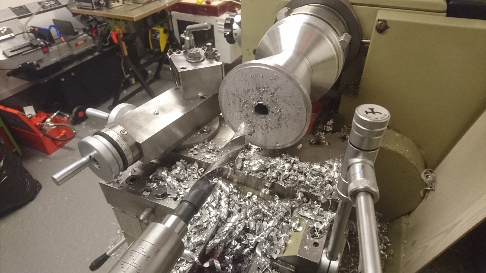

Did some more work on the nozzle today. Some light clean up cuts on the exterior.
Then started the boring out. I put a 20mm MT3 drill right up to the end of the throat section. This meant basically burying it in the part.
I'm not going to do anymore with drills now, just going to get straight in with the boring bar.
