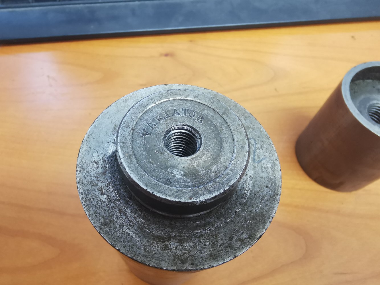

What i'm saying is the taper form is based on the Morse Taper.
The Colchester Triumph has an L1 spindle.

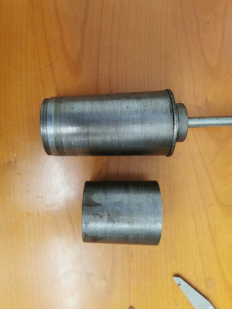

I thought I had MT5, but in fact, it's something else. Lathe chuck of the old American standard, long L1, as far as I remember. The question is, what is the cone? The measurements were carried out on an old worn cone, inherited from a lathe.
View attachment 383061 View attachment 383062 View attachment 383063
If the approximate dimensions are similar to my rough sketch, then this is a bingo.The Colchester Triumph has an L1 spindle.
Luckily I have the original bush if you want me to measure it?

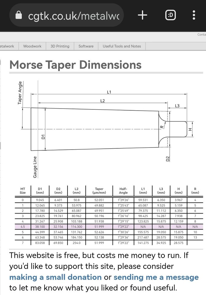

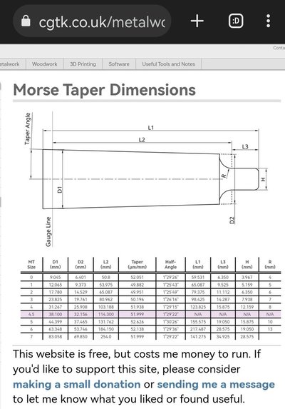

Perhaps Look for a Jarno taper table.
Either way you're unlikely to find the right taper bush, you'll have to make one or send one out for grinding.
I appreciate it, thanks for the link. So far, as I see it, it is possible to regrind the Morse taper in size MT 5/4. Set on the indicator, the turn angle of the tool post to zero. And machine the finished Morse sleeve from the outside, with a grinding allowance. Borazon ( CBN) plate I foundAn accurate way to measure the taper is to measure the internal one in the spindle. Use two balls (bearing balls), one smaller than the other and measure the depth from some flat part of the spindle nose. A bit of maths and you are there.

If the one you show in the photo fits the spindle, dial it in to run true in the four jaw, holding it on the parallel part and then use a clock gauge, a gauge block and a bed stop to work out the change in diameter over a 25mm length.
Blue up the one you have to check the actual fit and measure on the best part. If the surface is rough, place a parallel against it and run the indicator tip on that.
Yes, the error effect changes as you travel the length of the taper, unless you are spot on centre all along.Indicator height (and also grinder / cutter height) is very critical replicating tapers or it can get very confusing !

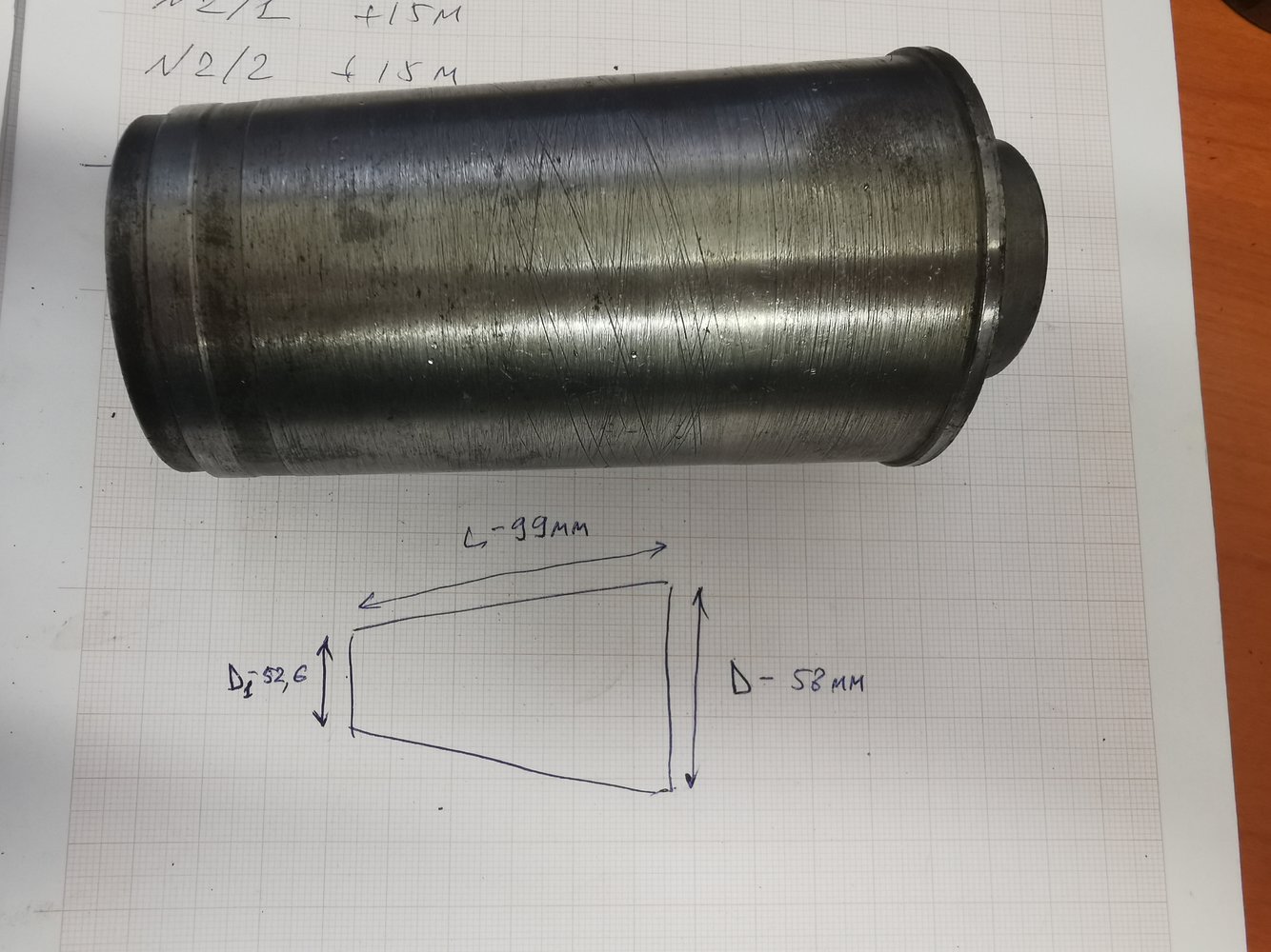

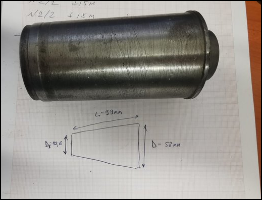

If the taper is indeed american, it will be measured in inches per foot rather than angle. the angles are usually very unusual and not whole numbers.Can anyone estimate the angle of the cone based on my measurements? I don't have a program for this nor the skills. Length L is measured along the inclined side, not along the true length, relative to the axis of rotation
You'll need a bloody big set of gauge balls for that size taper
The figures given in the image below suggest 5.4mm taper over 99mm
