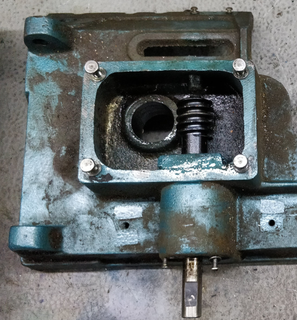

About 8 years ago, I bought a long-in-the-tooth-then battered old bandsaw. It's served me well for those 8 years despite being it pretty shoddy condition for all that time, but I've decided it's time to give it some love and try to sort it out.
As part of that I'm trying to replace the bearings and oil seals (and I'll probably paint it while it's all out). I've mostly got it apart, but I'm really struggling to get the worm shaft out.
The problem is, I haven't got a scooby how to remove it. I'd wondered about using some brake caliper separators, but the minimum spread is 12 mm and the gap between the boss in the casting (which you can just about see above the worm shaft) and the end of the worm shaft is 6.1 mm. I'd also wondered about grinding that boss away, but I suspect I'll want it to be there for reassembly as I can reset the worm shaft to have that 6.1 mm spacing from the boss.
The only other ideas I've had have been coming up with something or other that clamps extremely firmly onto the flat on the bottom end of the shaft and then making some form of custom puller.
Any bright sparks on this forum got any bright ideas?
