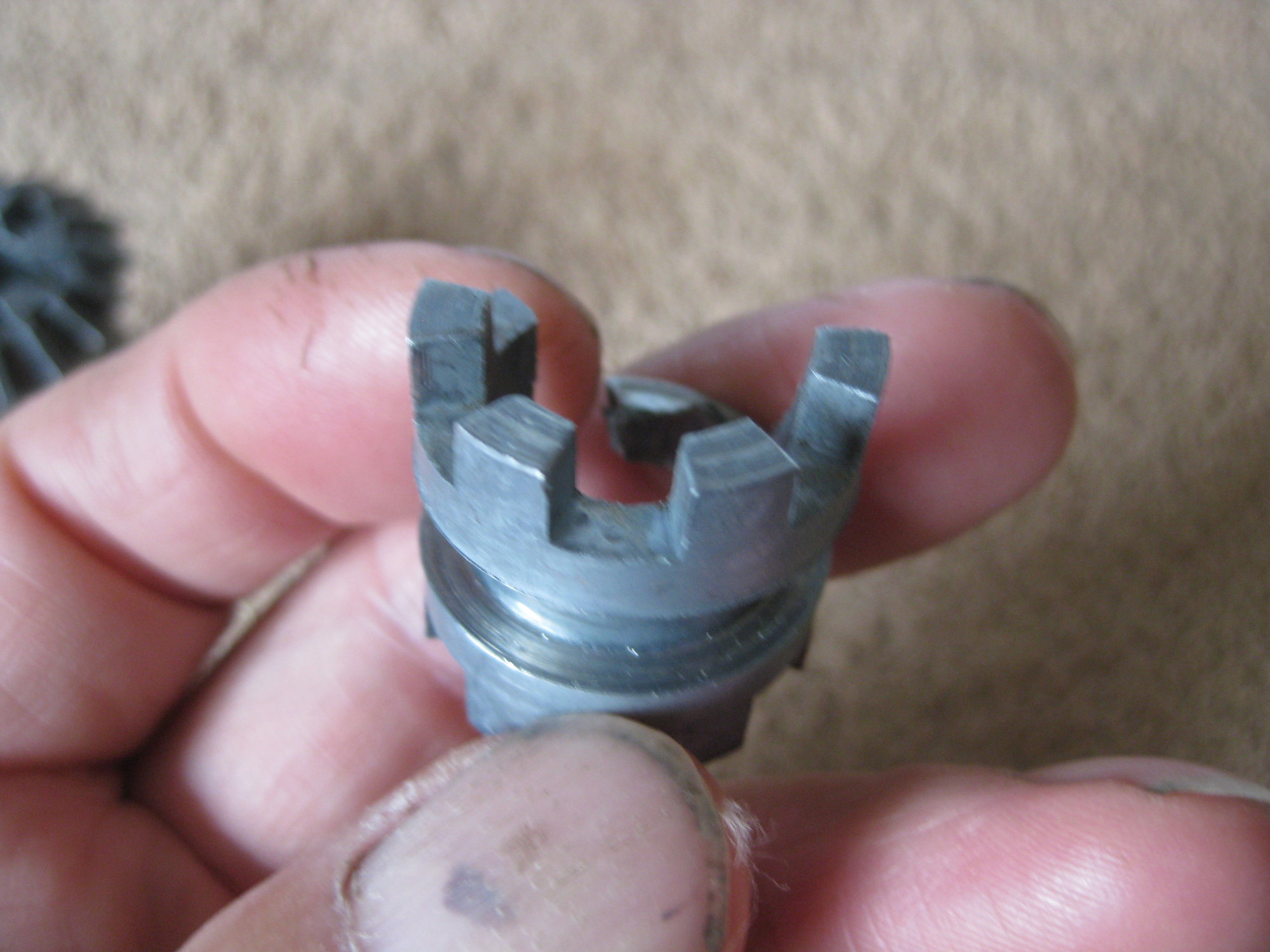

I've bust a selector double ended dog on the forward /reverse change box on my lathe when doing a cross cut under power of the gears . My hand slipped off the pull to stop the drive knob just as it was getting to the limit of the travel . . I want to make one in the same sort of alloy aluminium using the lost plastic casting method. Everything on the lathe is in Imperial measurements.... it's 77 or more years old
I'm having trouble getting the tessellated dog teeth / ends on the sliding dog collet body, they are not parallel cut teeth . They look a bit like the old concrete painted white ordnance survey trig points ( but a hell of a lot smaller with less inclines )
The max dia of the spool is 0.950 thou and the internal through 650 thou , there are six teeth in the same alignment at the both ends of the collet , tooth height is 0.200 thou at each end total length of the spool is 0.950 thou
Now for the bit I'm struggling with , there are six evenly spaced dog teeth with the same gap between them . Outside width of a tooth is 0.232 at the root & 0.215 at the top outer end . On the inner side of the tooth a root 0.188 thou & 0.1175 thou at the top end . So basically the teeth are tapered equally going back and also equally tapered vertically to allow an easier feed in . the top & bottom of the sliding dog collet are flat like a cotton reel
Can any one give me pointers how to go about doing these tapered dog teeth please in Fusion 360 ? I've been thinking it may be a three part design that get glued / fused up after printing
Initially I thought I'd be able to turn one up on the lathe but the taper angles of the teeth to such fine tolerances are not re-produce able on my lathe with the kit I've got.
