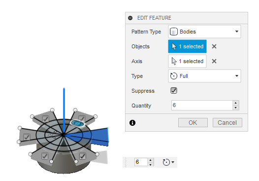

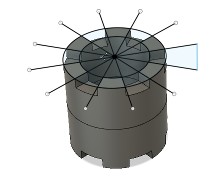

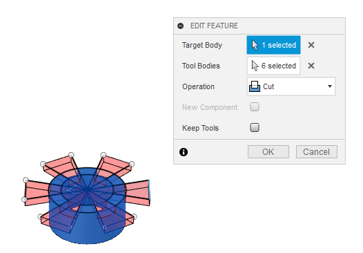

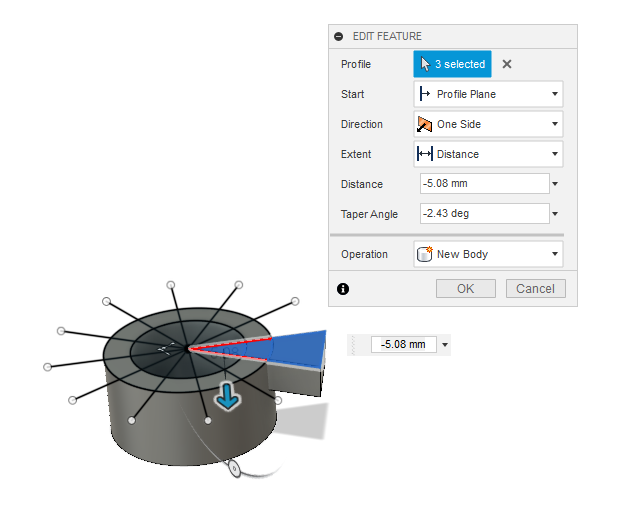

Next you take the segment you extruded down with a taper and create another rotary pattern of 6...

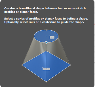

The teeth on the original don't look tapered to me but if they are, I'd draw the profile at the base of a tooth, create a plane offset the height of the tooth from that surface and draw the profile at the top, then "Loft" a surface between them.
Then use a circular pattern to create however many teeth there are.

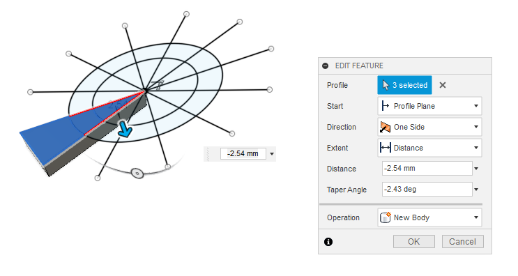

That method will taper the outer edge of the tooth too, and you have to manually calculate that taper angle.Select the segment and extrude it down and taper by the calculated taper angle (2.434 degrees) - and create a new body
Erm no it won't since it's used to cut the ring....calculating the angle takes 10secsThat method will taper the outer edge of the tooth too, and you have to manually calculate that taper angle.
Yes I didn't realise you were doing it that way when I started replying.Erm no it won't since it's used to cut the ring....calculating the angle takes 10secs

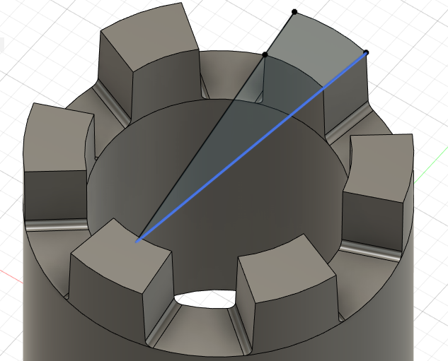

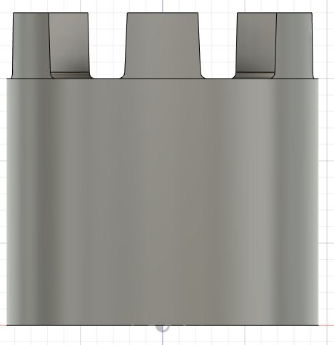

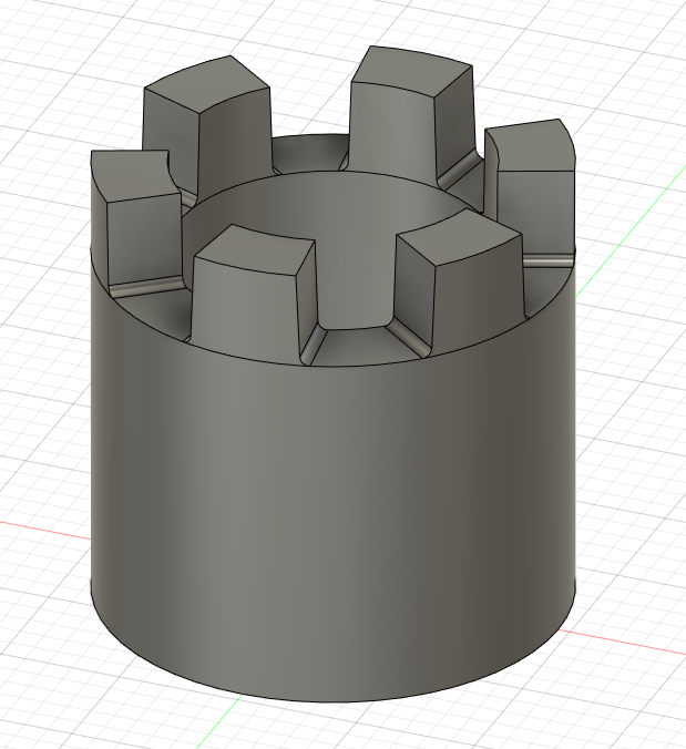

Here's what I got from the given dimensions;
View attachment 244924 View attachment 244926
And the timeline:
That's a sketch for the cylindrical body, extrude the length, sketch of the bottom tooth profile, offset construction plane, sketch for the top profile, loft between them, fillet either side and then a circular pattern to make the other five.
Also, everyone's drawing the sides of the centre of the cylinder but the measurements given don't actually fit that;
Though that does strike me as a weird profile, I wouldn't be surprised if the actual part does line up with the center and Dapph's measurements are off a touch, just thought it was worth pointing out. EDIT: Sort of restating what Sako said, but his message hadn't come through when I posted.
EDIT No.2; Didn't notice it was double ended either.![]()
Doesn't that make it symmetrical about the centre?so the black line in your drawing should be on the right edge of the bottom tooth & the blue line crosses over the black line soit goes to the left side of the bottom of the tooth . That should give the angle of the tooth
