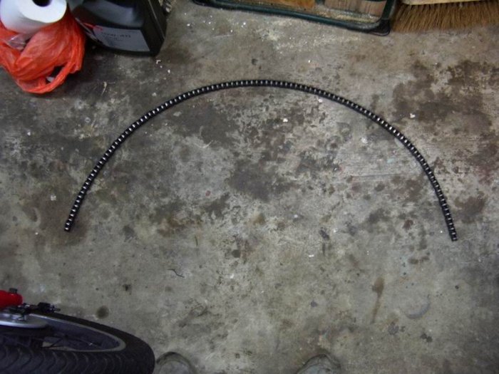

yes totally.Rule of thumb is less than 1/3. Doesn't work with O ring chains and is old hat. Best way is to measure pin to pin in different places along the chain as areas will stretch more or less than others for some reason.
