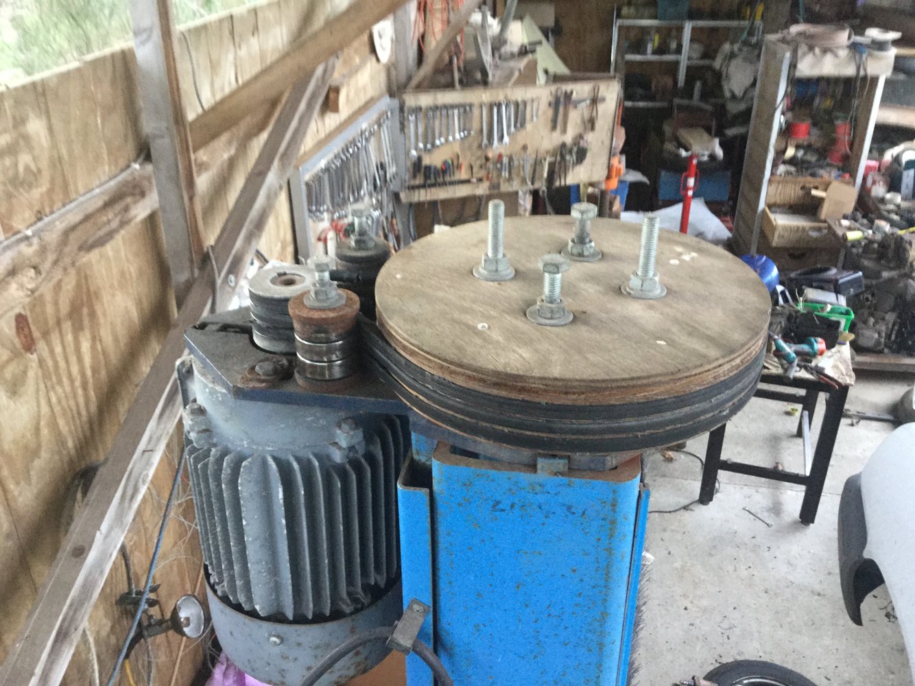

In my prev workshop I had 3 phase....read until the end....
BUT my 2 poster Hoffman car lift struggled lifting the heavy 4x4's and small tractors MF 135's etc.....my prob was not the power supply but the lift speed of the ramp.....
will inc photo of my mod.....with the gearing = 3 narrow belts the drive pulley on the motor was basically doing all the work on 1/3 of it's diameter.....
it used to eat belts.....asked Hoffman, now gone bump if they could supply a bigger pulley for the lifting screwed shaft.....that was a laugh....
so made my own as an experiment.....it worked just fine and is now 12 years old with no probs.....
the shaft pulley is around 25-30% bigger dia than the orig, slowing the lift speed down, hence less strain on the motor/electrics.....it's made from aheavily glued up plywood sandwich....thinking that if it works I'll make a new pulley from Nylon....not gonna bother now.....also u'll notice that the belts, NOW Kevlar are arranged so they rotate about an aditional pulley .....well a stack of bearings on a heavy bolt.....
this now makes the belt run nearly 50% of the drive pulley surface......the Kevlar belts * notched* will take this reverse bending easily .....
going from a set of replacement orig belts every 3-4 months, now 3-4 years....
So even if ur slightly underpowered changing the gearing will help a lot....
ps, now have a new belt guard and a better job of the bolt/ studding....it looks a bit Heath Robinson but it works.....
those are not Kevlar belts but originals....didnt want to spend any money until I was sure it all worked....
