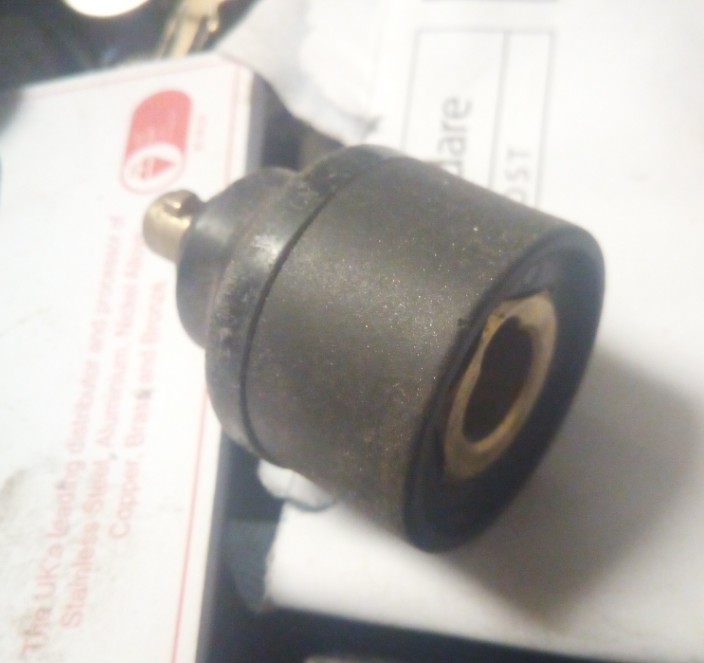

The GYS certainly do, I got some adaptors for mine so that I could use the leads I already have.

The lorch has proper size dinse connectors.
No, they are rock solid, very happy with them.Adapters sound like a great workaround, as long as they’re not all wibbly wobbly.
