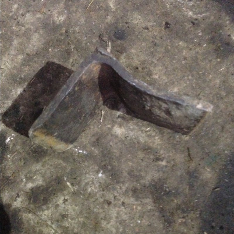

getting fedup of paying for punctures and -having to pay for getting tires off trailers ect to paint knocked this no frills or no spills one up in a couple of nights. I didn't realy have any measurments for one so drilled extra holes in the parts so its adjustable was bang on 1s time and works a treat with no effort to break beads just shotblasted -a -mini wheel and primed for painting it cost 12 quid to make from scrap available-

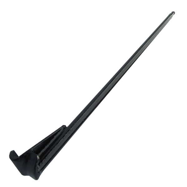

I might make the tire bar for removing and fitting the tires back on. I'm not buying one there 80 quid. ive seen the design -so should-be easy to-make

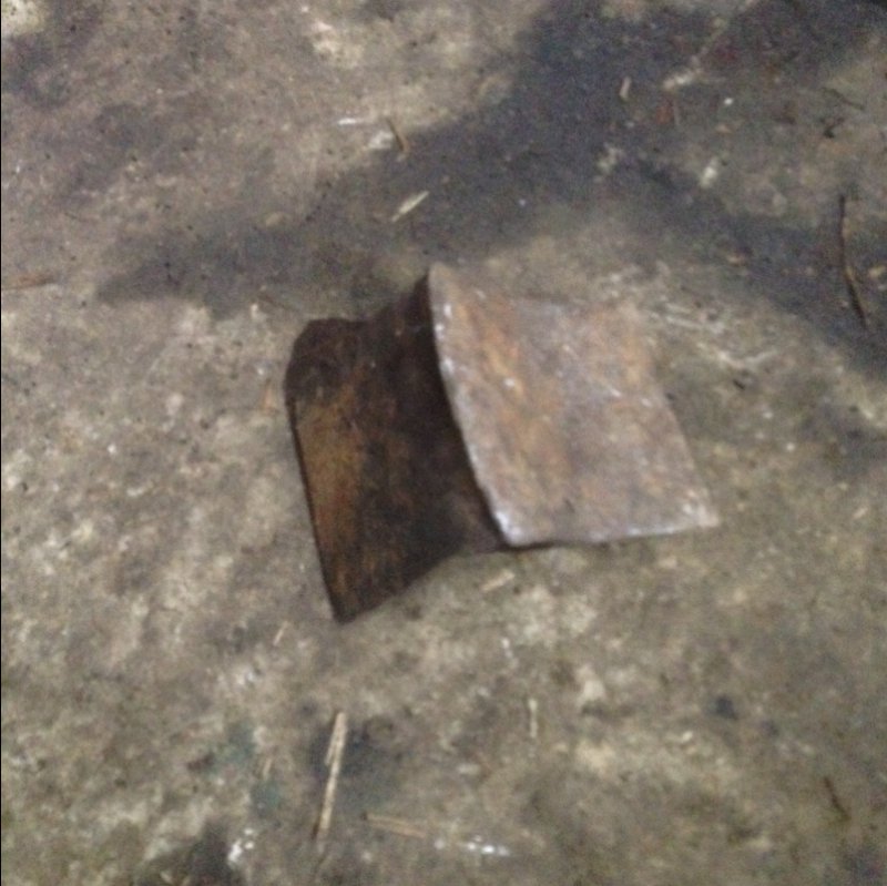

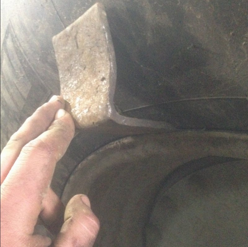

yep il fit a-wheel mount to the top of the bead breaker ive -madeThat's the type, 'normally' you'd whack a pole vertically, put the tyre bar under the edge of the tyre, then walk round in a circle pulling the tyre bar against the vertical fulcrum pole.
Doing it that way (and maybe with the assistance of a split hosepipe) it's fine to use on alu rims too.
A bit of angle also does a fantastic job of totally ruining the beadlock on alu rims, and once it's been used a bit and mushroomed nicely the big hammer slides off the side easier - why wait for a kerb when you can just use a hammer?
A maintained pressure is better for getting the tyre bead over a beadlock - because a tyre is rubber it always wants to spring back so takes a lot more percussive force compared to persuasive force.
Tube type rims, such as a lot of 'agricultural' wheels, where the bead isn't locked into place but relies on plain friction and maybe a bit of corrosion are fine to hit, but tubeless? Nah, I'll use a lever thanks.
I was actually changing a tyre on my tractor yesterday and tried the angle and a sledgehammer but couldn't get the bead to shift! I think it could have been my technique or I wasn't hitting it hard enough but I ended up making some wedges and driving them in between the rim and the bead, seemed to work pretty well but wouldn't want to try it if I was reusing tyres or on rims that mattered if they were marked!

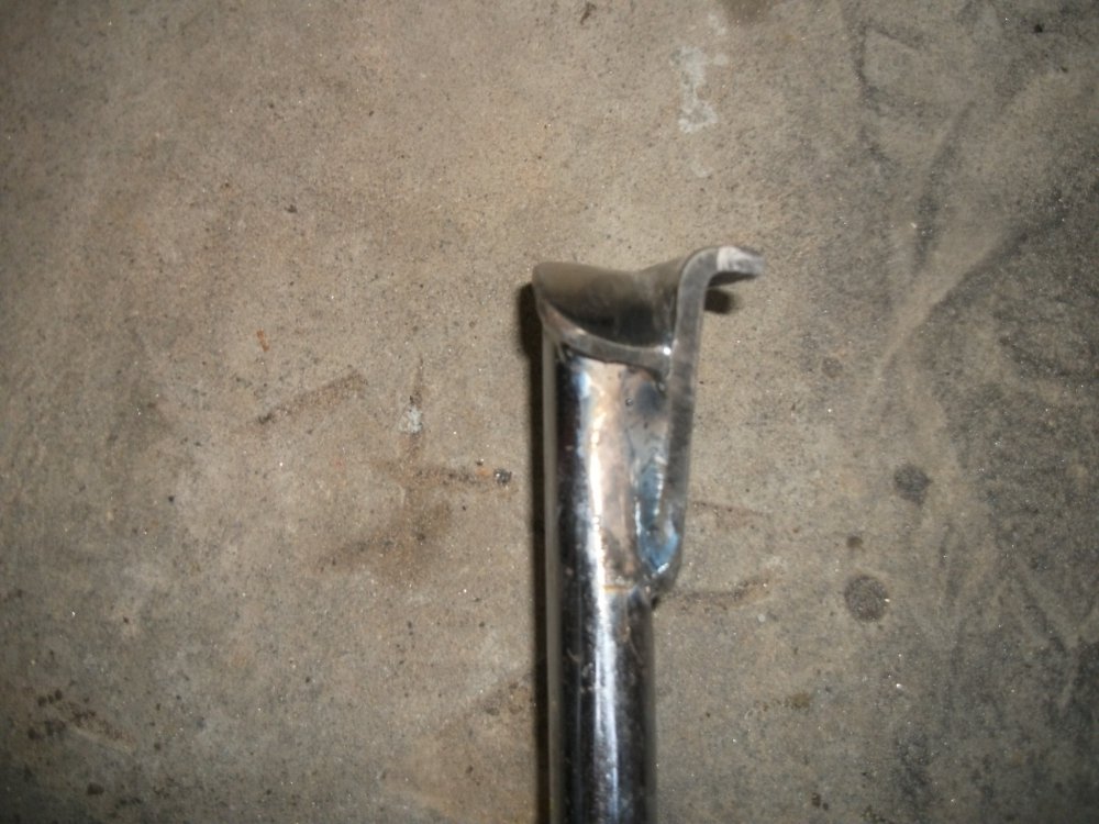

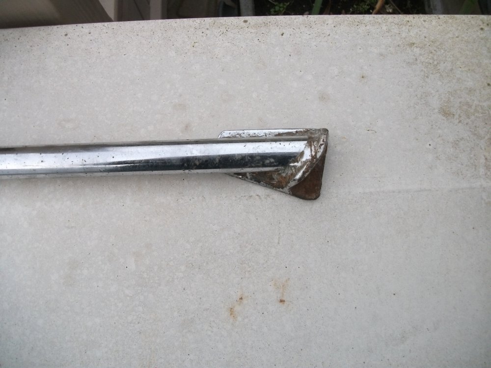

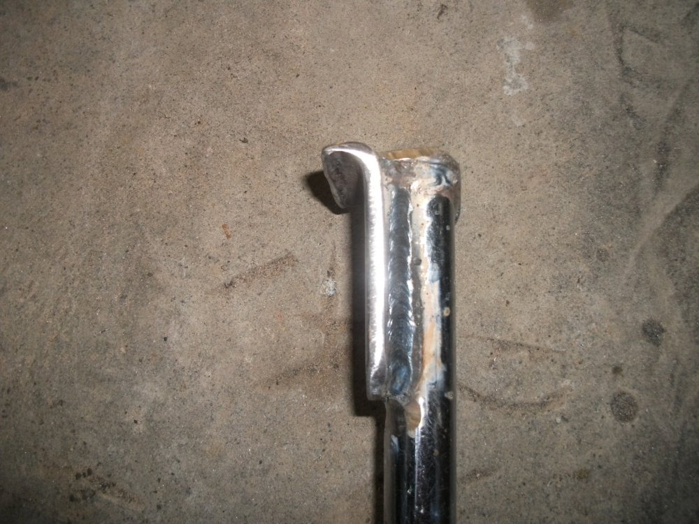

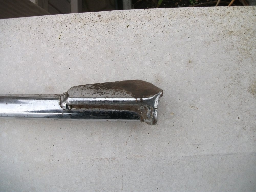

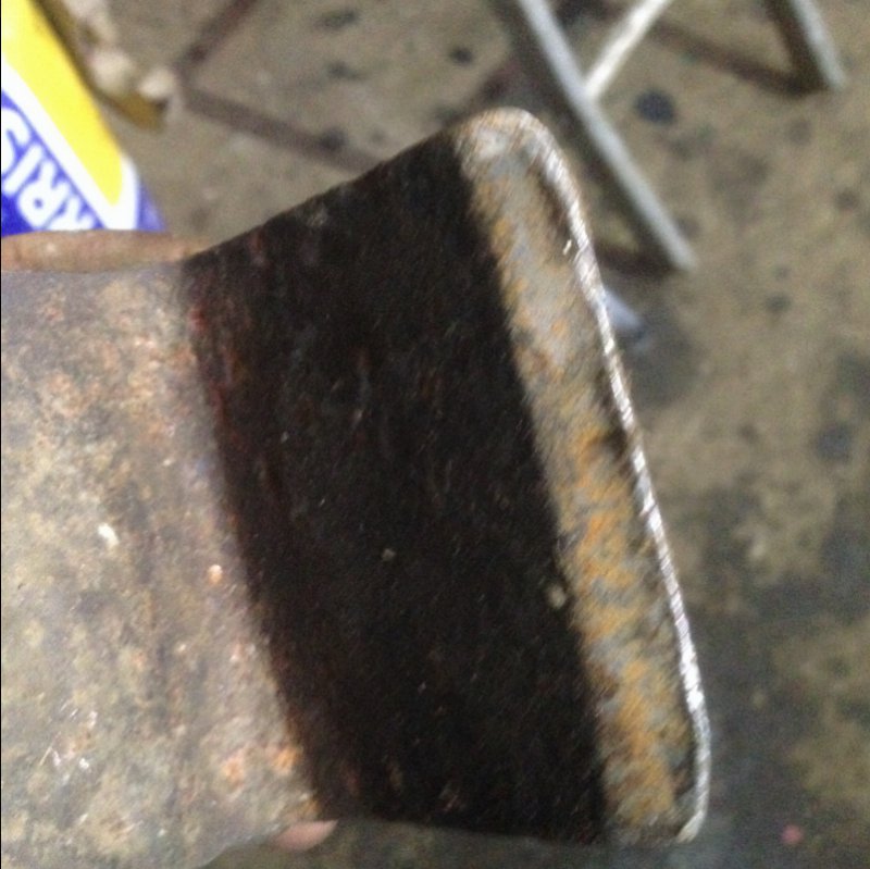

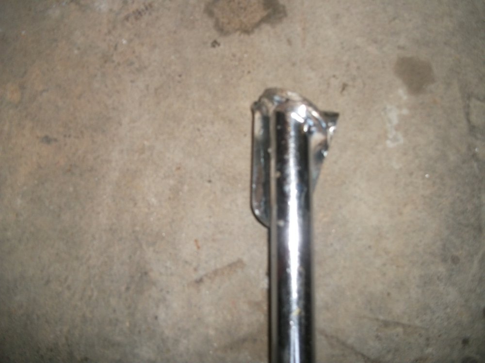

scored a worn tire bar for nothing of a mate he had 2a nice swop and gave him some tubes for his lights in shed in return. had to draw round the old end and make a new -one then heat up and curve the end round a half inch bolt even with oxy acet it took some bending .then I cut the worn part out with -1mm slitting disk in angle grinder and welded new bit in . as good as new now at no cost

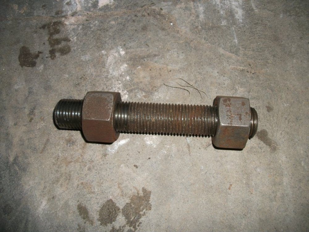

I scored a 1inch threaded rod with 2 nuts on from--autojumble for 2 quid to make the locking ring for holding the wheels on the bead breaker that jobs next

I've got tyres on the disco that seem to have particularly soft sidewalls and the beads on the alu rims are, well, enthusuastic...
They defeated one tyre fitting place completely (gave up and said they couldn't do it) and a neighbour (who used to do agri fitting) tried with 'the good old lump of angle. After walking 15 feet to retrieve the bit of angle for the nth time after it bounced out, he gave up too.
I got the beads broken by using the machine in the fitting place I used to work, but they were the most awkward I've ever been presented with.
If anyone who reckons a bit of angle is foolproof and will never damage anything fancies a go, pm me and I'll let you have my address - I know which wheels I'd like as replacements when you fubar them
