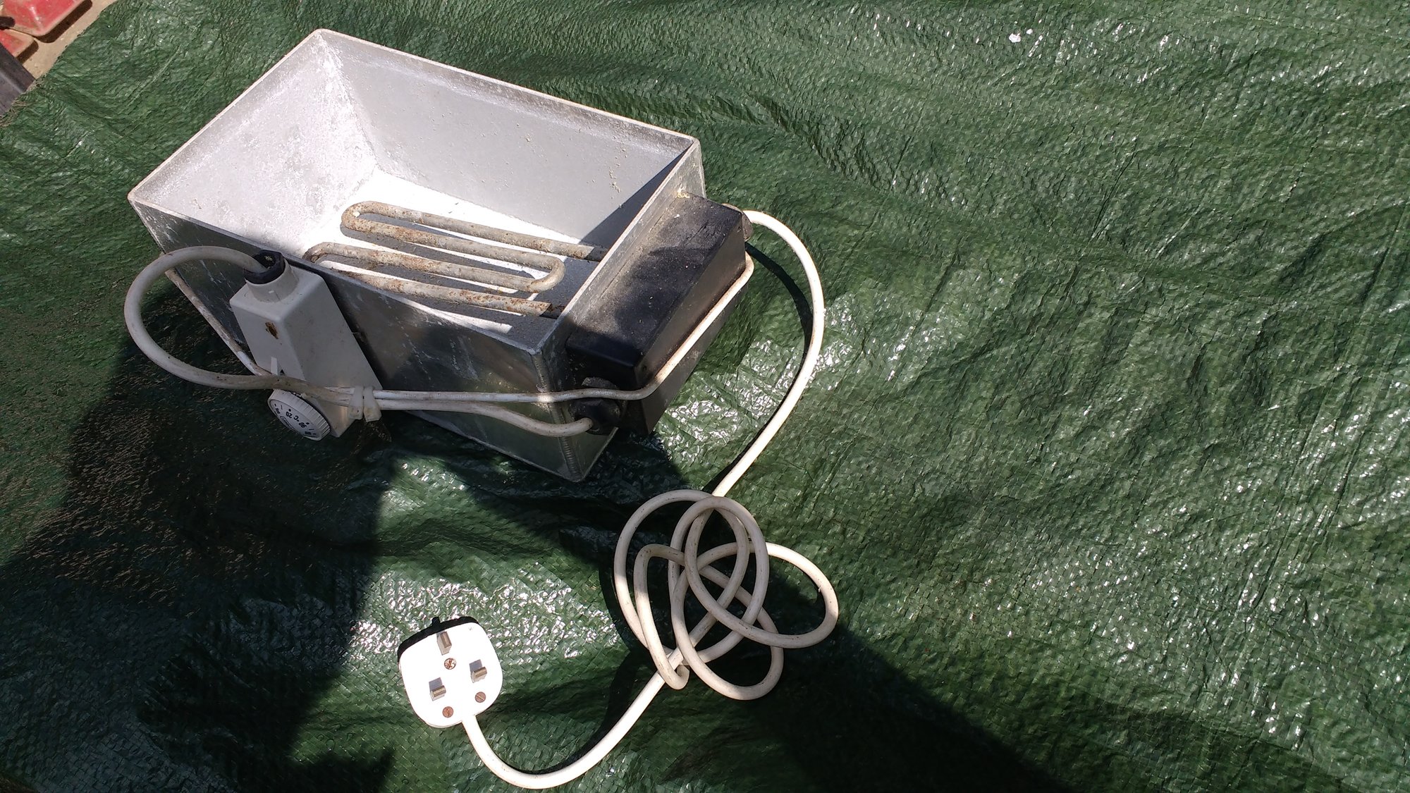

Dug out an old hot tank I made for PCB plating about 30 years ago. Random element and a cylinder stat in the side holds it all at a steady 70degC:

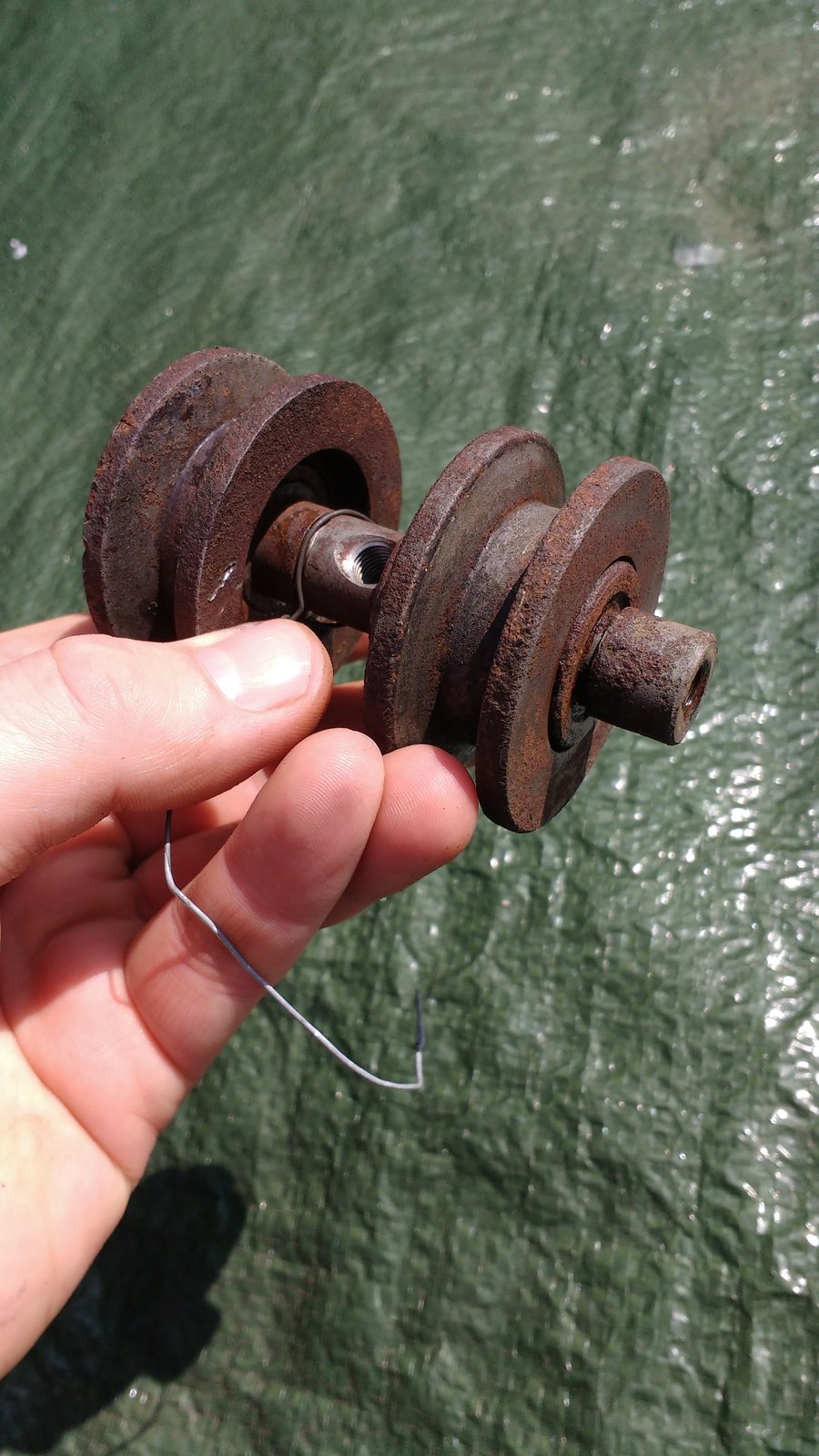

Main use today was to free up a seized bearing and derust a pulley assembly on the grass box of my ride on mower.

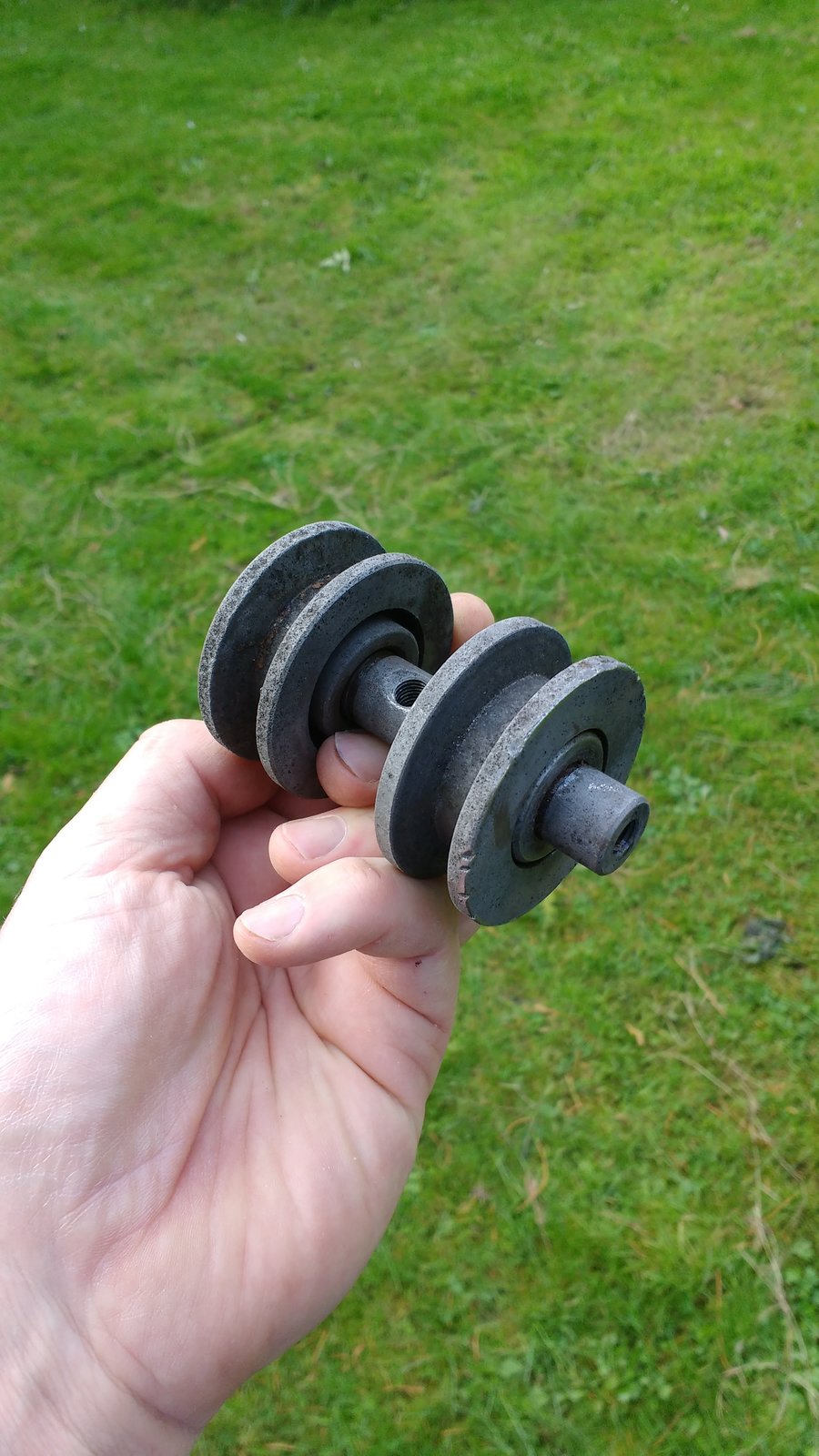

Works a treat, 5.5hrs in it's hot bath & nearly clean enough for masking and priming. Seized pulley lovely and free:
