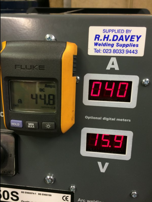

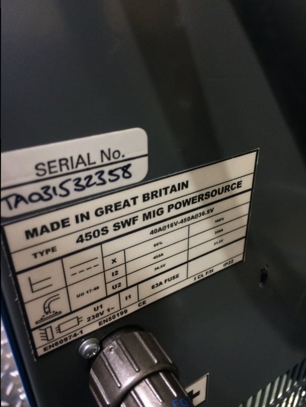

As I had to fit some meters to a new Tech Arc that we sold today, I thought I'd take a few pics and show anyone interested what's involved. (This is my setup, others vary and there are many valid ways to do the same job).
Here's the machine in question, interconnection cable is straightened out and is in circuit so the results are as accurate as possible. The yellow box on the left is my load bank, this consists of a bank of resistors that I can switch in or out with the big black levers on the front.

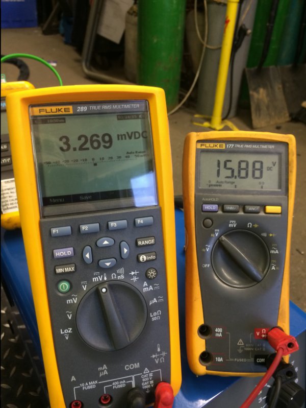

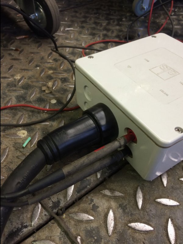

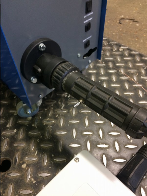

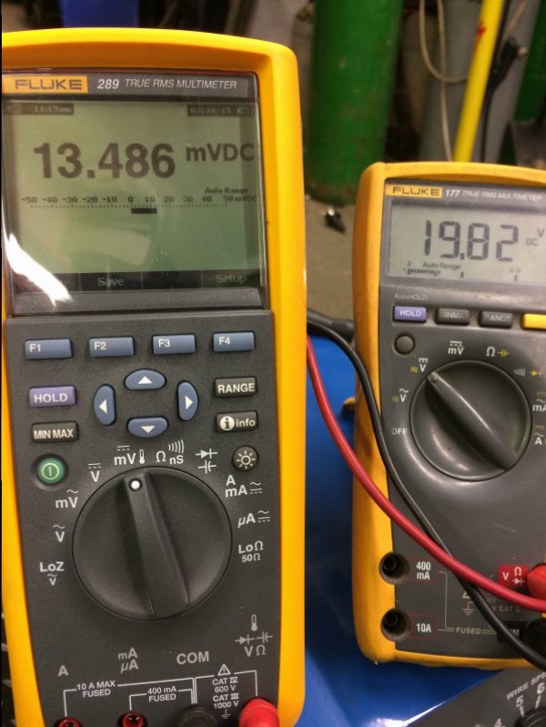

Above is my Dinze to welding cable adaptor, this has a toggle switch connected to the trigger pins allowing me to stop and start the welder as needed. The white box contains a 600 amp 60mV shunt for super accurate reading of current. It has a couple of banana plug sockets on it for quick connection to my multimeter.

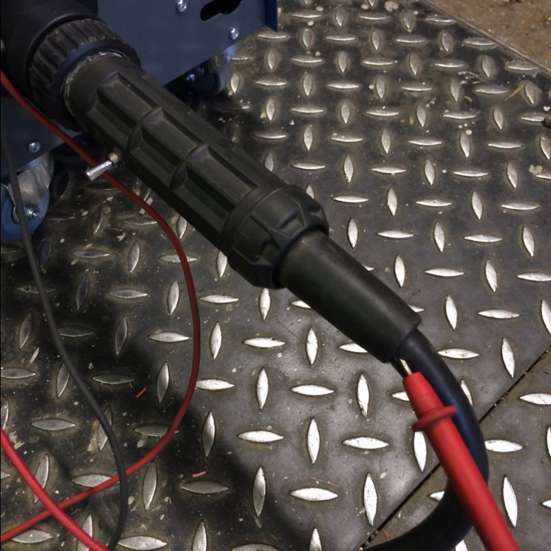

I use two multimeters, one measures volts DC and I connect it by pushing the probes through the insulation in my cables directly into the copper. Positive to the euro socket adaptor. Negative to the cable going to the earth return socket, this machine has two, either will do.
