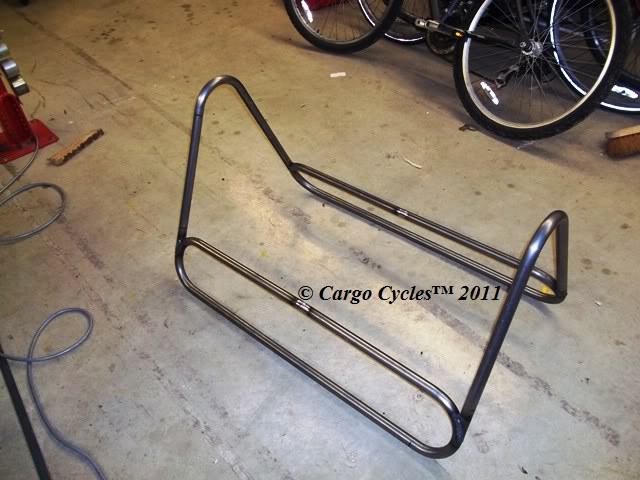

Here is a photo of the base fabrication for the Camel saddle frames I make for export. All the bends in this photo are 3" CLR X 1" O/D X 12 g wall thickness ERW.
