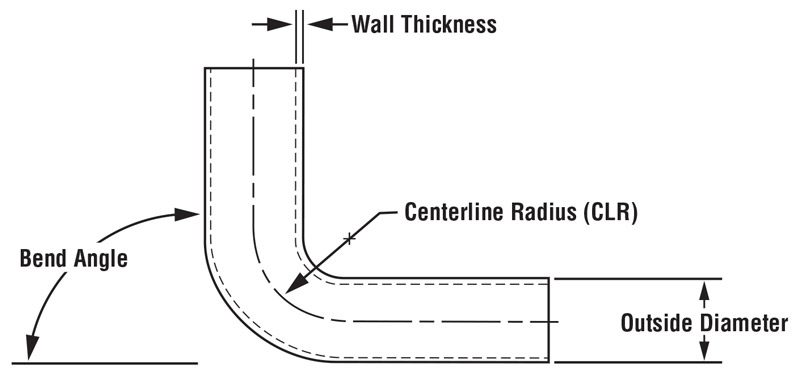

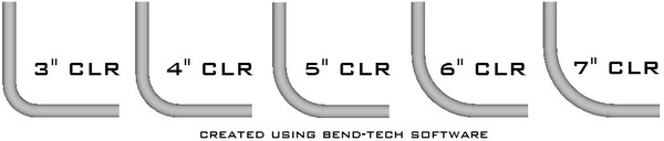

Looking at that photo of the die and by my reckoning I make it to be a Centre Line Radius of 4".

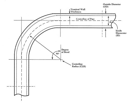

Looking at the photo of the bent material, that is an awful lot of waisting in the bend, and again by my reckoning you are looking at a good 15% and maybe even 20% reduction in the tube's diametre.
the jd2 m3 look a fine bender.Not with the JD2, the waisting on the bend of 16 gauge is around 1% of tube diameter.... but that is why good quality dies & followers are not cheap.

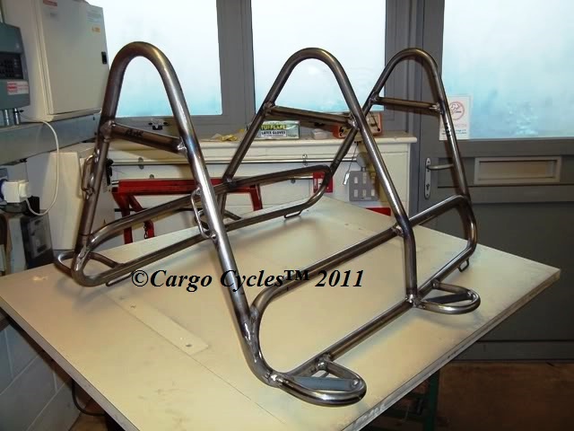

Yes, Camel Saddles, I make the steel frames for Camel saddles, both Bactrian and Dromedary Camels. I also make the steel frames for Mule & Pony pack frames, Llama pack frames and Elephant howdahs.
I export the Dromedary Camel saddle frames to Western Sahara, across most of North Africa and the Levant, the Middle East and Australia, the Dromedary Camels saddle frames go to Mongolia, China, Siberia and Northern India. The Mule Pack frames go to Canada, USA, South Africa, Namibia and Zimbabwe (via SA). The Llama pack frames go to South America the USA and across the UK. The Elephant Howdah frames go to India, Vietnam, Thailand, Laos and Cambodia.
A finished two person seater or one person and packs Dromedary Camel saddle frame ready to go to the powder coaters prior to going to the leather workers for finishing.
